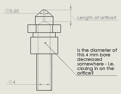

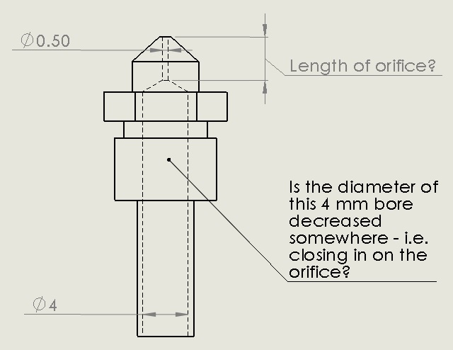

I took a deep breath and removed the nozzle, which turned out to be no problem. So I measured everything I could and modeled it. However, there are a few measurement that I couldn't do inside the nozzle, because it was filled with plastic. I have attached a drawing with two questions for you guys. Hopefully you can help me out to finalize the drawing. I will post the drawing and model, when I have all dimensions in place.
Thanks in advance! :)

The best way to answer your question is to heat the nozzle while holding it with pliers and remove the plastic from the nozzle.
Reheat the nozzle as above and insert a short piece of filament into the nozzle until a small amount of plastic comes out of the orifice.
Place the whole thing in the freezer for an hour or so then remove it from the freezer and carefully cut off the plastic sticking out from the
orifice then pull the filament from the nozzle. You now have a piece of filament that you can use to measure the bore length or other
measurements you may need.

The length of the 4 mm bore is 6.4 mm. The length of the orifice is 1 mm. the diameter of the bore connecting the two is 2 mm.

Not that I'm aware of,,, Hansen has the closest thing to a drawing I've seen. I just filled in the blanks with a cheap pair of digital calipers and a drill bit.
Oh, and the threads are 3/8-24.

I have rounded some measurements, because I think the nozzle was designed mostly with imperial units, and I live in a metric world ;) Hopefully, I can have a go at turning a nozzle with the indicated dimensions tomorrow after work.
Please, comment on the drawing, if you feel that "something is wrong". I would love to get this "perfect".

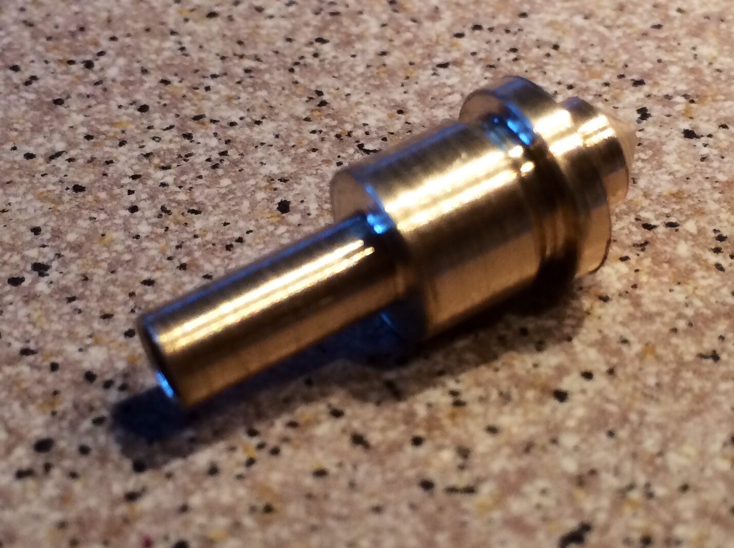

Well... here it is... sort of...
I still need to do the thread, the orifice, and the hex nut, which I'll probably mill as a square nut. Also, it turns out that 3/8 dies are rare here, so I'll have to wait for the one I ordered on EBay :cry:
