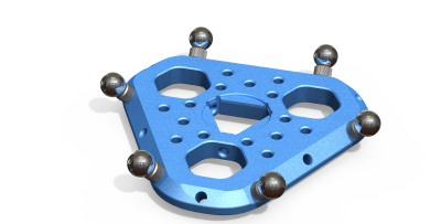

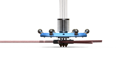

Anyway, it will be a full kit, both pre-assembled and DIY maker versions will be available. Everything but the effector plate will be included (3 heaters, 3 thermistors, 3 PTFE tubes, 1 fan, 1 fan mount, ect). I hope to add the effector plate as a separate pre-printed piece for retail as well, but of course any STLs will be free to download. I want to get a bunch of different mounting options available, some listed below;
1) Magnetic arm effector plate
2) Rostock Max effector plate adapter
3) Kossel effector plate adapter
4) your custom mount here
I already have a nice effector plate for the magnetic arm system designed and tested. The mounting is not a standard groove mount, since there isn't enough room to fit three bowden tubes into that small diameter circle. The nice thing about my custom triangle mount is that it is rock solid as far as rigidity goes, there is no wobbling, no angular tilting, no vertical or horizontal movement whatsoever. It press fits into place with two locking brackets that can be fitted in the hotends main groove to hold it down. The brackets are unessesary, but they might be useful if someone prints their own effector plate and it turns out to be oversized and a loose press fit. Instead of typing a paragraph to describe it, next time I'll remember than I have renders of it on my desktop....derp
I'll make a printable adapter for the stock SeeMeCNC melamine plate tonight. I forgot to mention that this thing is pretty tiny, and yes, it does sit above the plate to conserve Z height. My current version is 1.75mm only for now, but I will make a modular version that accepts any filament between 1 and 4 mm diameter, not just 1.75 or 3mm.
