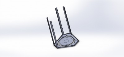

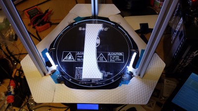

I have been looking around here and found a few good idea that got me thinking a bit. I am needing to completely enclose the build area and in the end the filament area also for printing in PC and Nylons. I have been doing some work in Solidworks and tonight I am printing out the beta pieces for fitting.. I have not finished putting the render together (it takes almost more time then designing the stuff in the first place) but below is a peek at the render and some pieces dry fitted for measurements.. I know not everyone wants a full enclosure of this style. But thought I would throw in my two cents worth.
For my needs I am also doing a complete environmental control system with an Arduino, dehumidifier and heating and venting system. But I am making sure that aspect is modular so if not needed it can work with it an keep overall cost down.
printing out and fitting beta pieces. Still a WIP
The render is not yet finished. but you get the idea. Top section is pretty much a mirror of bottom.

That looks good. What are you using for the sides. I'm thinking about doing the same thing to space a plastic wrap away from the frame a little.
Re: Cat Shield and Thermal Chamber
Posted: Wed Aug 13, 2014 10:09 am
by travelphotog
going with Plexiglas sheets to seal it in. I should have another render tonight.
