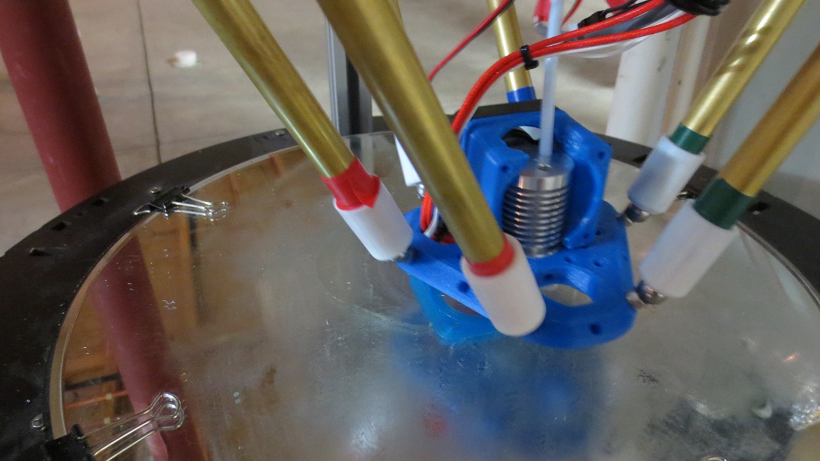

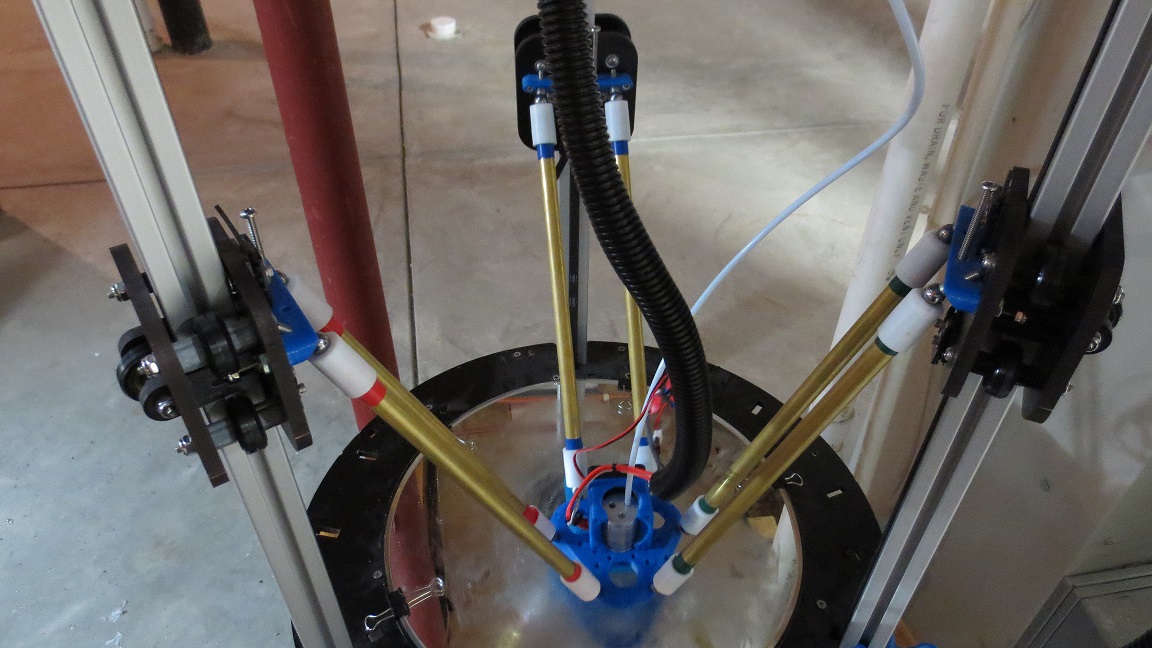

A few days ago I made yet another upgrade to my magnetic arms. Shortened the tubes, turned some recycled PTFE ball cups, press fit taped the cups onto the tubes, and now I'm getting the smoothest prints I've ever seen on a 3d printer.
Here are a few pictures of the setup;
The PTFE cups have a 60 degree mating surface for the 3/8ths chrome steel ball bearings. The balls are loctite'd into hex cap screws, which are threaded into untapped printed nylon parts. The cheapskate mounts are over a year old now, but the effector is new. The brass tubes are 7/16th inches (0.44) in diameter, thin wall, light weight and very rigid. The lack of friction on these ball cups is unbelievably low. I'm happy with them for now. 8-)
My main concern is if the cups will stay press fitted tight enough to avoid drifting over time. Right now the arms are equal in length to within 0.05mm, but if they drift it will cause problems in the future. Still better than what I had before!
I was testing single extrusion on my Tri hotend. The printed nylon effector plate can take a lot of heat, but the 4mm fan keeps the heat sink room temperature. It might be cool enough to test with a PLA plate.

Did you machine your PTFE Ball Cups or is there an outside source that you used?
I would be VERY interested in purchasing a set of the cups, when you are not so busy, this would make a great kit for you to sell.

I machined the ball cups out of recycled PTFE 0.625 round rod. It needs a center drill for the mating surface and a regular twist drill for the tube to fit into. Easy to do on a lathe, and it doesn't need any tolerances since the lengths are set after the cups are on the tubes.
I'll make this design better in the future, but I think this is the most precise method of delta arm positioning in the world right now! No slop whatsoever!

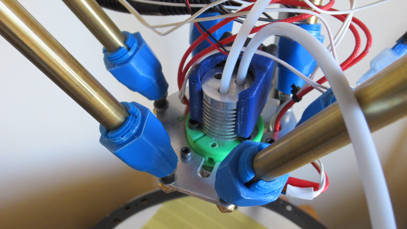

Here are a few pictures of the latest arms. They're 316 stainless steel tubes, 1/2 inch in diameter. The bright stainless tubes with collet ends looks awesome, more in real life than in the pictures on this post. The new ball cups are printed for now, although I have plans for high temperature ones that will need to be machined. Or if we get PEI filament soon......Both metal and/or plastic arms could work. I've been making a very big delta printer capable of working over ~150 degrees celsius with a full heated build chamber, which is where a lot of these new things are coming from.
I like these because they are concentric due to the collet design. Each collet slides onto the ends of the tube, then a printed nut-sleeve is threaded over the collet to lock it in place on the tube. The 3/8th magnet fits inside the collet and *almost touches the chrome ball bearing. I'll redo them in nylon for wear resistance; right now they're black ABS.
Overall this setup is a huge improvement over previous arms, although I'd prefer to use other materials for the collets. But these are dirt cheap right now; Stainless tubes are ultra stiff with low thermal expansion and they end up making a fairly inexpensive setup. I just like how precise and concentric these new arms are. They don't slip because the threads are tapered and the nut holds them on really tight.

I really like that design. Had you thought about adding O-rings into the nut and collect to provide a little extra grip? I would think that it would help also with the vibrations and possible loosening of the threads.

I don't think O-rings are needed for these since they have tapered threads. The angle is 1.5 degrees, so it gets to be a really tight friction fit once they're threaded on all of the way.
Vibrations aren't a problem but thermal is expansion is. For most printers, like the one they're on now, thermal expansion doesn't happen because the printer is open-air and only the printed parts and bed get hot. But these arms need to work on a big delta printer I'm making that has the entire build volume heated up to 150 degrees C. So only a few plastics will work for the arms, right now I'm leaning towards Ultem PEI. I might make metal cups since thermal expansion won't make them get loose (the arms are stainless steel).
I want a system that lasts indefinitely, has ultra low friction, length tolerances of +-0.03 millimeters, and is extremely rigid. I considered putting silicone rings in the collet where it contacts the rod because silicone has the highest temperature range of grippy stuff the arms would benefit from. Plus there is the small amount of damping you talked about; high frequencies should be absorbed but low frequencies should be passed.

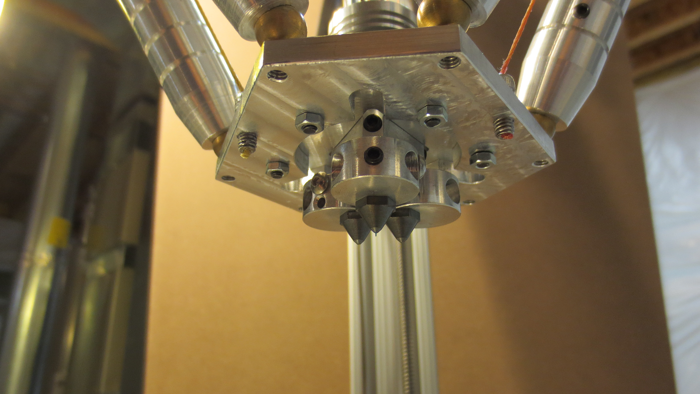

I'm actually getting away from magnets for arms. They pop off too easily, which is one of the main causes of print failures for me. If you had a reliable system that you didn't mess with, they would probably be fine, but I modify my printer so much that it causes problems. I've been doing a lot of PLA at high temperatures (240+), which makes almost perfect prints, but overhangs curl up on the edges without support. When it cools, the nozzles collide with it. If it's big enough the magnets disconnect and the print is ruined.
The new arm system is identical, except that rather than having magnets in the cups, I tension the linear carriages to the effector plate with aramid strings preloaded with steel springs. The aramid is put through a vented cap screw, then knotted and (optionally) glued. Magnets have a constant holding force that decreases with the cube of the distance. Once they get disconnected, they don't reconnect. The force is about a pound per magnet arm, I'm guestimating.
The springs/strings have a constant holding force that increases with distance. So if they get pushed out of place, they reconnect most of the time. Plus you can adjust the preload, making the system more rigid.
Pictures are better. I'll probably make a video demo of how to create this new arm system, along with a comparison to the magnetic arm system. I still need to experiment with a few more things before I do, like nylon cap screws as mating surfaces.

Second picture is more recent of my big delta build setup. 0.5 inch CF tube arms and turned aluminum ball cups. Threaded brass balls screwed onto set screws, inserted into aluminum effector plate.
The yellow/red thing is the aramid cord, the springs are not in the picture. Notice how the aramid strings enter the socket head cap screws at a point exactly half way between the two brass ball centroids. This keeps the preload constant across the entire build surface, without torquing the effector. As you get a more and more rigid setup, you have to build to closer tolerances to make stuff work. I plan on eliminating the steel springs eventually.
