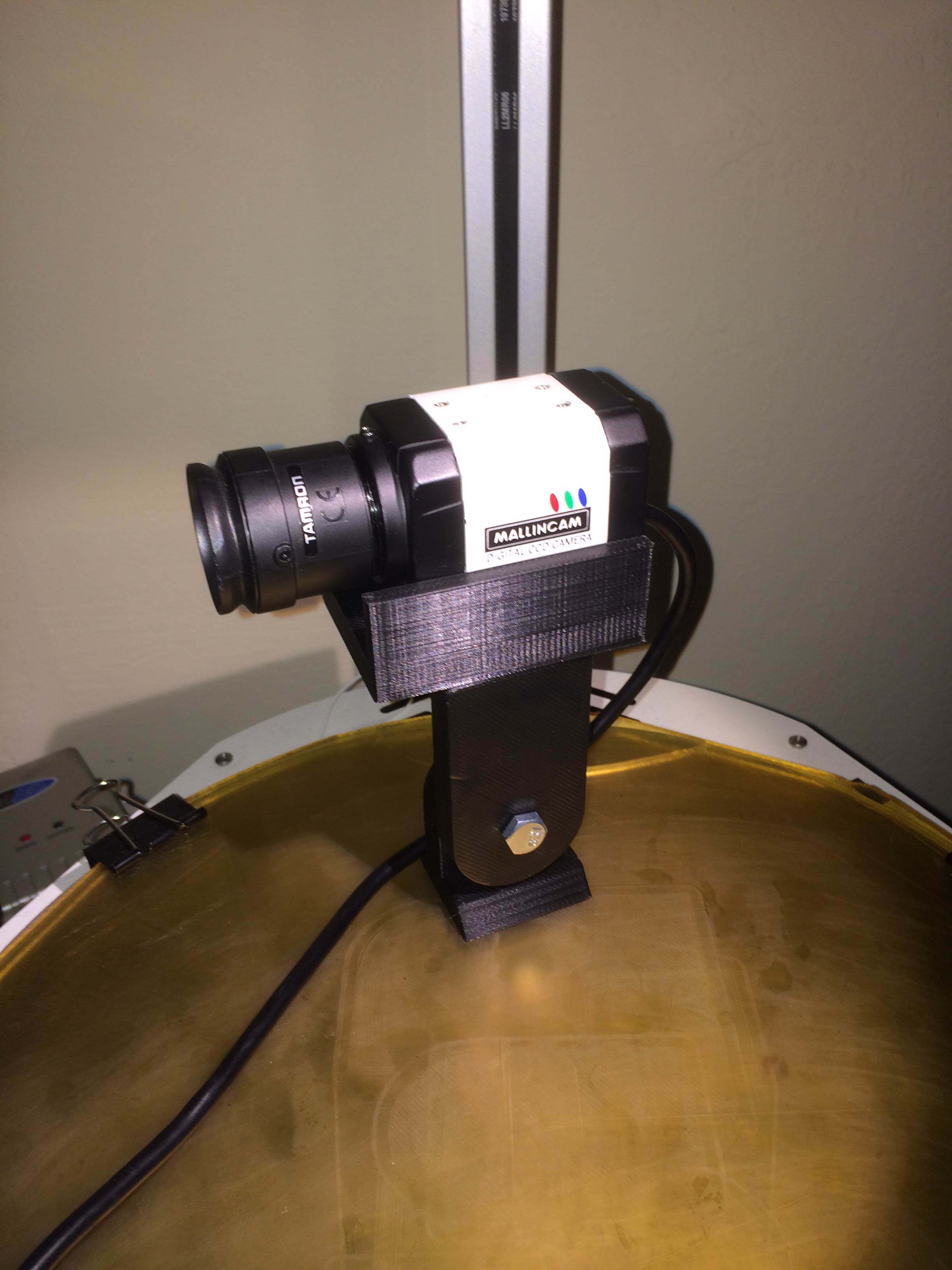

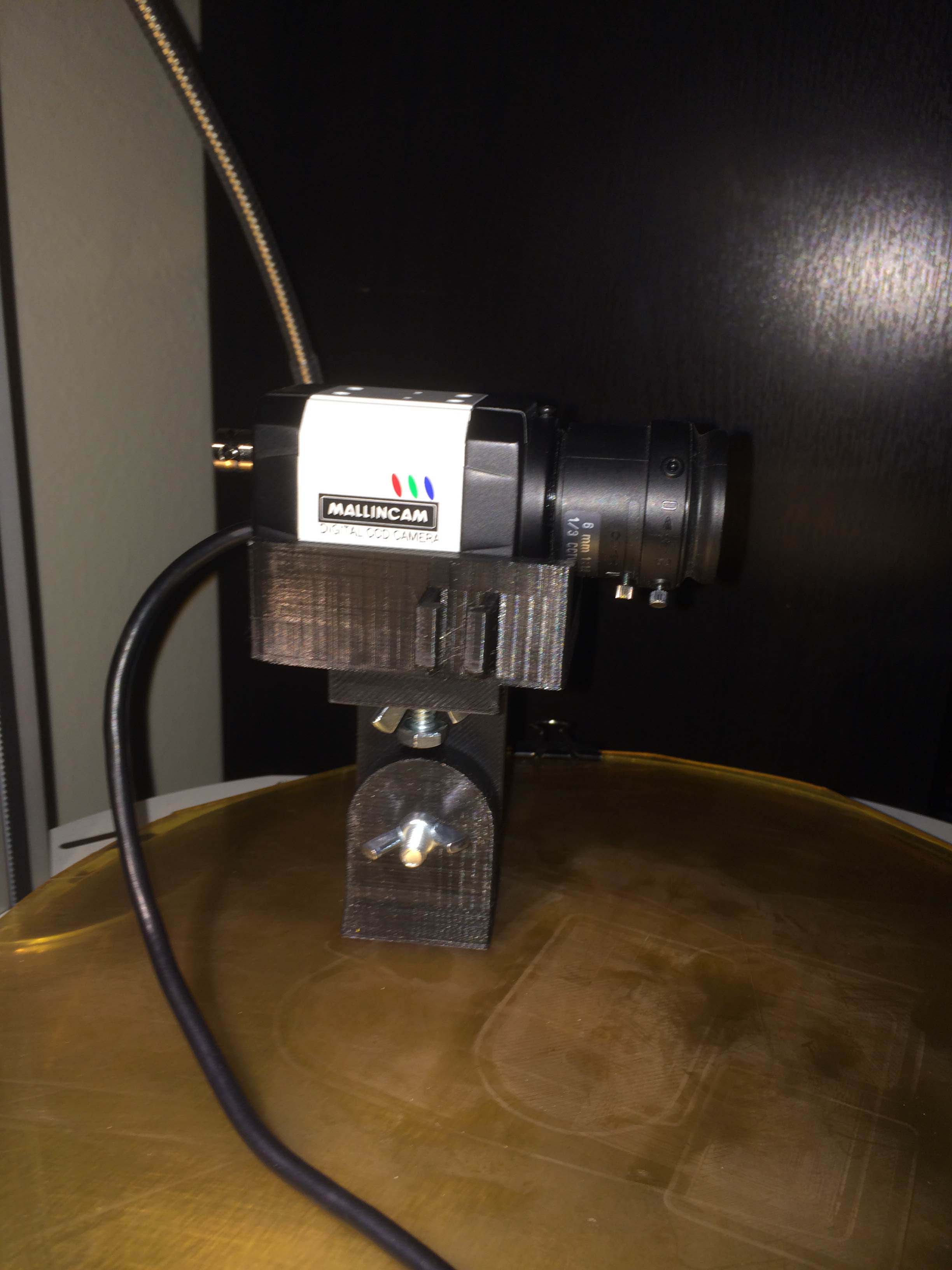

This is a finder mount for a Mallincam Micro-EX. I use it as a finder for my telescope that I am slowly converting to fully robotic operation. The idea is that I have a window open with the output of the video finder, with a crosshairs overlay, and I use it to point the main scope. The camera on the main scope then feeds the telescope image back to my computer.

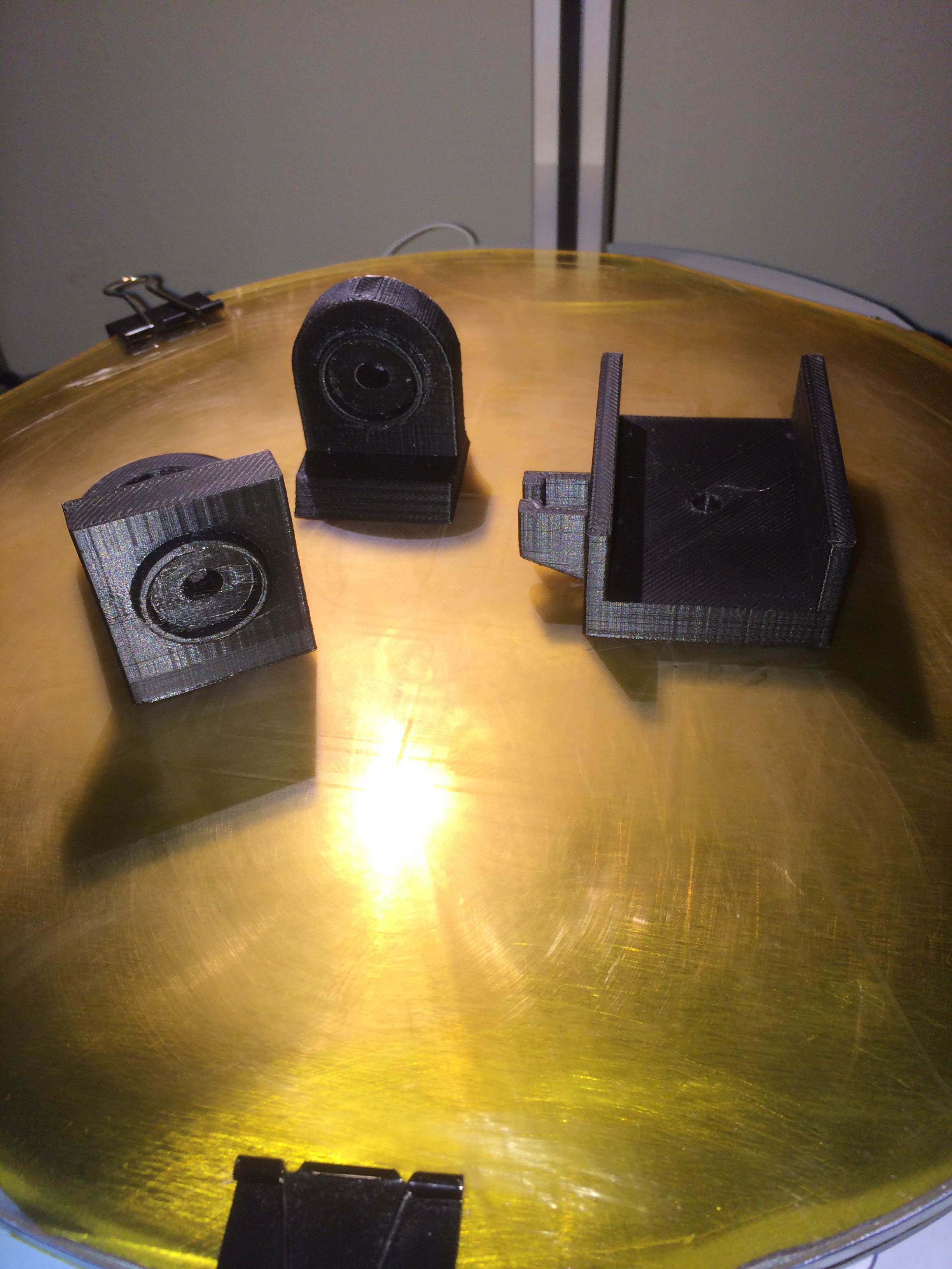

Visible in the image of the three individual pieces are the raised circular "guides" that help things stay more or less aligned in that axis while making adjustments. I don't think they are necessary, but getting them to fit into their respective female slots was a good exercise. The tabs on the side of the u-shaped piece are for cable strain relief. I run the cable in a loop twice through those tabs, then zip tie them in place to keep the cables from fraying where they enter the camera.
Printed in black PLA.
Thanks for looking, this is the first set of objects I designed from scratch, and I'm thrilled with the results. I've already mounted and aligned it on the scope, it works perfectly. Functionally it has changed the game with respect to pointing the telescope remotely. Now if only it hadn't clouded over...
Washers and lock nuts were added later. I just wanted to pose it for the camera.

Nice one: love seeing these beasts being out to practical work!

Nice design and finished product!
Great Job!
