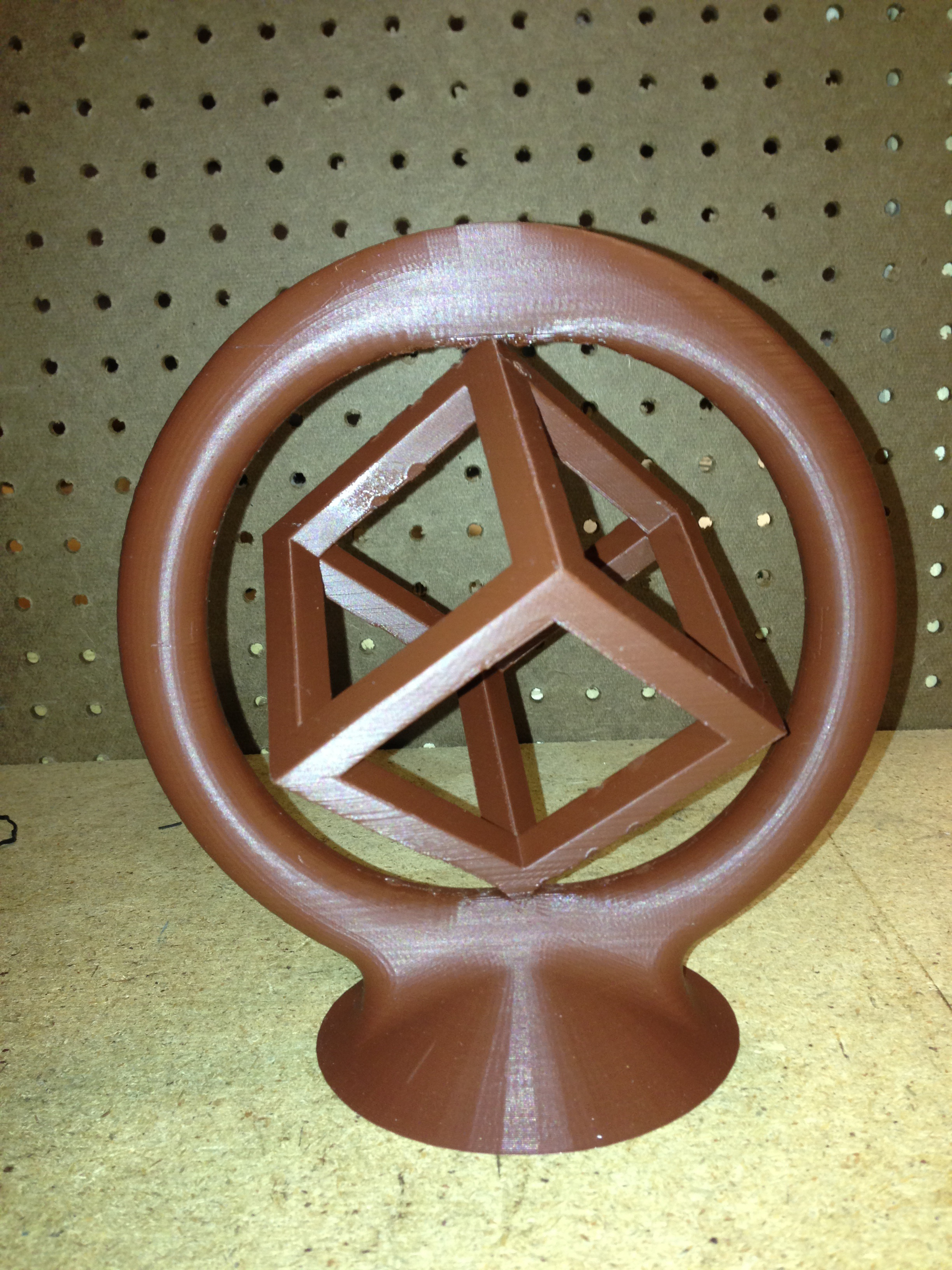

Made a new toy for my desk!
guanu
SeeMeCNC Staff
Posts: 392
Post by guanu »
Saw this model and had to print it, the inner cube spins freely and is fun to play with!
Printed with ABS (want to reprint it in another color still)
Printed on my acrylic orion
Slicing specs:
no support (was built into the model as you can see on the cube)
20% infill
Bed: 88c with uscented aqua net hairspray on glass, Hotend: 227c
outer perimeters: 25mm/sec all others 40mm/sec
200mm/sec travel moves
1mm lift on retract
5.4mm retract at 100mm/sec
.2mm layers with .35mm first layer
3 perimeters, 5 top/bottom solid layers
any other questions feel free to ask!
