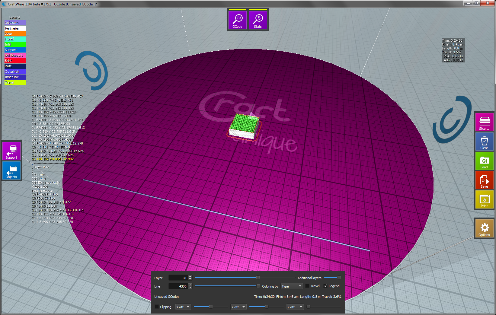

+1 for the easier than matterslice comment. You set the settings for your printer dimensions similar to RepetierHost, and then it's just a simple matter of tweaking the model with rotation, scale, and positioning controls, checking your nozzle settings, slicing your model and sending it to the printer, I do so by putting exported gcode on SD, but I'm sure importing the code into a host like RepetierHost wouldn't be an issue.
It has a "workflow" oriented workspace is the best way I can explain it.
First screen you select files and arrange them, then you can either choose to move to the custom support tab and let it auto-generate supports for you, or you can place them where you want. Once that's done, you click slice and it pulls up the, in my opinion, well-labeled slicing settings, that also makes it very convenient to make different profiles for different filaments.
After the slicing has finished, it allows you to inspect your gcode with a user-friendly, yet highly informational slicing interface which can even take you to a specific point within a layer in the gcode.
Highly comprehensive program and much work seems to have been done to make this a high-quality, free product.

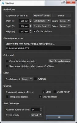

so i just tried the slicer (i like it so far) but when i went to print, it came down to the bed super slow, then sped off the plate. i had a finger on the on off switch.
is there somewhere we need to tell it what printer we have etc? i dont remember setting that up.

Bottom, right hand side, there is an "options" button. That is where you set up the printer shape and size.dunginhawk wrote:so i just tried the slicer (i like it so far) but when i went to print, it came down to the bed super slow, then sped off the plate. i had a finger on the on off switch.
i love the interface though.

Here's the options and slicing settings I'm currently using for 1.75mm PLA. Make sure to input the closest whole number to YOUR machine's Z height. There is an option in the slicing settings to offset the Z-height at a more precise level, so don't fret
