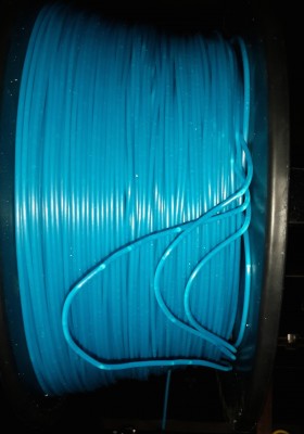

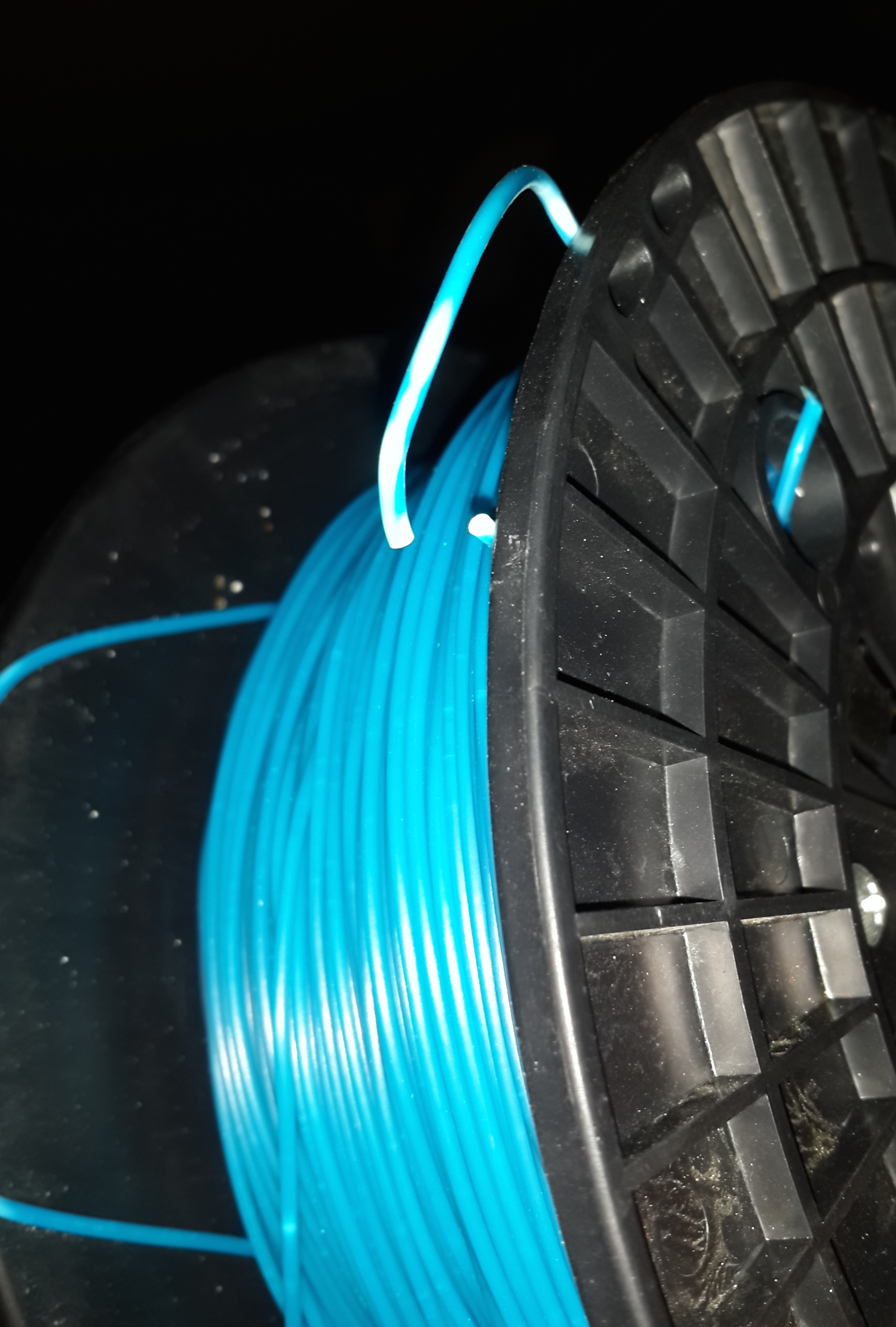

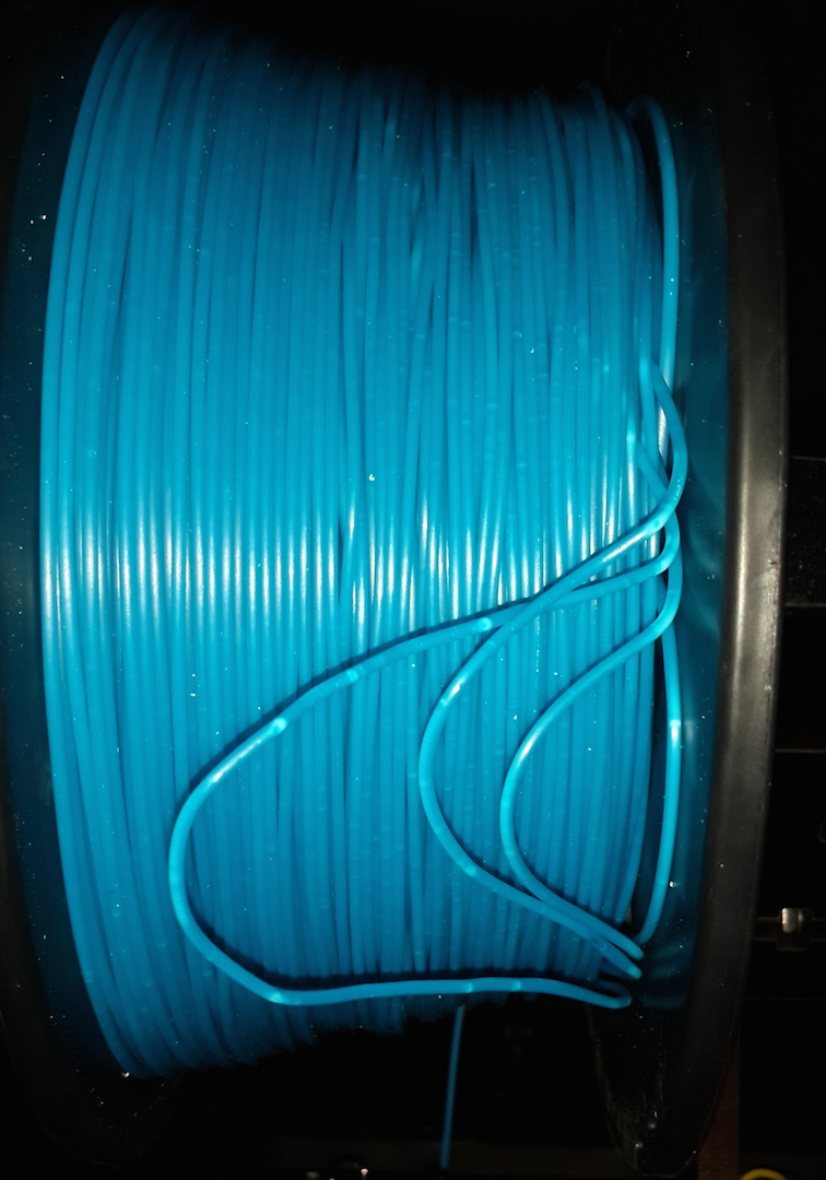

As my spool of filament started to unroll, i noticed that it was really crappy. No problems with the extrusion so far, just the way it was wrapped.
I purchased it from DX.
I do believe the pictures will speak for themselves.
I am at %95 of a 45 hour print. I do hope it doesnt block up before the end.
More loops
More loops

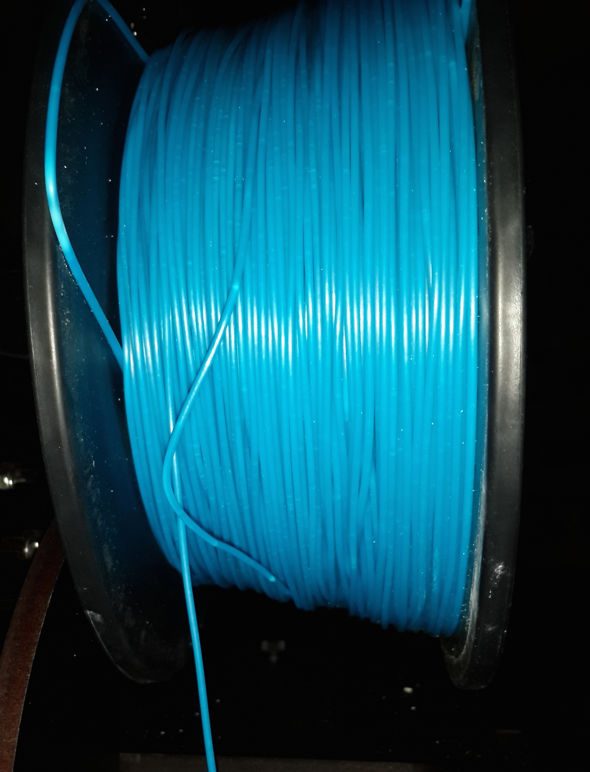

There are these loops sticking out, and they have white marks indicating that they have been bent hard.
I can see 3 ends. So the filament is broken somewhere.

It was bought from DX more than a year ago.
I am sensitive to bashing manufacturers on forums. However with sites such as DX you do not know where the origin is. I have ordered mutliple times the same item and on occasions i have recieved the same item manufactured by different manufacturers.
Not bashing anyone really as DX is not a manufacturer and some of the stuff that they sell tends to be of lower quality, but i will contact them.
My print did fail at %98. The filament stopped going through the extruder, i do not know why. Probably there was a thing spot or a kink somewhere and the EZstruder ground it thin and lost grip.
