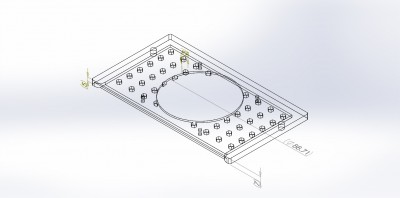

I had the same issue with stock PSU and fans. I replaced the stock PSU with a 750w unit from a good company and also changed out the 40mm RAMBO fan for a much better and silent fan. I also replaced my side panels with one that hold fans and now I pull air in one side and push it out the other. My bay is nice and chilly now.
Air enters or exits at the bottom from between the panels. Only 4 screws show on the outside.
