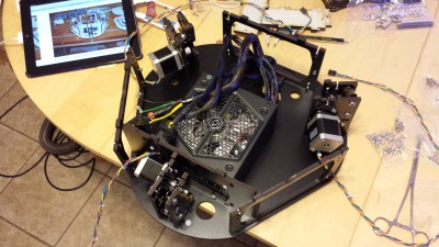

Other than the 6 12V +, 7 ground and one green wire, will I be needing any of the other wires? I plan on un-soldering the wires I don't need from the power supply board. And while I have it opened up, replace four of the 12v and four of the ground with single pieces of 8 gauge wire. I converted a power supply years back for a RC car battery charger and this was exactly what I did. Just want to make sure I wont have to take it all apart and re-solder in a wire I should of left alone. I have read through the manual a few times but just thought I would check to make sure.

No wires outside of those in the manual are needed to run the Max. The wires for the main ATX connector are the largest pain if left in place as they take up a good bit of room. I went the modular way instead and it helped clean up a huge amount of space overall in the lower bay.
Wish I had done like you and removed even more wires which I did not need. But it is far better than most.
Of course YMMV

I found a few reviews of the supplied power supply and all said it was decent and dependable power supply. I plan on building a 24 volt power supply out of a couple of server PSUs to power my heat bed here in the future, so I didn't see any real need to replace it. The wires are pretty easy to unsolder from the board plus I can increase the dia. of the wire instead of bundling 4 wires together. Thank you for confirming the wiring for me.
