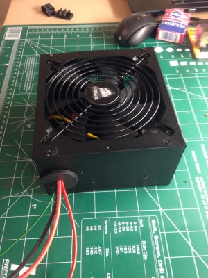

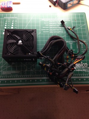

In anticipation of my Max kit arriving on Tuesday, I prepped my upgrade power supply by removing all the extra cabling. Wow, that's a lot of extra crap! I have 12AWG on the 12V rail and 16AWG for the 5V rail, The switch wire was left as is. I didn't bother bringing out the 3.3V. I verified output at 12.2 and 5.02V. I have a feeling I'm going to get carried away with mods (why do I always do that......?)

Pre-surgery
Pre-surgery
Post surgery
Post surgery

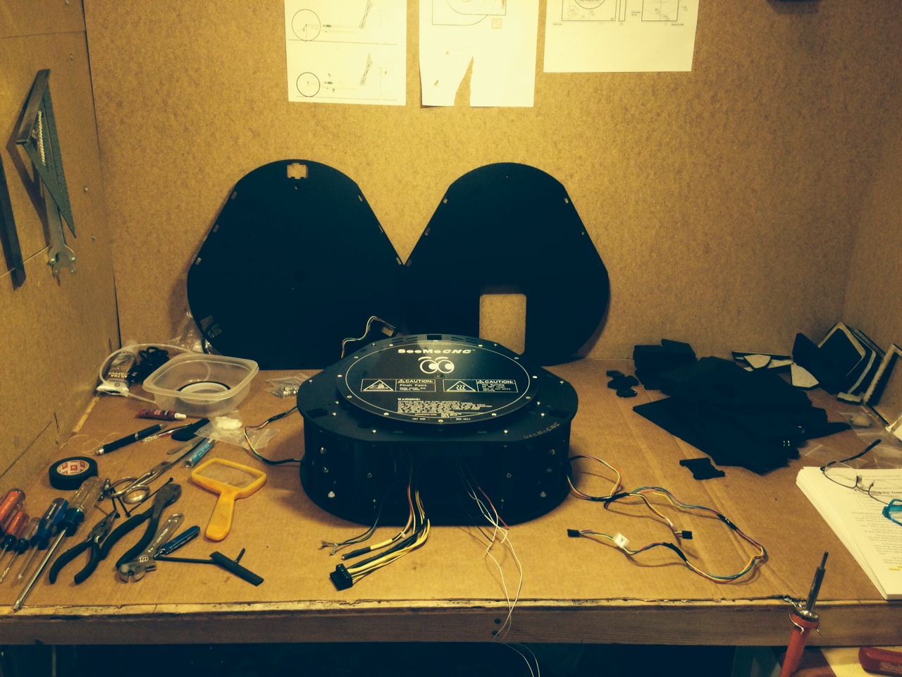

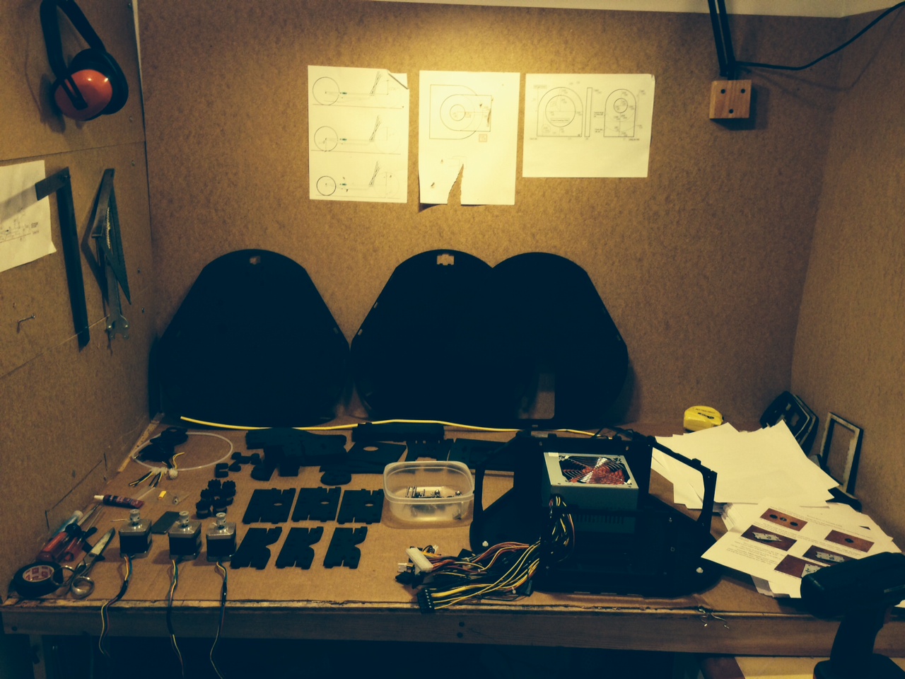

Glad I got rid of the wires, too. Looks much cleaner:
(not finished with the build yet...it's getting there)
