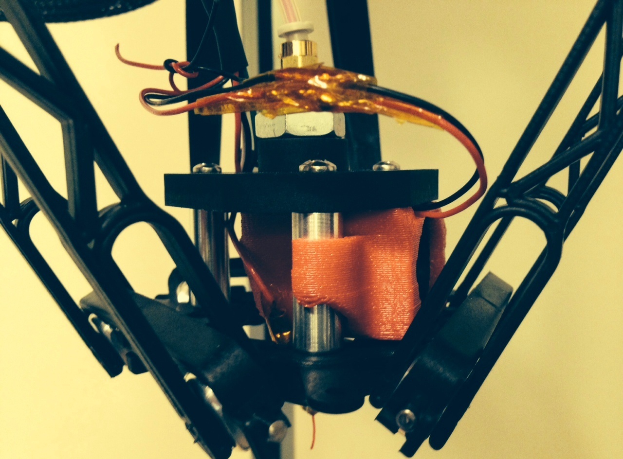

I know this is an old issue, but I cannot find the topic with the solution. After adding the PEEK fan, the hot end will not come up to ABS temperature. Gets as high as 220 C and that's it. If the PEEK fan holder was shaped more like the layer fan shroud, it would work better, instead of cooling the whole area as it does now.

Mike, you might want to put a wrap of Kapton tape on the hot end that will cover the aluminum barrel area between the PEEK / aluminum interface down to the top of the heater block. That should insulate the hot end enough to prevent the PEEK fan from knocking your temps down.

What geneb said is what did the trick.
