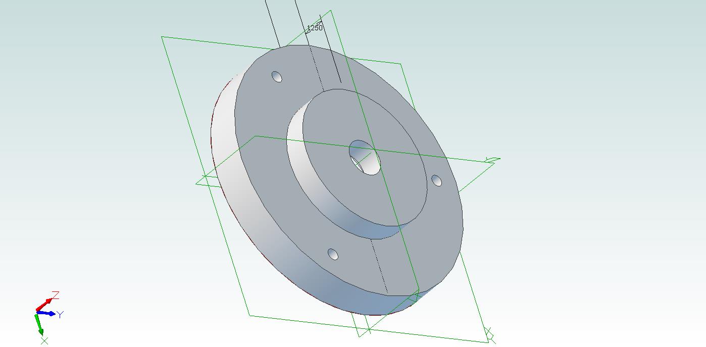

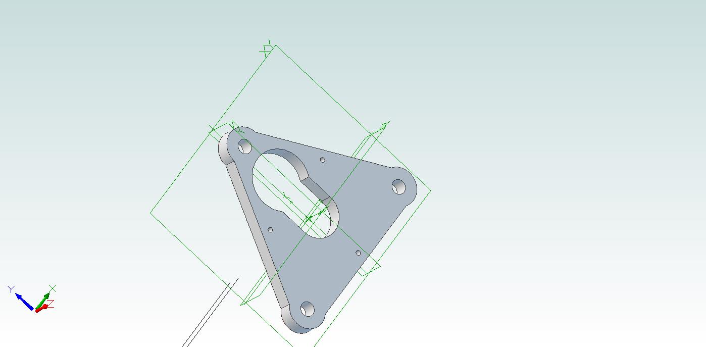

I just made a Jhead mount. Try it out and see if it works for you.[img]http://i1102.photobucket.com/albums/g446/davidflowers1/utf-8BSU1BRzA3OTMuanBn.jpg[/img]
- Jmount.stl
- (596.75 KiB) Downloaded 633 times

Maybe someone will find it helpful...
