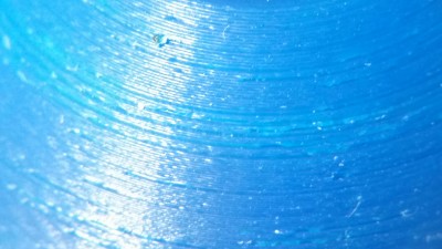

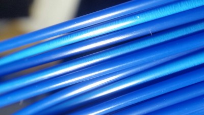

When I bought my Rostock Max V2 I ordered ABS filament in a variety of colors I would typically use for the parts I intend to make. I ended up getting a roll of navy blue filament from Sainsmart on Amazon as part of my order. I had a roll of black Sainsmart ABS in the past and it was good quality, so I was not hesitant to get the navy blue from them.
The first issue I had with the roll is that after printing about 1/8 of the roll, there was a spot on the roll where the previous windings on the roll crossed the later windings. I am not sure how the heck it could be wound like this, but the filament coming off the roll reached this point and snagged, which caused the filament to stop feeding and starved the print. I had to remove the roll from the printer and manually untangle the windings on the roll.
After that is worked fine.
Recently, I have been playing with different polishing methods (sanding, hand buffing, acetone vapor, etc.) and I noticed that on my navy blue prints that there are fluctuations in the color over layers that become obvious when polished. Think of it like a random gradient going from the bottom to top laters of the print. It ruins the look of my polished prints.
It got worse.
I printed a large item yesterday and when it was finished, I noticed that I could see filament starvation on certain layers and not others on the print. There would be a small band of starvation in the print in a few layers. I could also see that the starved areas did not have the same color as the rest of the layers. They starved layers were very light in color. Almost a "baby blue" color. It looks like the color the blue ABS takes when I stress it (Bending the filament to the breaking point causes the filament color to get very light)
My assumption was that maybe the roll had snagged again from winding errors so I began looking at the roll for problems and I noticed that there are fluctuations in the color of the filament along the length that are very noticeable on the roll now. I can see this where before it looked uniform.
I pulled off several meters of the discolored filament and the windings below looked uniform again, so I did another print last night, but this morning I see more of the light colored starved layers in the print.
Is it possible that there is something wrong with this filament OTHER than the pigment variations that is causing the starvation?
I will probably not be using Sainsmart any longer in any case.
The only thing good I have to star about it is the filament diameter is very consistent. But that's about the only thing I liked.

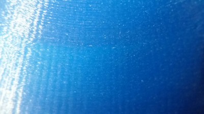

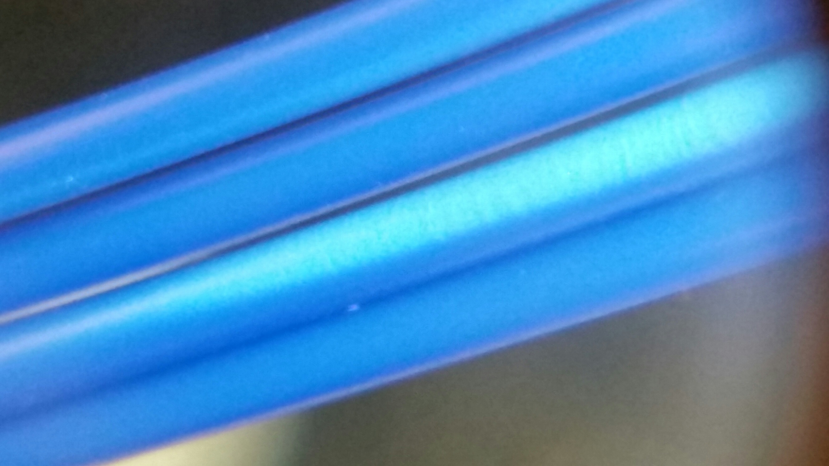

I swapped the blue ABS out for some Black ABS and the problems all went away, so it is definitely this filament and particularly this portion of this roll that is bad, because I had printed 2/3 of the blue roll nicely until this problem showed up.
Looking at some of my older prints, I can see the fluctuations in the color over many layers. I had thought it had something to do with variations in wall thickness or areas where it shrinks more when cooling, but I can definitely see in this one spot on the roll where the raw filament is visibly lighter in color than the rest.
I think something bad happened in the filament extruding process, like a few chunks of some other plastic got mixed in by mistake, and it makes the blue lighter and makes it hard to extrude, causing starvation.
I will try and get come images uploaded so you can see it.

Here's some samples of the Sainsmart Blue ABS I have been having issues with:
