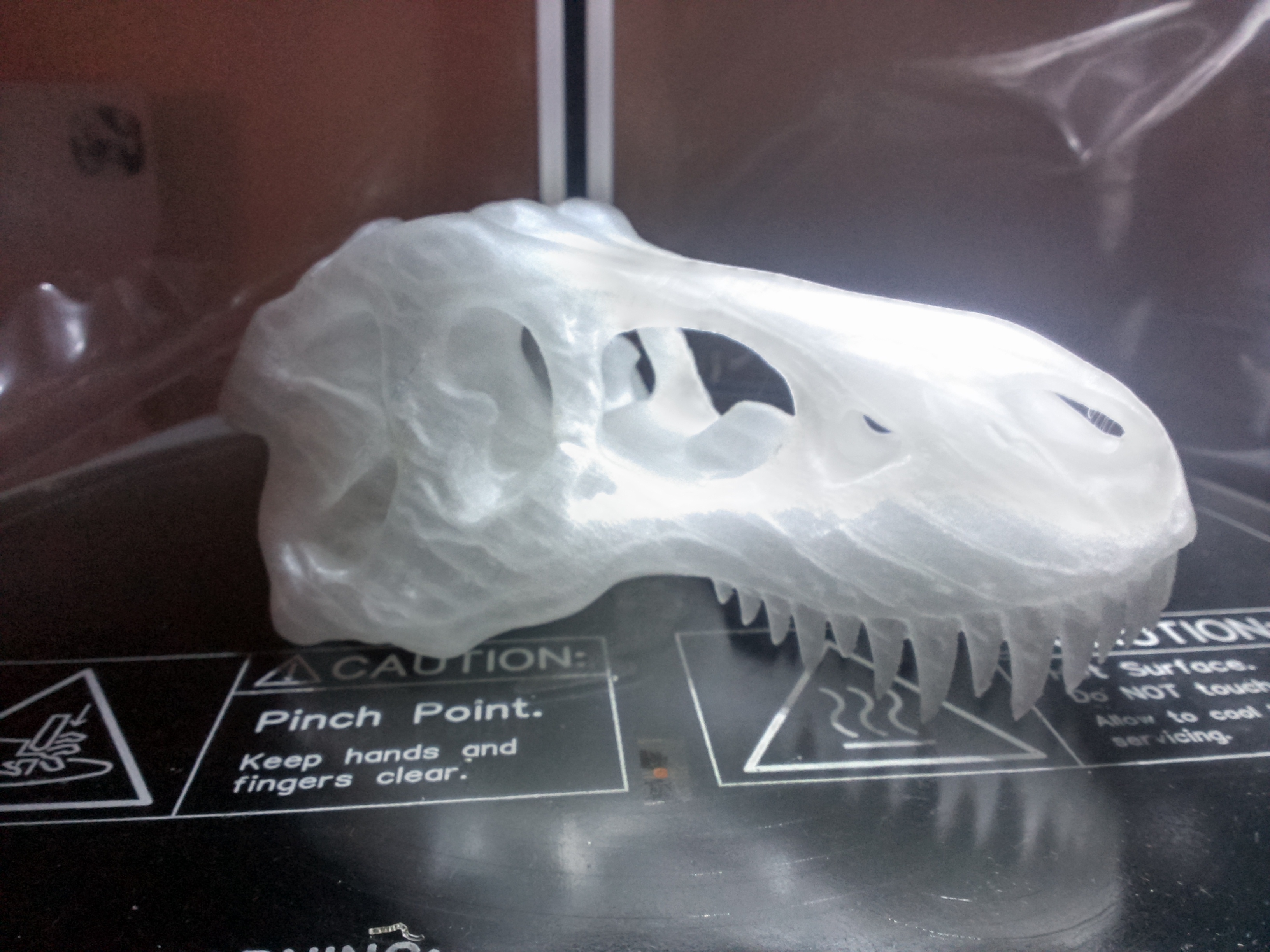

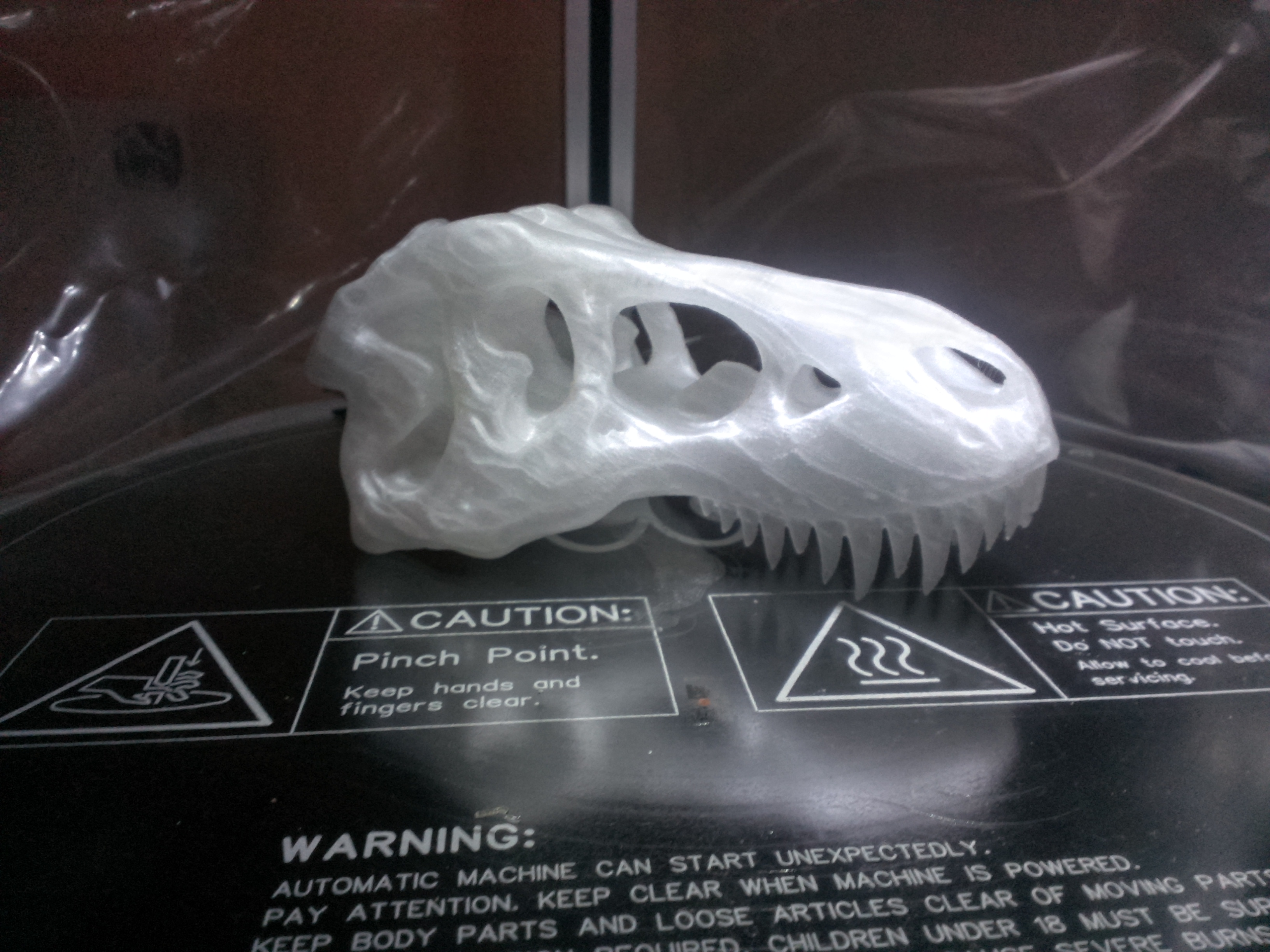

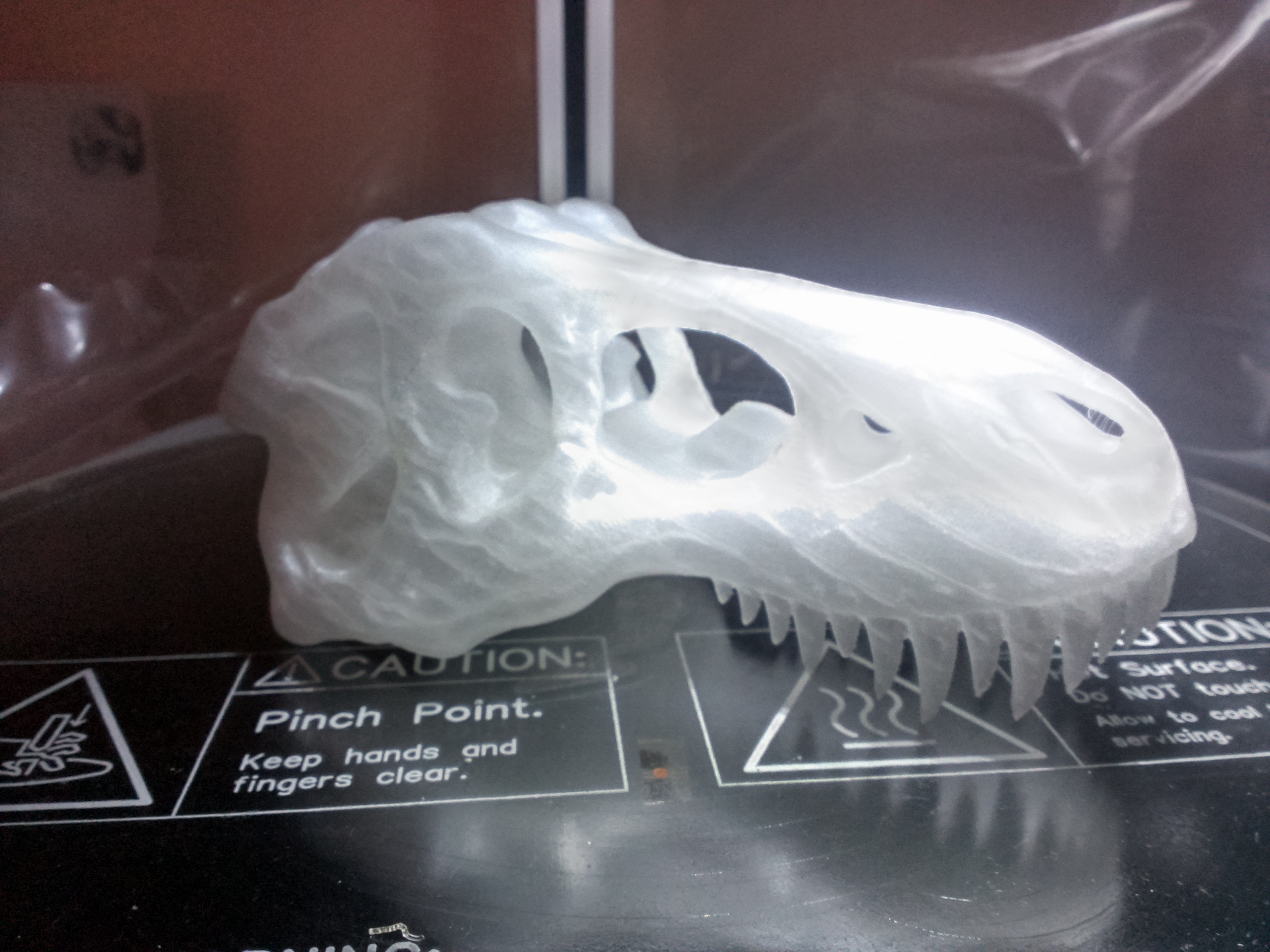

So I was inspired by Mike B to print the T-Rex skull when I saw his avatar. I was blown away when this print finished. This may be my cleanest print yet.
So, how many of you think I should attempt a cold acetone vapor finish following McSlappy's youtube tutorial here?
Or should I just leave it the way it is since it has that cool Crystal Skull look to it?

I'm liking the crystal skull look ATM :)
Makes it look a bit like bone/fossil.

Vapor finish might make it clearer. Would cut down on the ridges on the outside and inside of the print.

Hey guys! My bed was set to 90C and the hotend to 225C and the files were sliced using Cura and these settings
JasonCura.ini
Cura settings for ABS prints
(10.61 KiB) Downloaded 498 times
I printed it exactly as the stl loads from the Makerbot Academy model on thingiverse here
But here's my Gcode for the top and bottom of the skull, and here's the pic of the finished skull that came off the bed last night!

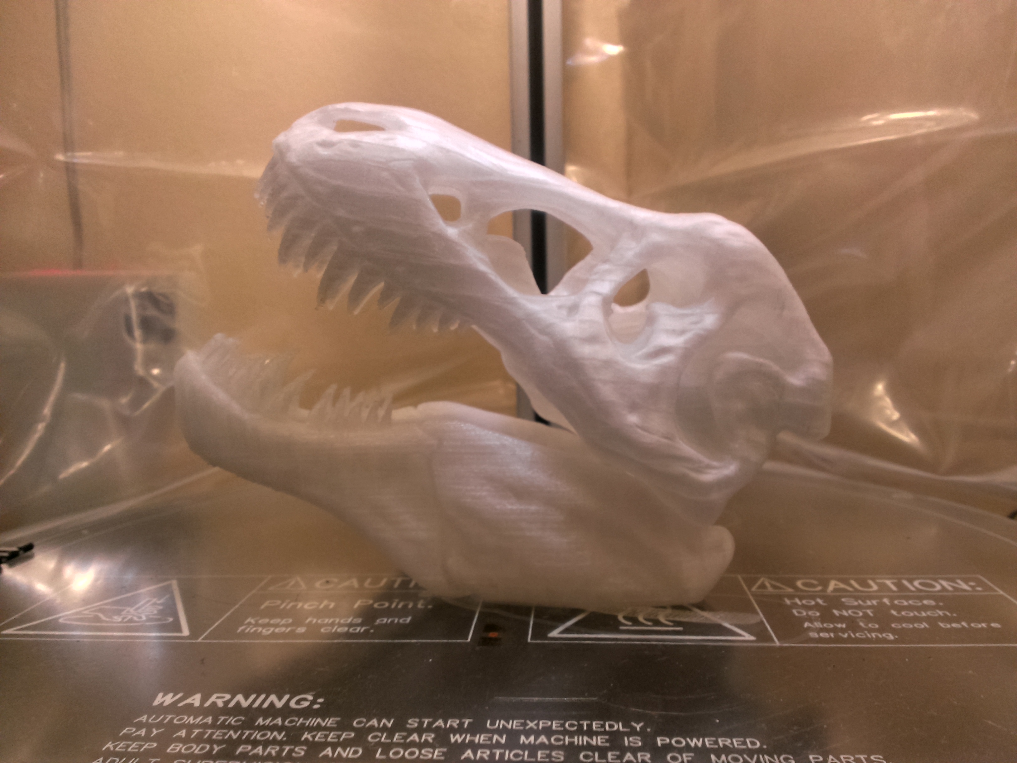

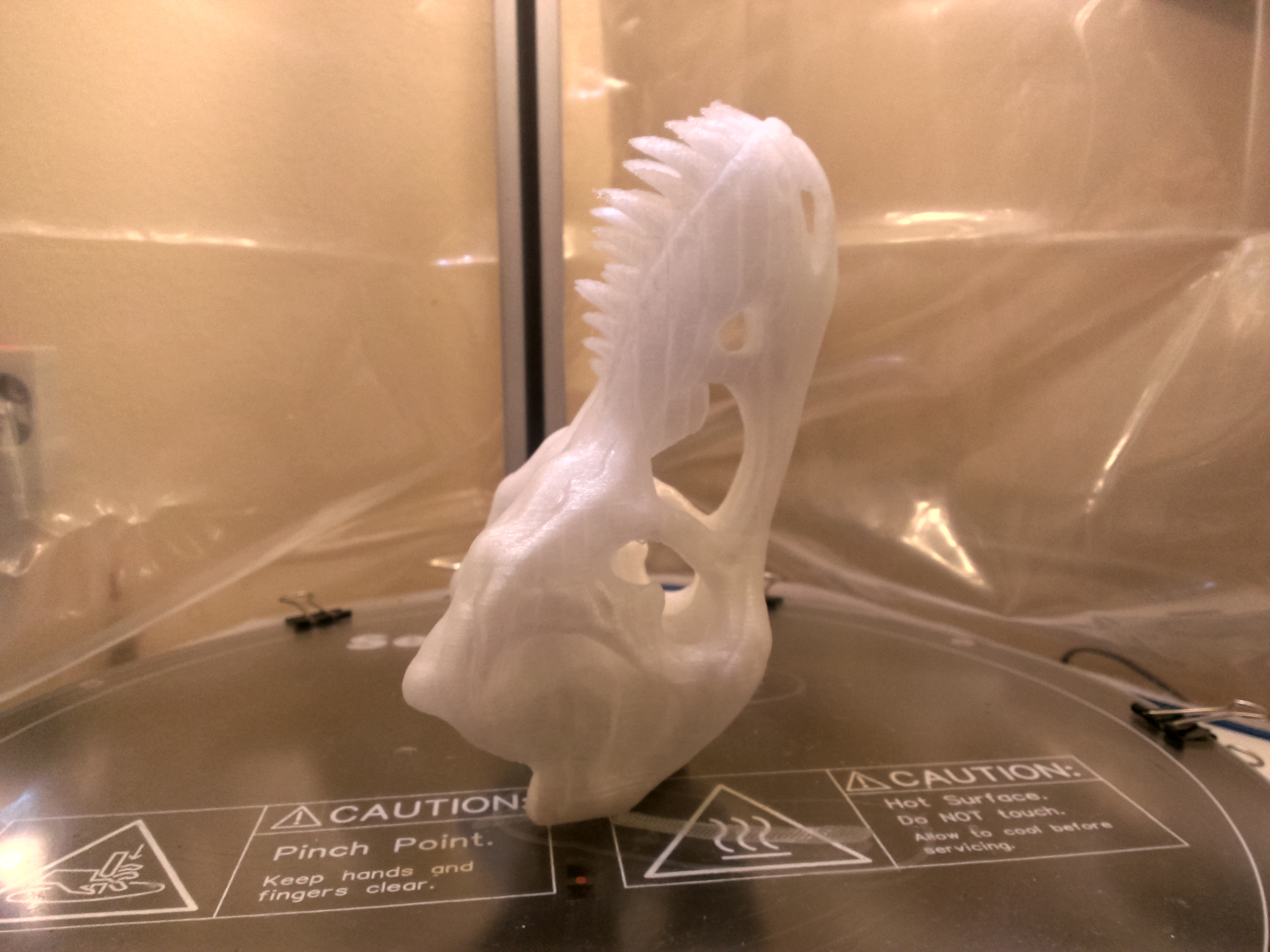

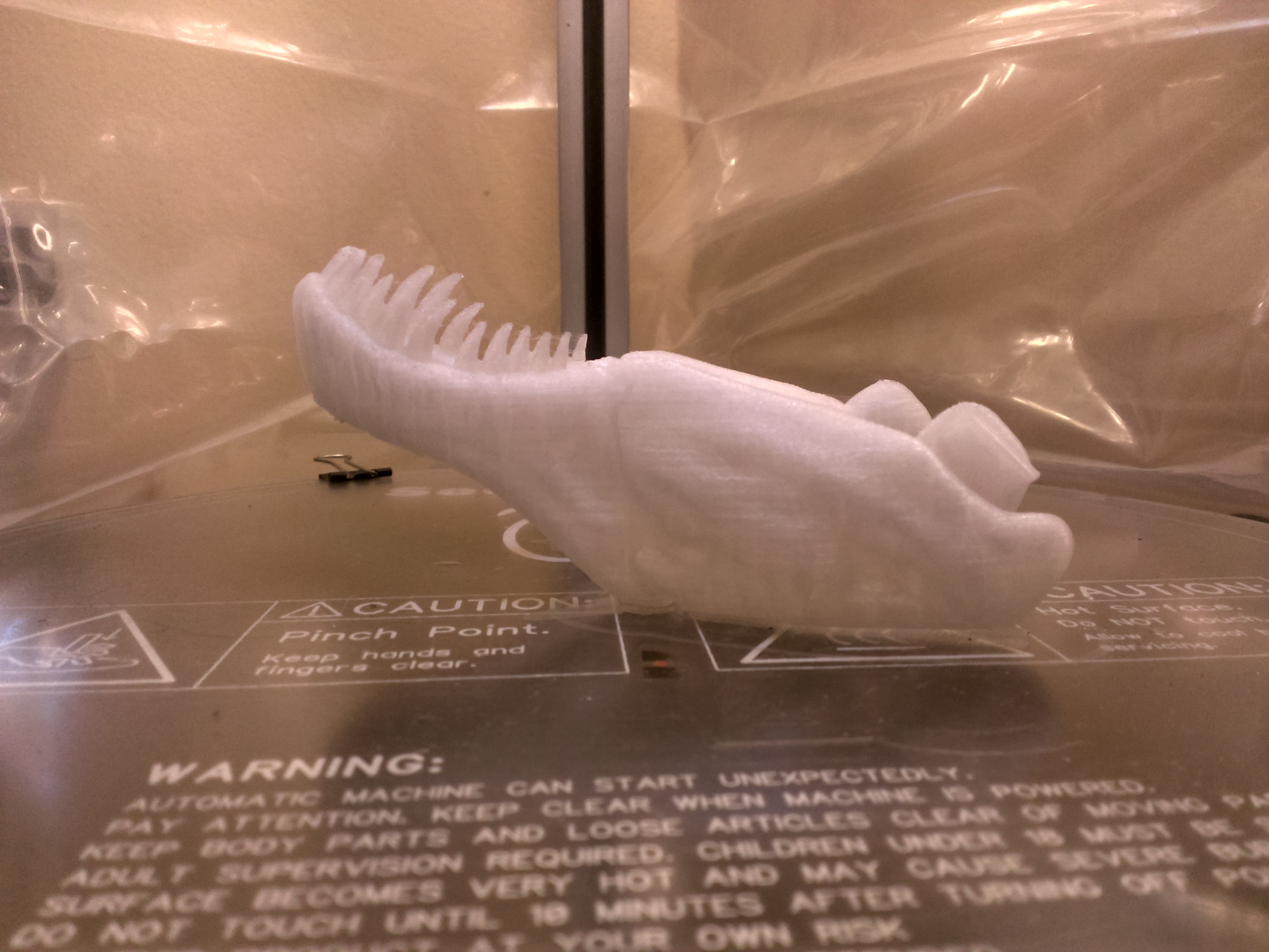

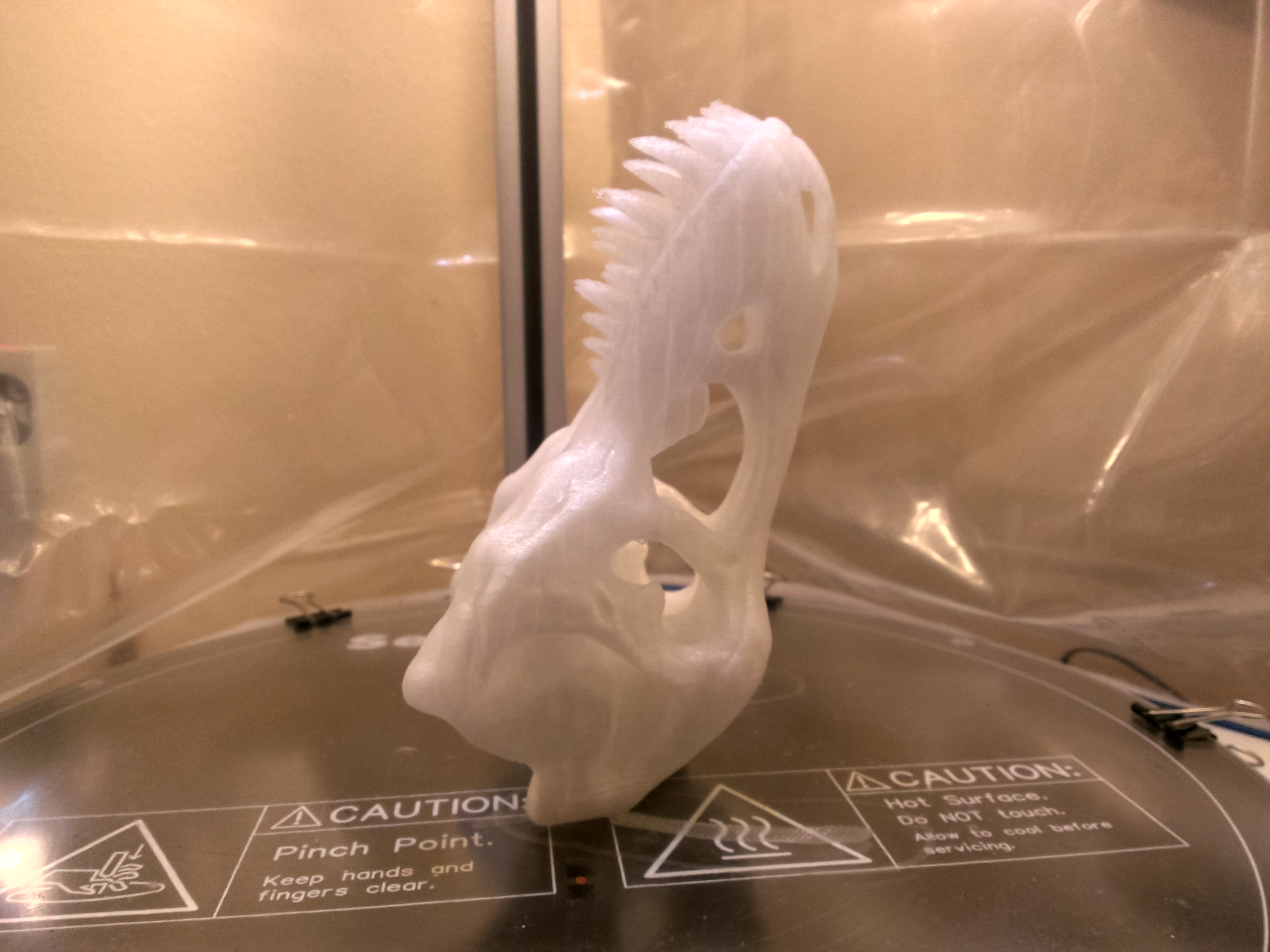

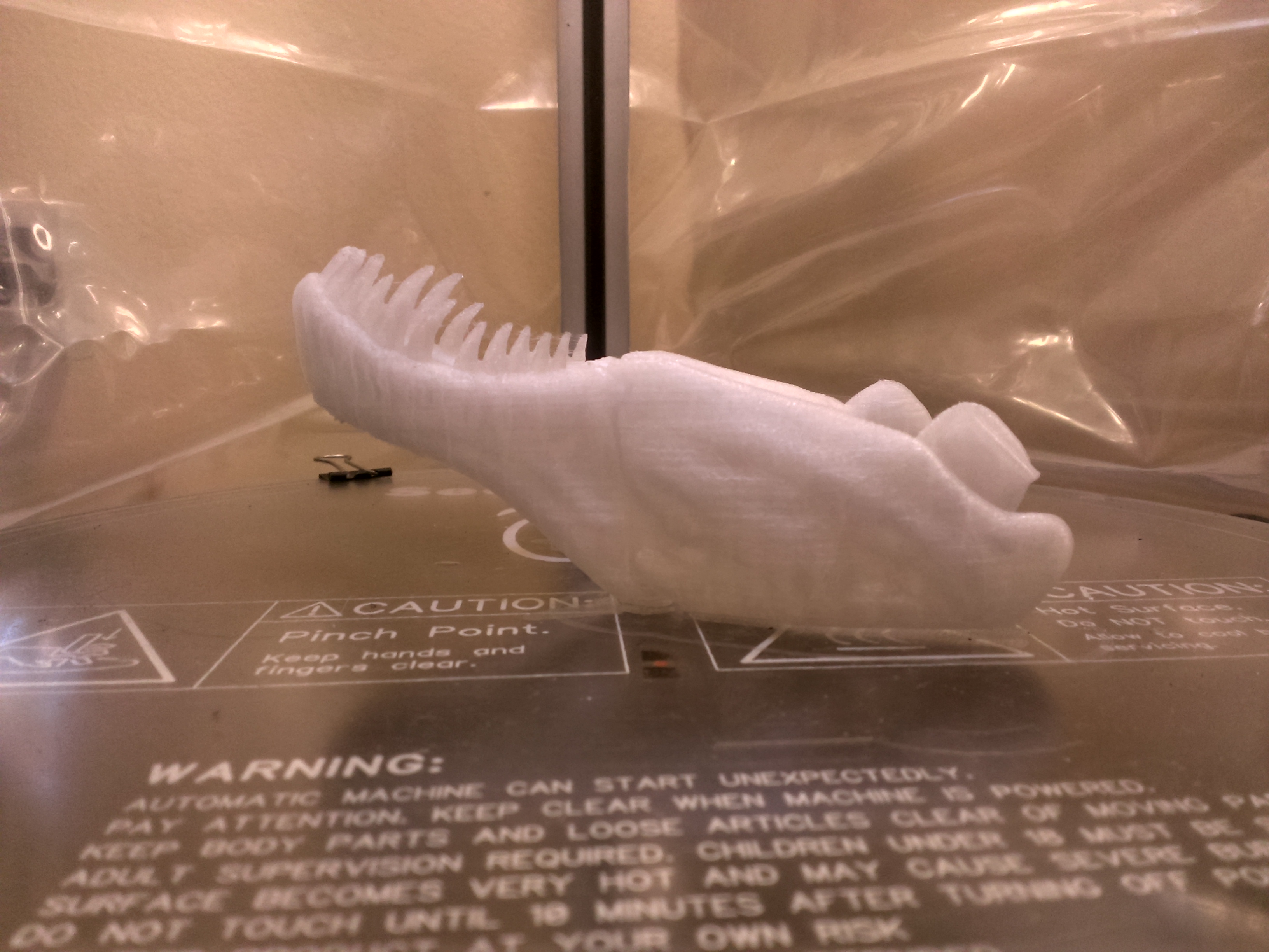

I didn't print any supports for either of the two pieces, I just made sure my printer was calibrated nice and low to my bed, sprayed the glass with "Aussie Mega Hair Spray", and away the prints went!
This is how I printed the upper skull, no supports :)
This is the way I printed the lower, also no supports.  I did slow the speed down to about 69% near the area that the jaws were beginning to connect.  The ABS was wanting to warp.
And here's the finished skull!! @_@ look at it
One crucial factor, or at least I believe it to be, is the shower curtain enclosure I made. It keeps the chamber just warm enough that it keeps warping from happening on my longer ABS prints, so I can print nice and slow to get the quality needed in this skull.

Do it, vapor finish that bad boy!
Clear ABS tends to look pretty awesome, it kind of makes the internals more visible, so that's either a plus or a negative, but I think it looked cool :)

I know you printed the upper skull in the position shown in the picture but it sure looks like it would fall over.
Any tips on how to keep it from falling? I use hairspray but the base attached to the glass looks so small.

Yeah, Eagle, I have no real clue as to how it managed NOT to fall over, but apparently the guys and gals at the Makerbot Academy designed it specifically with this print orientation in mind.
I would say try calibrating your nozzle height just a smidgen lower than usual to get a nice solid stick on the first layer with the hairspray on the bed.

No problem guys! If it doesn't work the first time, I'd recommend slowing the print down. The top of the skull was a 12 hour print and the lower jaw was 7 hours.

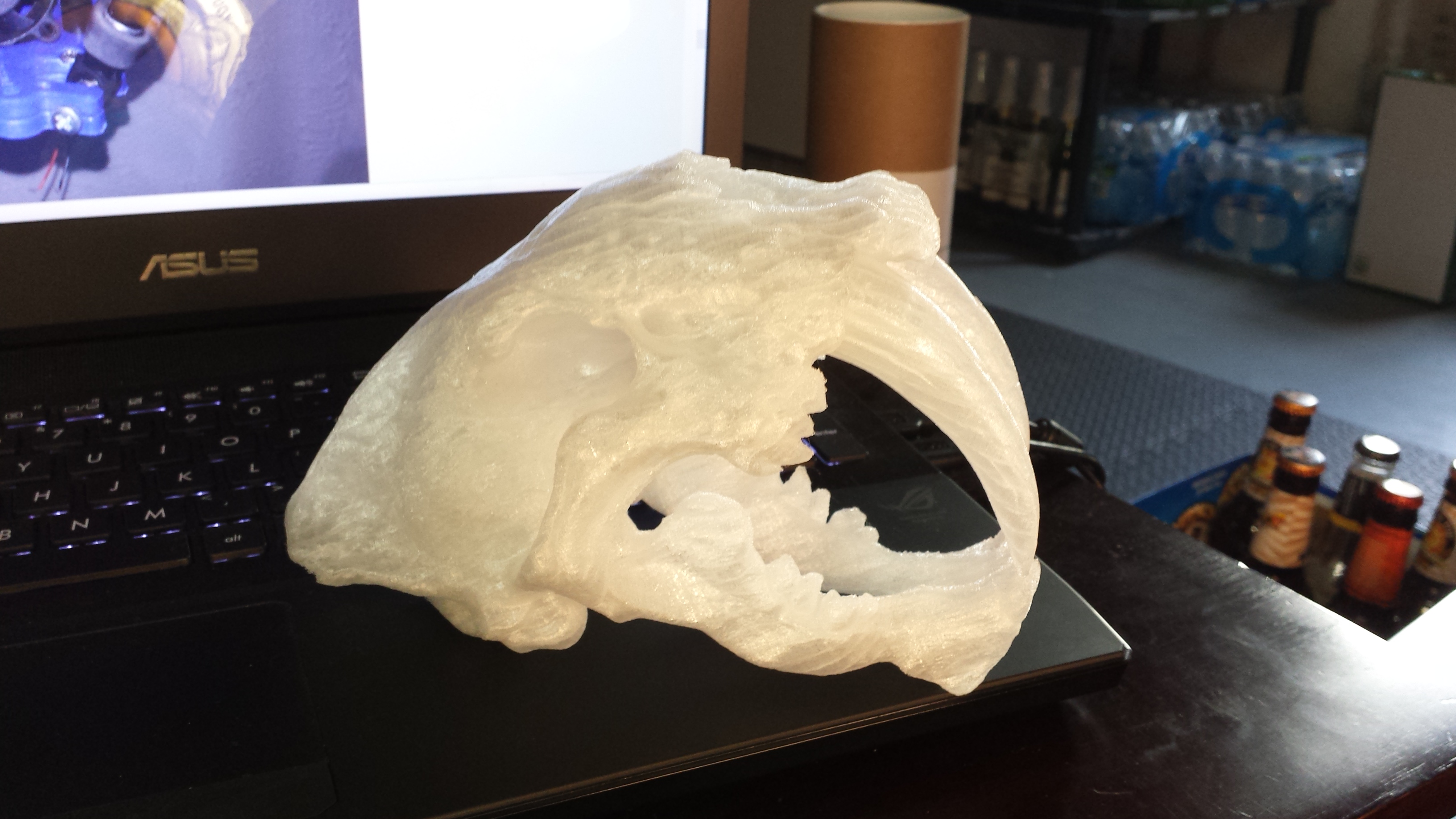

heres my made out of clear pla
lightninjay
Posts: 288
Location: Tampa, Florida
Re: Transparent ABS T-Rex skull
Post by lightninjay »
That's one sweet looking print! Saber-toothed tiger? I like the shiny look to it :)
Awesome print of the clear PLA skull!
Great Job.
predawnsky
Posts: 169
Joined: Sun Oct 05, 2014 8:11 pm
Post by predawnsky »
lightninjay wrote:That's one sweet looking print! Saber-toothed tiger? I like the shiny look to it :)
thanks, yeah its a saber tooth tiger
