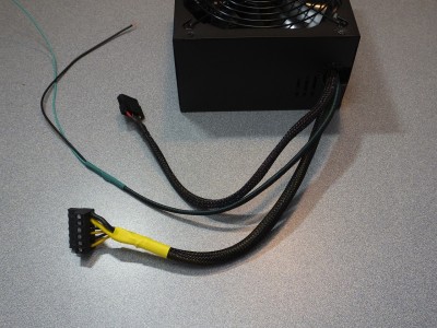

You can always open up the power supply itself and remove all the wires you don't need. That makes it a lot cleaner.
You can take it a step further and replace the "ganged wires" with nice silicone insulated high capacity single wires.
If you're really compulsive, you can get mesh sleeves in various sizes to bundle all your wires.
If you're really off the rails, you can get a higher capacity power supply that matches the color scheme of your chassis.
8-)
Power Supply Perfection
P.S. The wire bundle with the red wires is the only original wire I kept intact. I wanted to leave a 5V harness available for use with future upgrades I plan on making. You could get away with just the 2 bundles.

Brian,
By the way, I noticed you replaced the gang-of-four (blacks and also yellows) with a single fatty. I like that. Very clean overall, but I especially like that touch. Bravo.

GPriv wrote:Brian,
Thanks. You don't need the one harness shown. I left it there because it was 5V and if I ever added something with a servo on it the 5V would be handy.
I used high quality 14gauge copper stranded wire normally sold for high powered quadrotors. It's expensive, but I wanted the build as neat as possible. I probably spent 60 hours assembling the thing back in April/May. I tweaked everything like a Chip Foose custom car. Well, not quite as bad as that... LOL. I took a lot of photos and videos for a build log which I want to produce, but having too much fun printing and learning best practices at the moment!

I'm not up to those standards but I am getting rid of wires. What's your suggestion on doing it? Clip at the base of them, or do you actually heat the solder and yank?
I'll leave a bundle, for the future. You suggest the black/red/yellow quad bundle? I don't know squat about electronics so volts/amps/current speak may as well be Zimbation.
Re: Wires don't match instructions... ARGH!
Posted: Sat Aug 23, 2014 4:58 pm
by Brian
GPriv wrote:I'm not up to those standards but I am getting rid of wires. What's your suggestion on doing it? Clip at the base of them, or do you actually heat the solder and yank?
I opened up the supply and desoldered the unused wires. I had to do that so I could make room to drill a larger hole that would allow me to solder the 14gauge wire to my power supply board.
It should be possible to open the power supply and clip off the unused wires at the very base where they are soldered. You want to do this very carefully because the wires are comprised of many little fine wire strands and you have to make sure you don't have any leftover short strands sticking up from the board or loose inside the supply. If you are neat about it, you will not have any issues.
I want to stress to anyone else reading this topic in the future, DO NOT simply clip the wires off the outside of the power supply case. This is very bad practice. A short could turn up later if you do this. You MUST get rid of all the wires at the point where they solder to the circuit board, flush with the board, so no loose strands are left.
