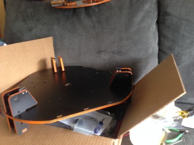

Re: crocky's Rostock Max V2 Build
Posted: Tue Aug 26, 2014 2:49 am
by crocky
Well I got the melamine all released from the sheets and the only things that took the smile away was a few holes that did not go right through with the laser. A pair of the upper supports had 3 holes in each which didn't go right the way through, lots of time with some various drill bits by hand and I think it will be fine, phew!
A bit of sanding on couple of bits that were not fully cut and I think she will be ready for some paint tomorrow.
I wonder if we asked for a clubhouse group to put on here for the Aussies, I'd hate to have to go somewhere else :) :)

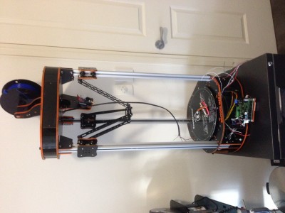

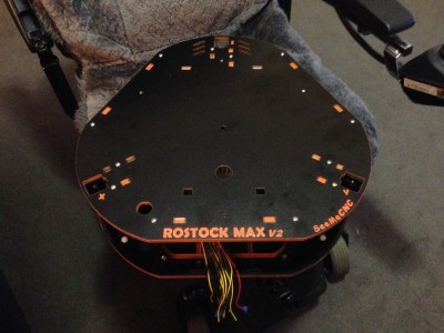

Posted: Fri Aug 29, 2014 8:26 am
by crocky
Back again :)
Progress so far, painted most of it orange (doesn't the thing suck up paint). Installed the motor dampers, had a loss trying to find screws and then I remembered that my crimping pliers had an area for shortening screws :)
Got power supply in and got rid of the un-needed wires, I also got 12volts and 5volts (you never know what mods will happen).
The base is pretty well done now, the fun will be when I get to the Rambo!
The Bandit So Far

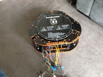

Posted: Tue Sep 02, 2014 10:31 pm
by crocky
Progress Again :)
The hot bed is all soldered up and fitted, there is a mess of wires coming out where the rambo will fit!!!!
The base with the hot bed
I like how the top of the base has the X, Y and Z printed out.

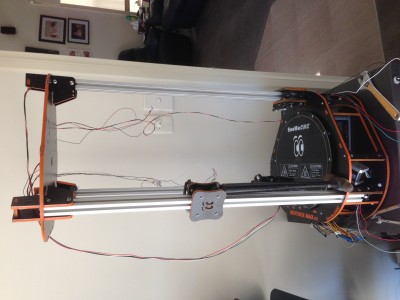

Posted: Sun Sep 07, 2014 7:17 am
by crocky
What I have done....
Cheapskates tightened, belts fitted, extruder fitted, reel holder fitted, LCD fitted (some those nuts are real small and difficult to fit, but....).
Just have to get the poles perfectly at 90 degrees and then tighten them up, gotta find the square!
I am waiting for a few things from eBay including the special crimping pliers for the Rambo board

Well it is finally done and currently printing the fan shroud :)
There is a few funny pops as it is going along but I will leave it while it is happily printing.
The setting was a fun exercise for a wheelchair bloke, go to the printer and set some paper then back to the computer and...... on it went for about 4 times :)
I'm using kisslicer and it looks like it is building some support structure for the model, probably a bit much but it is a test! I am using the mhackney configuration...

*** MODs to Rostock Max V2 kit
Painted the edges orange, not really necessary and it is kind of rough!
Named the thing The Bandit, something to do with me being one armed!
Fitted the dampeners to the three steppers in the base, really makes a huge difference to the noise.
Changed the Rambo fan for a Noctua NF-A4x10 Premium Fan, too many stories of failures in the forum pages.
Did the McSlappy hot end heater cartridge and the screw in thermistor mods.
After hearing of lots of power supply problems I am leaving the rear covers off until I have fitted a Noctua NF-A9x14 Premium Fan. The power supply breaths a lot better in the kits that are coming out with the new multi slot baseboards with particular attention to the power supply area.
I have PEI on the way :)
I am waiting for a 18 led 60mm circle to arrive and I will make an adaptor and mount it to the hot end.
That should be enough for a little while, I really just want to enjoy it now!!
