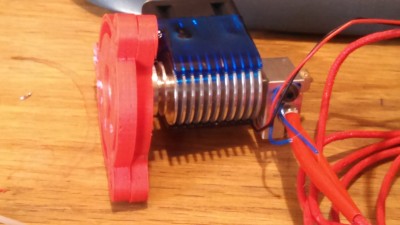

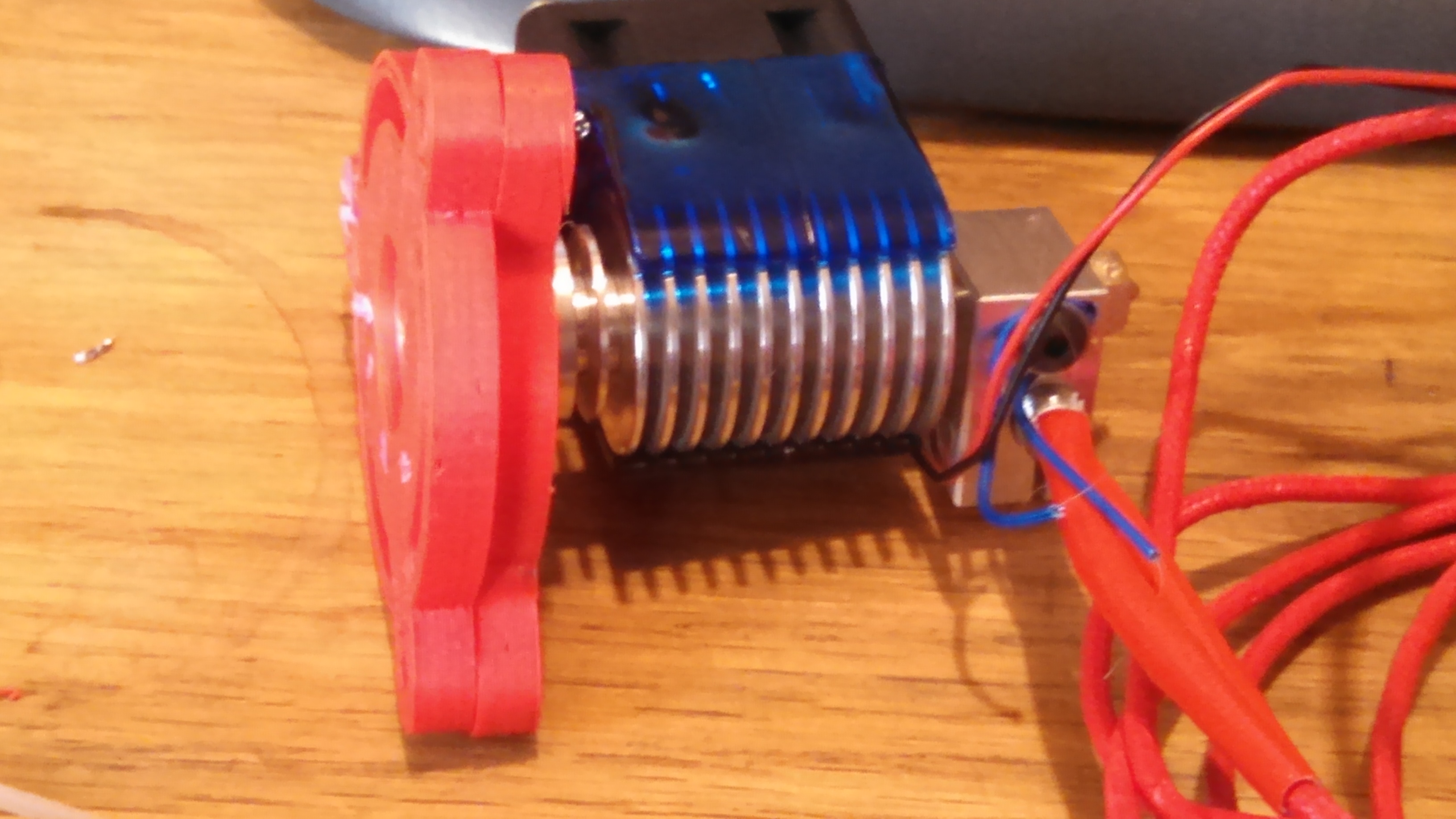

Hello,
I went to Thingiverse, and found a mount, I liked it but, it was for E3D's V5, which is bigger. The smaller profile of the newer V6 print head, doesn't fit in the printed mount. So, I changed it, and exported as a STL file, and slic3r just got done with it. The tolerances of the V5 mount, would have the nozzle up inside the carriage by so much, the plastic would have to drop down to the print plate. I made some measurements and found that it would be perfect, if I just used the old aluminum stand-offs, and just got some longer bolts, keeping the phillips head screw down and the bolt on top. But, I found I could pinch the cool end of the hot end with two pieces of plastic and hold it securely in place. So, here's the STL files if you want them. Making other adjustments, to accommodate their thermistor, or just using the one the came with the printer originally can solve that problem. Solving it, has another side to it as well. You can clear the Rambo's EEPROM, and fix the Configure.h file, and reload it with the thermistor that came with the V6 print head. So, here's that file.
The PVC Primer and I suggest using Purple Primer, will cause the plastic to expand. It will absorb the acetone in the primer. The PVC glue, I suggest is RED, it's easy to see red against purple. This will only work if you print with ABS. But, the gluing process is simple, use some short nuts and bolts to hold everything together, and be quick, the stuff dries quickly. Give yourself seconds, even if they offer you minutes.
For some reason my printer has printed this bigger than it should be. I'll get back to you.
http://www.mathsisfun.com/numbers/perce ... hange.html
Okay, when you go to calibrate your printer, Z is separate from X and Y. I would advise making two pillars 1 cm in diameter, one one centimeter high, and the other 10 cms high, using your CAD program to produce the STL file. Then two circles, one 1 cm in diameter and the other 10 cm in diameter. Then use the equation, if you find a decimal with a 1. something, just scale it up by 1. whatever three places after the decimal, and or scale it down, if there is a leading zero. Z is not, and does not equal X and Y axis relationships. Then do X and Y separately. Do your scaling in a CAD program for whatever model, if you need exact.
We're not printing bullet proof skins, nano-robot cell replacement tech, or shattering bones that contain the data of our pre-existing neural cell structures but, we are printing plastic. You can be remembered forever but not live forever. These 3D printers only do so much, and we cannot even replace an organ no matter how exact.
I've edited this file 3 times, now everything fits tightly.
E3DV6RostockMax.zip
(68.17 KiB) Downloaded 433 times
How the pieces fit!

I'm surprised that there's no calibration procedure for this thing. I just printed what was suppose to be a 1 cm cube. Took it off of the print bed, measured it, then corrected the X,Y and Z, by scaling the project.
My Z=0.864, X=0.953, and Y=0.984
So my cube was 10.16 mm long, 10.49 mm wide, and 11.57 mm tall.

Maybe, I need to read the other manual for the first Rostock Max V1. There's a deleted chapter, and it's written there and chapter 22 was described as bad luck. I've read my whole manual, and I ain't seen that calibration.
You do know it's a PDF file, and I can just search for "Calibration" and that's just the hot end, and hot bed, there's nothing about adjusting scale.
X, Y and Z are off. I didn't write the software, or alter it, yet. I am going to, and just think slic3r should hold the modification variable and let the big computer do the hard math. It's just not a scaling variable there to fix indifferent 3D Printers. If you're right, everyone that prints the 1 cm cube, will be able to use their calipers and measure exactly 10 mm on every side. They can use their own CAD Programs and I'm telling you, I'm running an unaltered version of the software. I am going to alter which thermistor I'm using as soon as I mount the new printing head.
Everything fits together now but, my fan shroud, I now know it was printed too big. The fan is rattling around inside the print. Want me to make a video of me shaking it?
