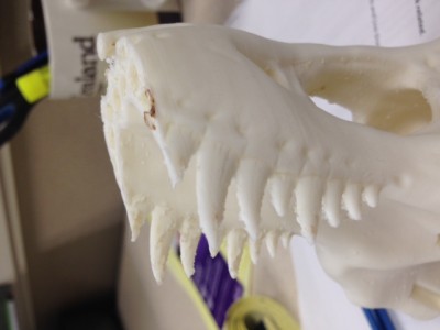

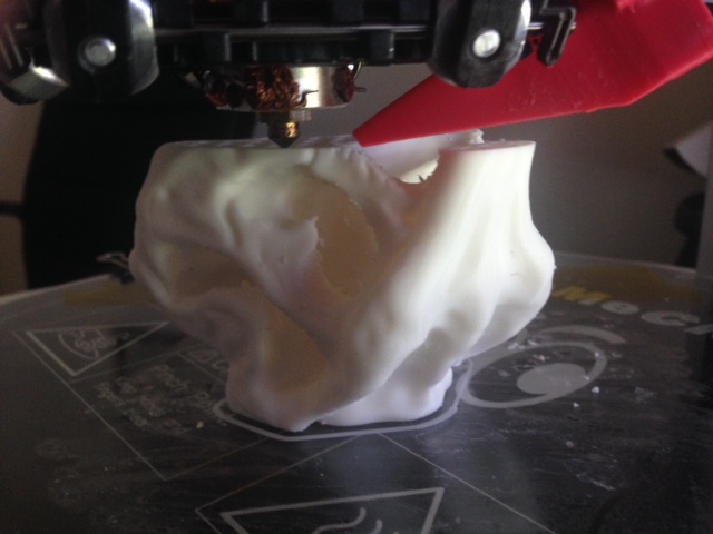

Are there any obvious reasons why my z-height would be dropping lower after every print? I'm really at a loss. I have gone through the calibration process several times, probably upwards of 50. I go through the process at least twice a week because everything seems to come unglued, figuratively speaking, after even smaller prints. The change i've noticed has been an actual drop in the z-height, so that it's physically lower to the point where it contacts the plate. Has anyone else experienced this after printing? And if so, is there anything we can do to combat this? In addition to this issue, we've been experiencing excessive globbing, which you can see in the pictures attached. You'll notice that it gets HORRIBLE around small detail parts and sections, like the teeth on the dino skull. I called seemecnc, and the guy thought that perhaps our retraction settings were jacked up. The current settings are set to the defaults (we are using slic3r):

Most likely you are printing slightly too hot, you are probably over extruding slightly and you might need more cooling.

Polygonhell wrote:Most likely you are printing slightly too hot, you are probably over extruding slightly and you might need more cooling.
Thanks! So our multiplier is currently set to 1.0, would suggest we drop it down to .9 to see if that helps as well? is the z height varying after prints normal? I didn't realize we would have to recalibrate so much if that is the case.
