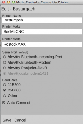

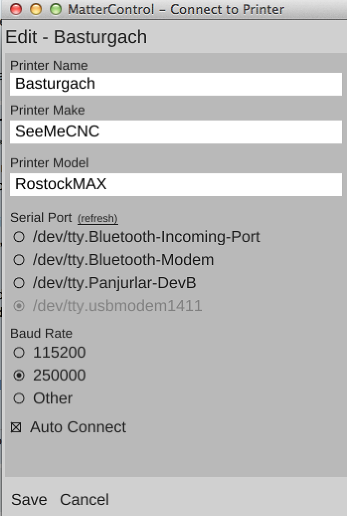

2. If you add more printers, you will be able to see them. In matter control they will just appear one after the other. (In windows, I think you do this by setting the printers to different virtual serial ports). If on a mac you should be able to see the 2 different printers. Connect them one by one and give them a name and you are good to go.

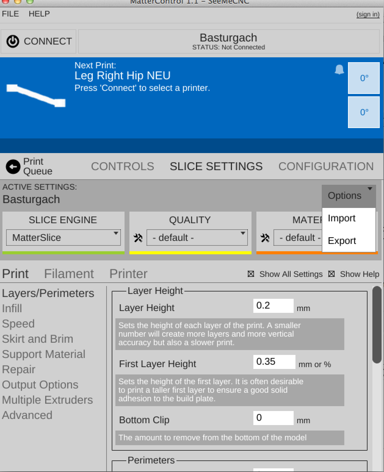

If you have lots of settings such as filament thickness, slicer settings etc etc you will find it beneficial to export the settings and re import them to your new computer.
When you add the printer on the mac you will notice a different serial port as in the image attached.
And you can export your settings in matter control by going to advanced and then clicking export
