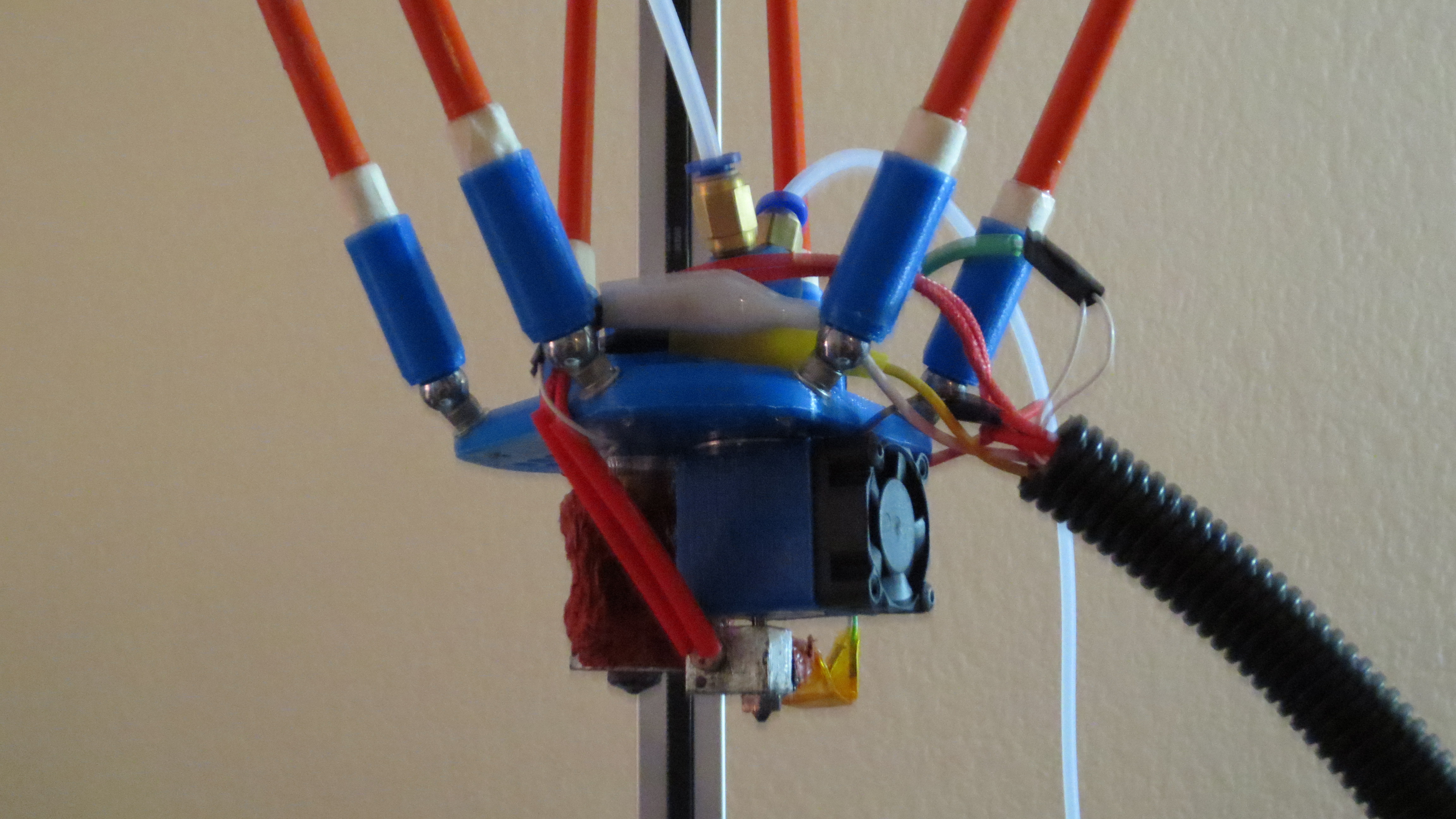

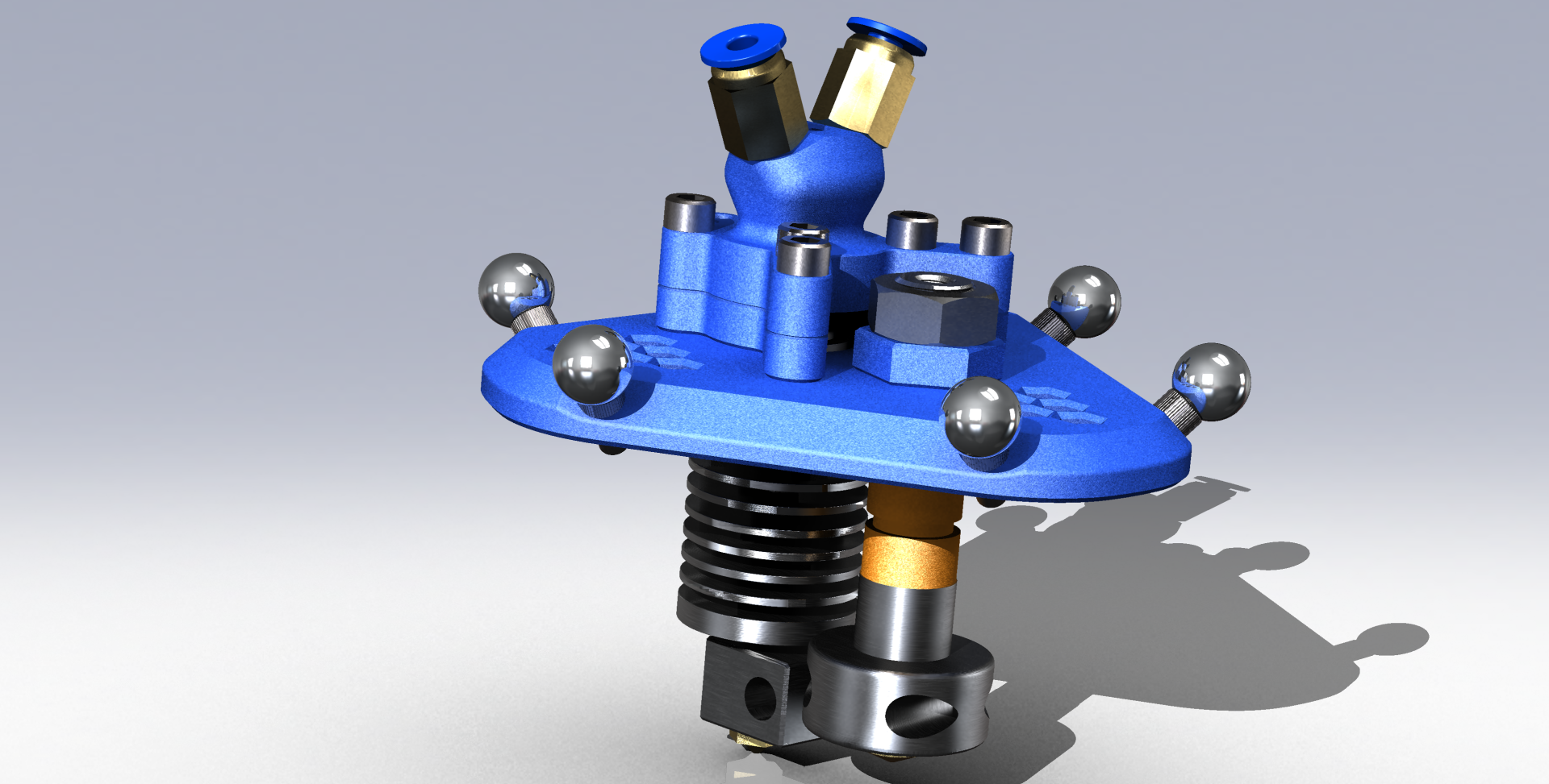

[img]http://forum.seemecnc.com/download/file ... ew&id=3001[/img]
[img]http://forum.seemecnc.com/download/file.php?id=3002[/img]
I made that around a year ago to try to fix the problem. It merges up to three different filaments in one hotend. At the time, the software wasn't very supportive of it but now Cura would work with this very nicely I think. I still got a few working prints of two types of nylon at the same time being printed. Up to three filaments in one hotend, one filament in the other. At the time I was designing the mount for the hotends I had available. Now I can just make my own hotends entirely!
This has the limitations of a single nozzle size, the need to heat up or cool down if different plastics are being used, and large retractions+large purgings on each change. So it can be optimized with a shorter hotend to waste less plastic and be faster, but it will always be slower than alternatives.
Since then I've come up with a few solutions, one of which I can't describe here for another week or so. I believe that a multi-nozzle hotend with leveled nozzles and independent temperature control and filament feed will be the best solution.
Furthermore, a multi-nozzle hotend like my Tri hotend can be merged with the multi-input thing shown above. For example one nozzle would print dissolvable PVA at 200 degrees, one nozzle would print trimmer line at 270 degrees, and the third would print multiple colors of ABS through larger retractions with the multi-input thing at 245 degrees.
Colors can be mixed this way too, but the hotend would need a mixing chamber. More products for this kind of stuff are coming later this year and next year. My company specializes in this particular field as the name implies! Expect some mind blowin' inventions in the near future.
Slightly off topic, but multi-nozzle extruders are becoming more and more relevant now that there are more and more types of filaments available.
Just yesterday I was filament shopping on Amazon. I saw polycarbonate, PC-ABS, PETG, and even Acetal POM on sale for use with our printers at $50 per kilo. Plain ABS is down to $20 per kilo and the quality is decent (at least that's my experience with the cheap stuff so far). The biggest advantage of all for multiple nozzles is support material. It can't be understated!

The patent office has recently passed several 3d printing related patents through even though there is extensive prior art. If anyone patents this design I'ma be pissed.
