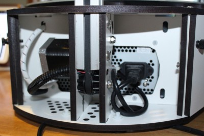

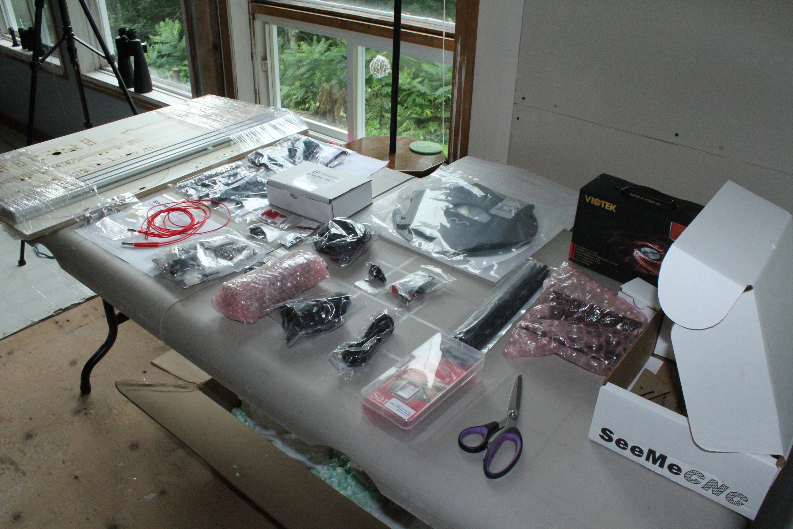

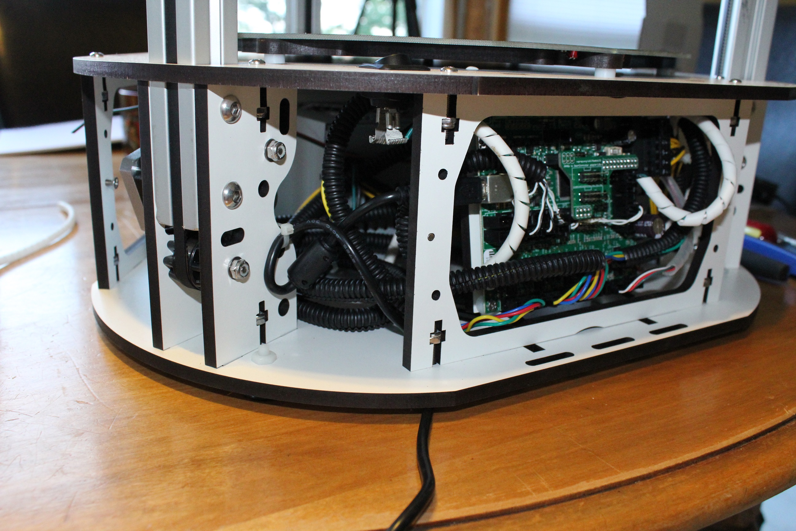

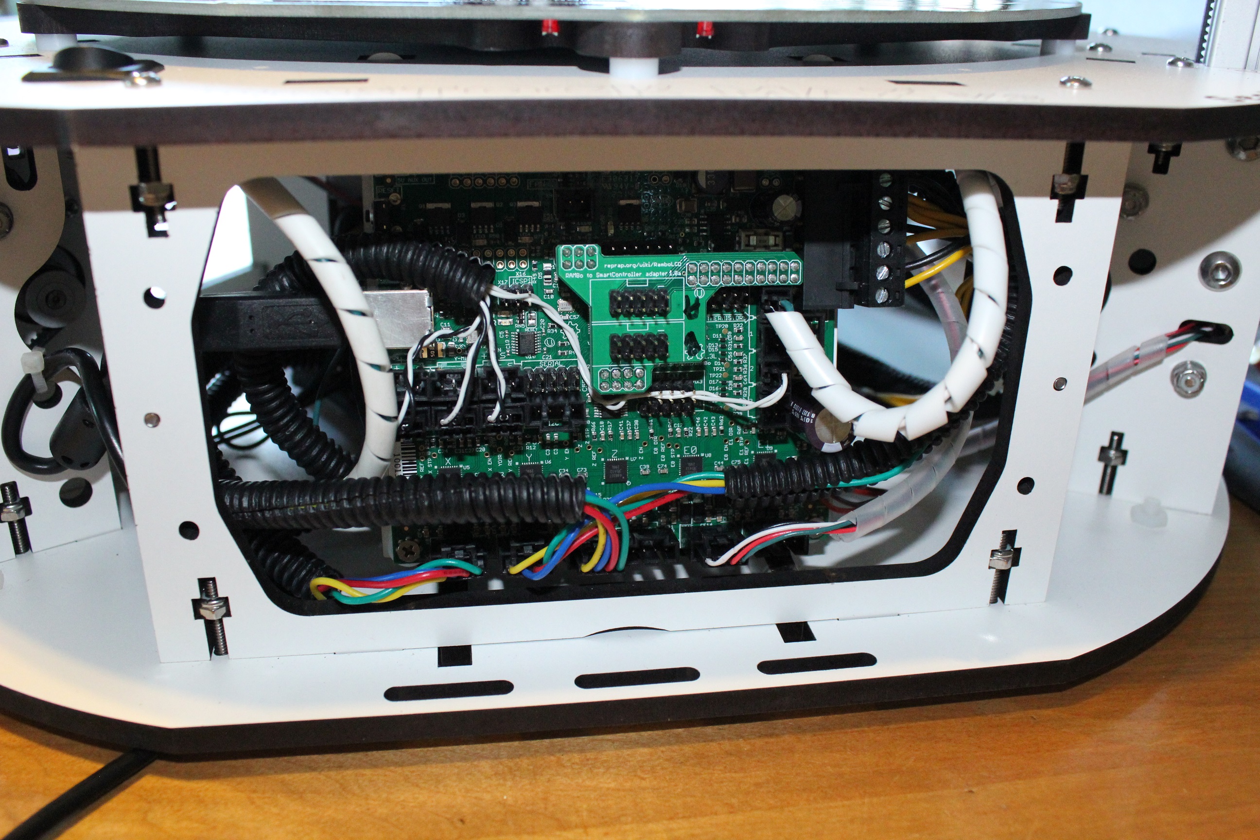

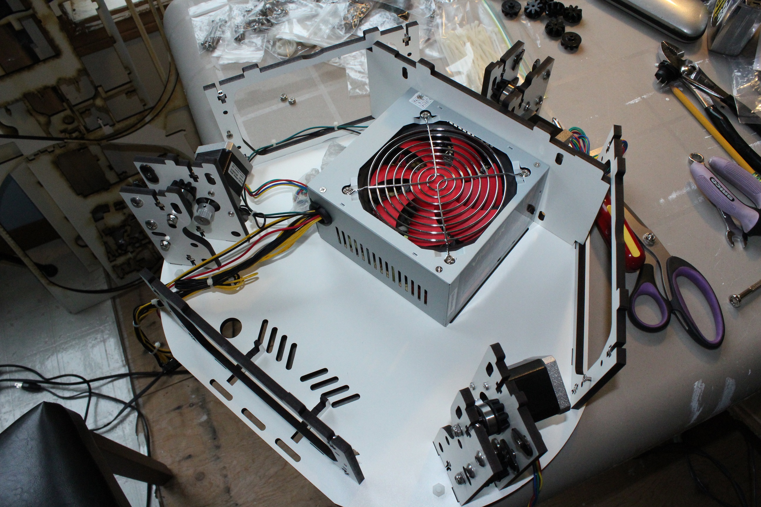

Here are some pics of my build. It went together well with no problems except a faulty hobbed gear . see that post here http://forum.seemecnc.com/viewtopic.php?f=37&t=6373
I had a lot of fun building it learned quite a bit.

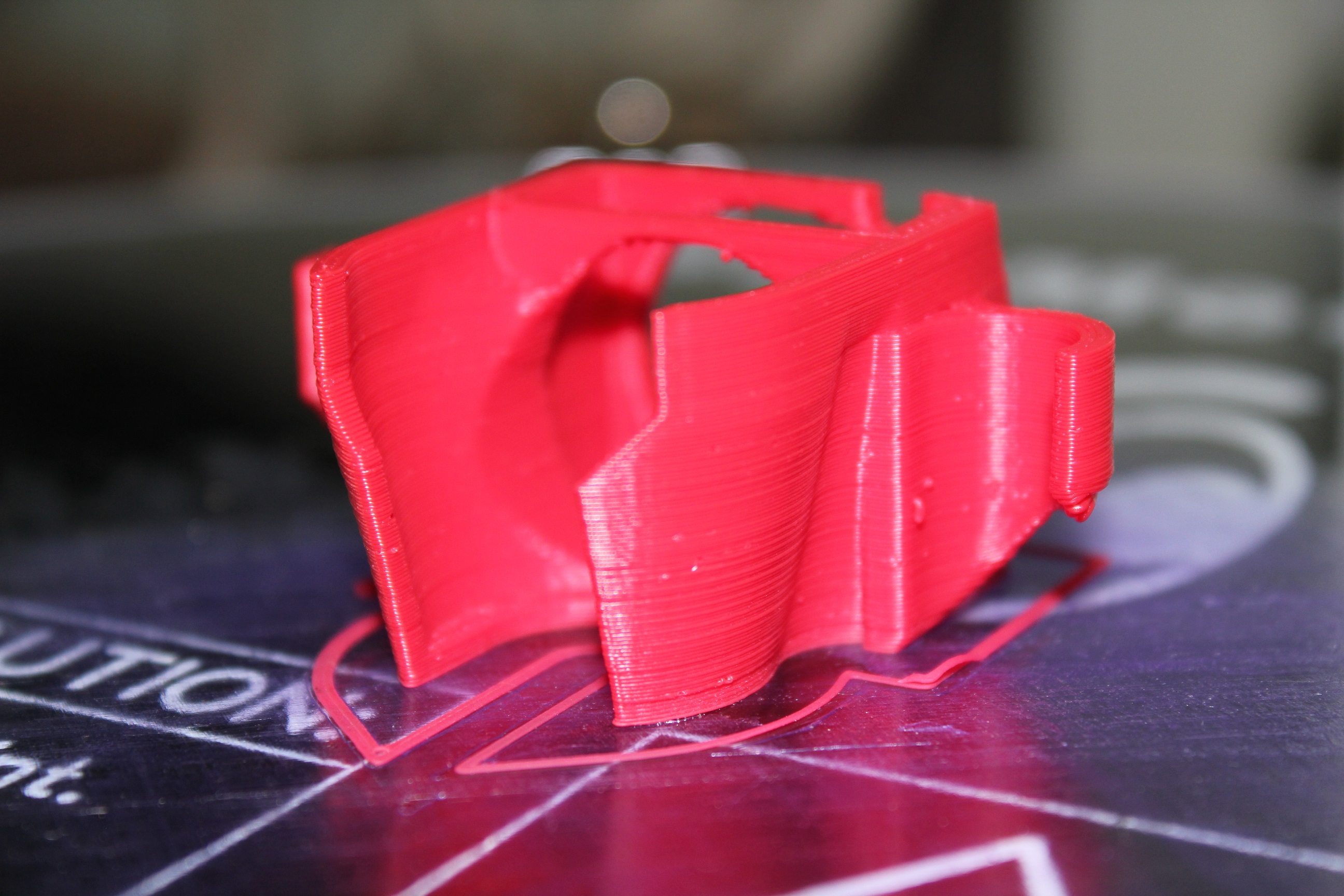

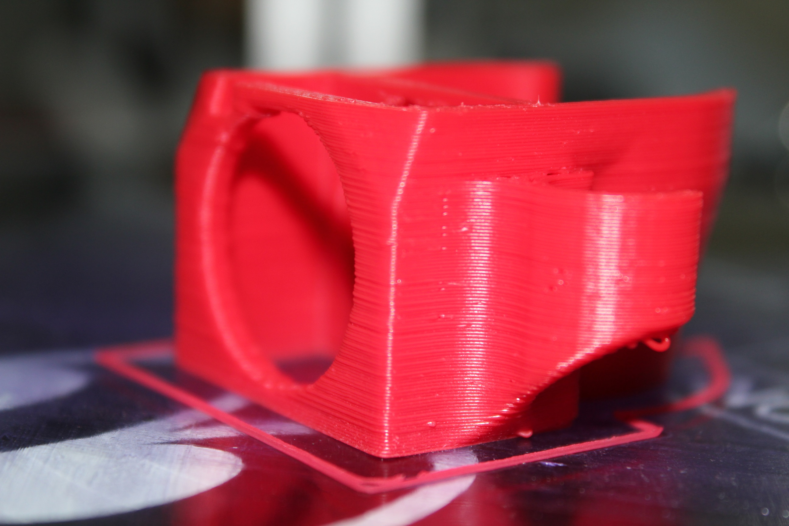

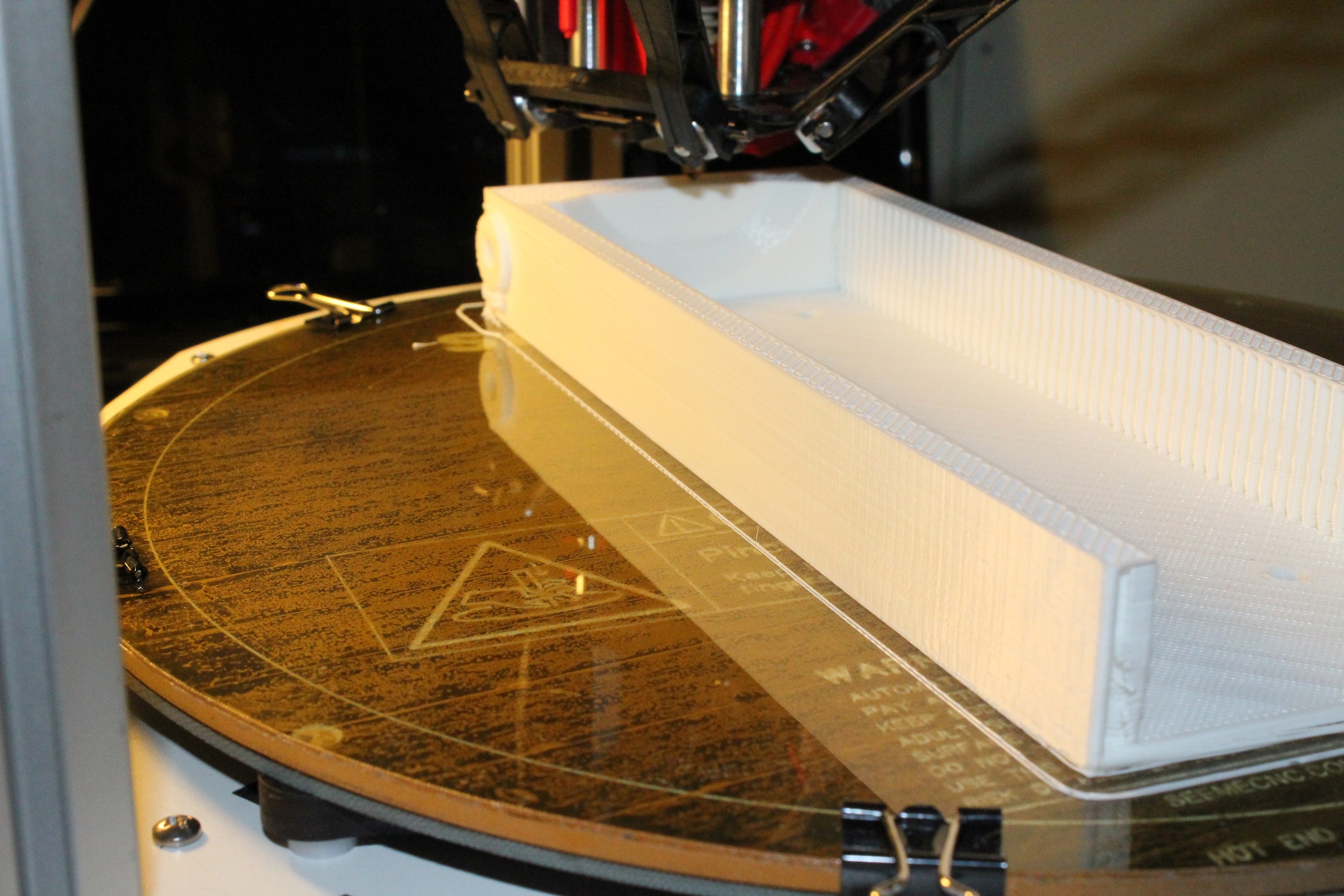

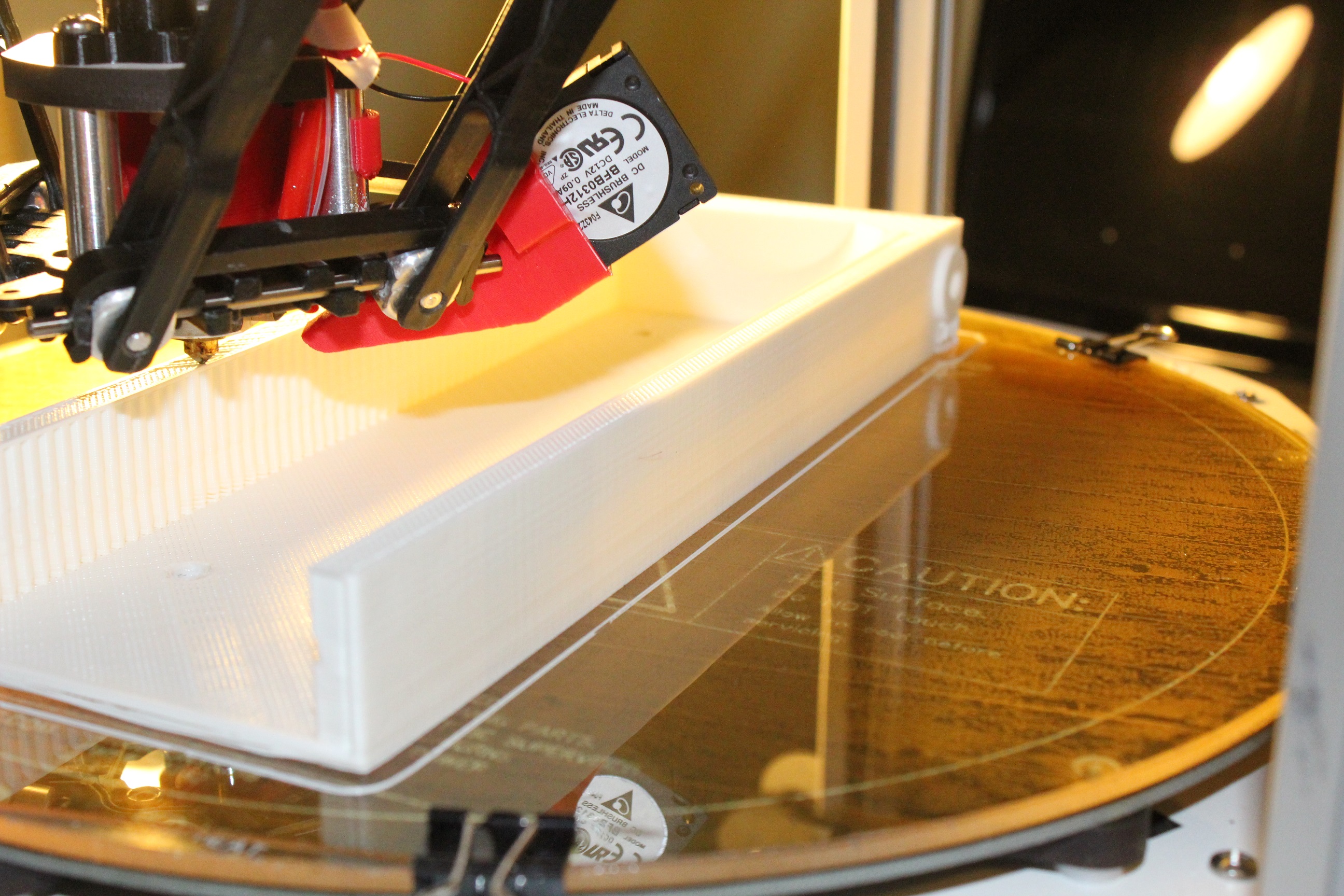

Some careful calibration and adding some PEI pays off. Check out the level of adhesion and how close I can get to the edge. This is ABS at 225 with the bed at 85.
Re: Holy 1's Build pics
Very nice! Congrats on the build. Any separation on that large an ABS print?

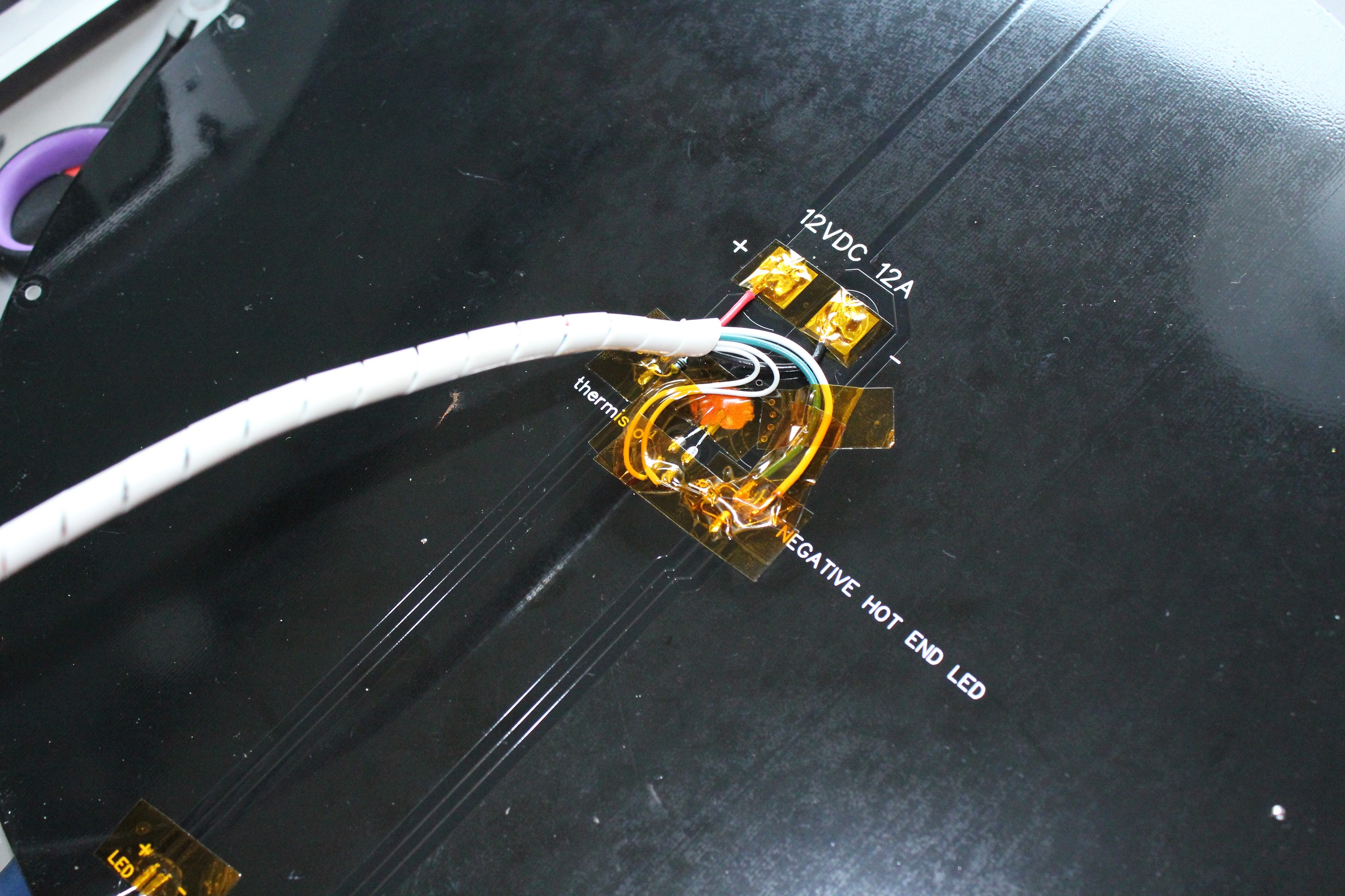

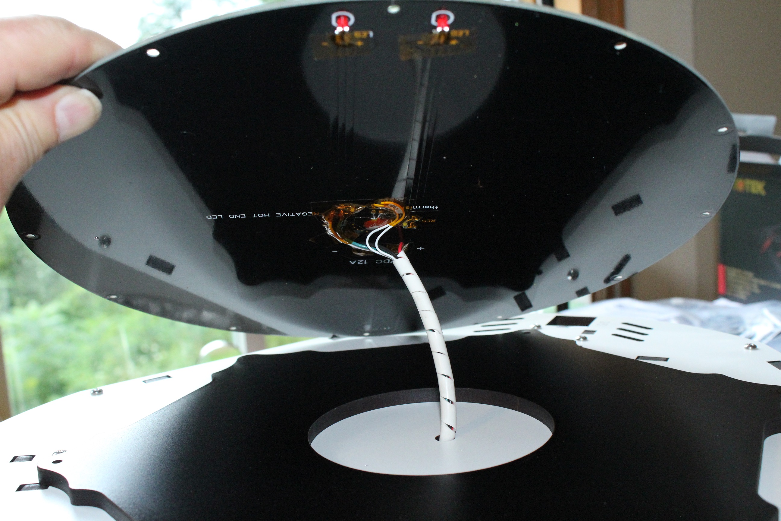

Where did you get the PEI Plate? The only source I know is amazon mentioned here in another thread. But I´m waiting now for 2 month without getting it.Holy1 wrote:Some careful calibration and adding some PEI pays off. Check out the level of adhesion and how close I can get to the edge. This is ABS at 225 with the bed at 85.
Can you post a source for the PEI Plates your using?
Thanx
Dirk

What is the thickness of your PEI?

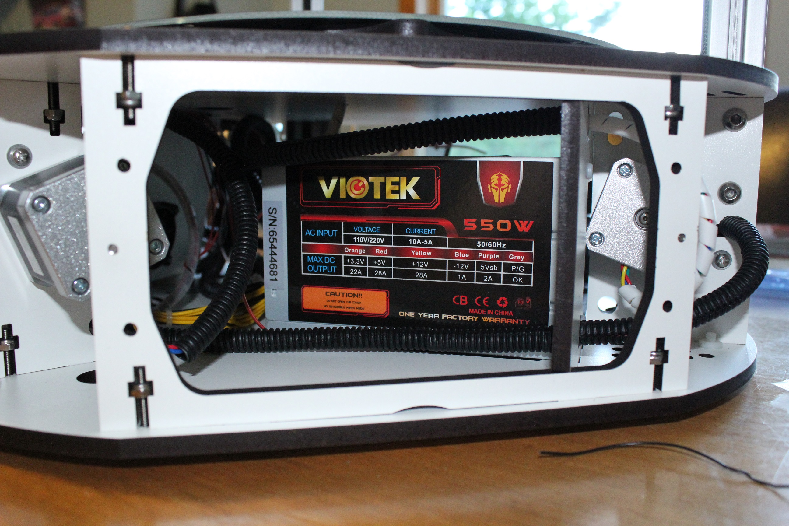

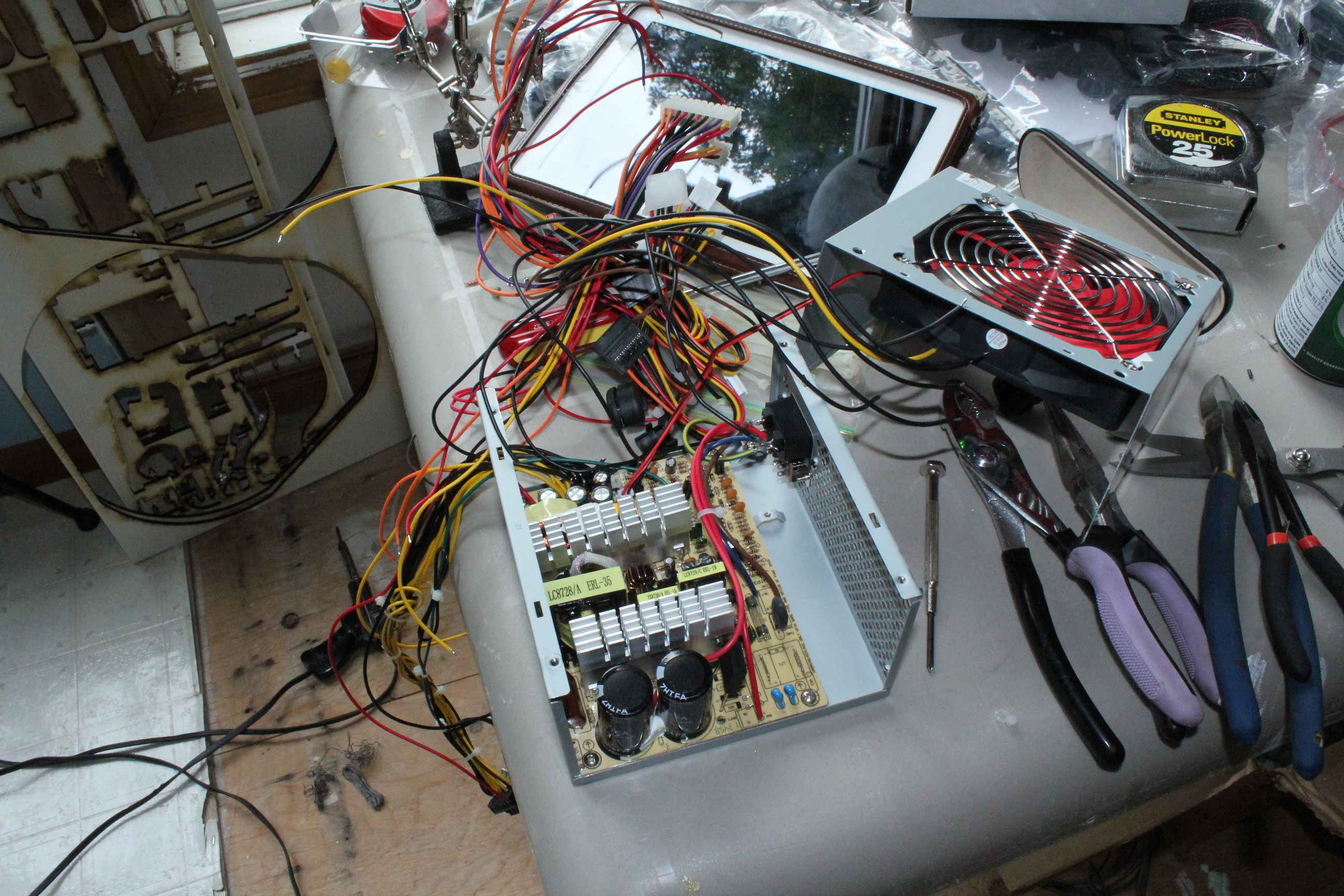

Very nicely built machine and you attacked the power supply as well, got to be the way it's done. Wiring looks really neat tooHoly1 wrote:Here are some pics of my build. It went together well with no problems.
Bob
Tinyhead wrote:Very nice! Congrats on the build. Any separation on that large an ABS print?
No separation.I had an enclosure around it (except for a quick pic).
I got the PEI last winter from amazoncritical_limit wrote:Where did you get the PEI Plate? The only source I know is amazon mentioned here in another thread. But I´m waiting now for 2 month without getting it.Holy1 wrote:Some careful calibration and adding some PEI pays off. Check out the level of adhesion and how close I can get to the edge. This is ABS at 225 with the bed at 85.
Thanx
Dirk
I got the .03 thickness in a 12x24 sheet. http://www.amazon.com/Polyetherimide-Of ... ywords=peiEaglezsoar wrote:A very nice printer build!

You can get PEI sheet off McMaster for ~$30. Found a nice 12x12 sheet that's 1/16" I think

You might be happier with a thinner piece. PEI seems to be a poor heat conductor, within reason I think thinner is better. Mine is 1/32 and if I do this again I may try a little thinner.
