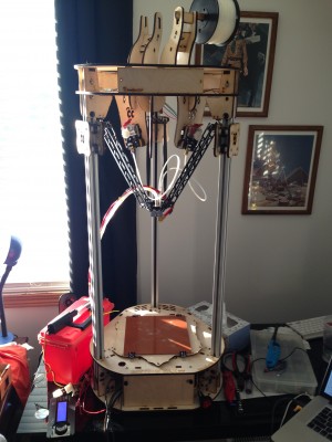

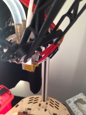

Don't have a lot of very good pictures right now, Ill take some more later and post them.
Latest Picture of the beast

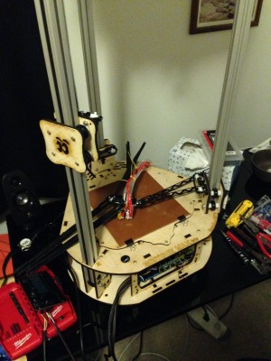

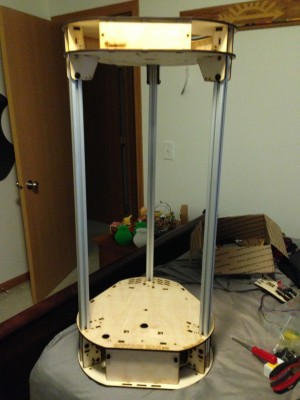

Completed base
Completed base

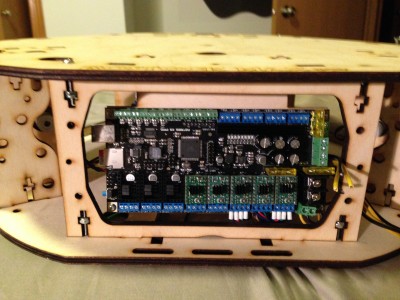

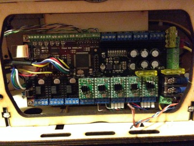

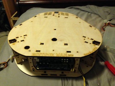

Azteeg X3 Pro mounted in place of the RAMBo
Wishful thinking
Wishful thinking
I have an Azteeg X3 Pro and Kraken to be mounted.
I modified some of the cut files to make space for 3 EZstuders mounted from the top, as well as mount the controller in the same spot the RAMBo fits in. I'm using a Prusa Heatbed Mk2A instead of the Onyx because of price and heat times. I'm getting a custom mount of my design for it cut out tonight. Other goodies to come

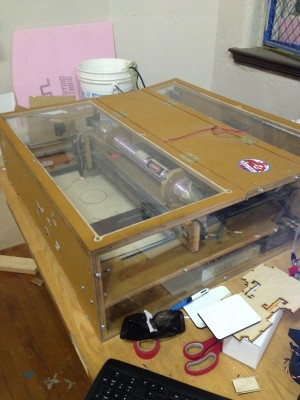

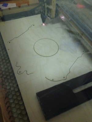

I was at my local Makerspace yesterday getting the bed plate cut out. Our 40W isn't powerful enough/calibrated enough to cut 1/4, so I had to use some 1/8" plywood. Counting on the glass to remain flat :D
Bed plate getting cut out
Lasers!
Lasers!
I'm going to mount the bed+plate tonight and do/redo some wiring now that I found my ferules. Waiting for some parts to come in from SeeMe, the bearing covers, then I can finish it and get it running.
I used MHackeny's Kraken mount, looks and works great, though I have no clue how I'm going do route the wires from the hotends to the silicone tubing. More pictures to come tonight!

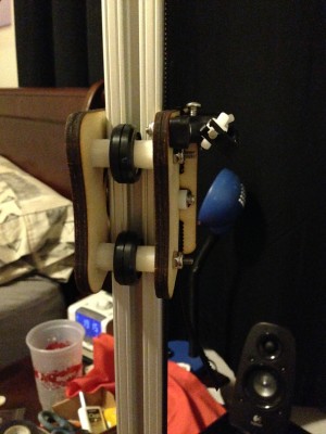

Some good news and some not so good news. I got all the cheapskates mounted, as well as the bed, and I've begun threading the belts :D
Cheapskates and Bed mounted
I used some printed spacers and cams, $1 per each one seems really expensive to me :/
Printed spacers
Printed spacers
Cheapskates with printed spacers and cams
They turned out pretty good, printed in Bridge. Work just like the injection molded ones.

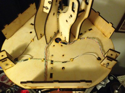

Also got some more wiring done/redone. Got the Viki LCD's SD card reader working too.
Azteeg X3 Pro wiring (ignore the loose extra extruder wires)
and the top wiring that I did a week ago
Top wiring all done, ready for LEDs

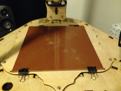

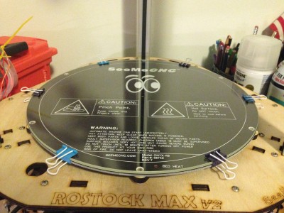

So now for the bad news;
I tried trimming one of the M3 bolts that I mounted my bed with with a pair of larger side cutters, but I couldn't generate enough force to cut through it, so I had to drill the top of the bolt off to replace it, but while drilling, it slipped and I ended up tearing a bit into the bed. The damage wasn't that bad, it didn't go all the way though, more of a scrape, but it was deep enough to completely cut off half of the power to the bed (MK2b dual power). Looks like I'll have to earn enough money for a new one :/
In the meantime I am using my garolite sheet I have, looks like my first prints will be in nylon. Oh well.
Garolite bed
Garolite bed

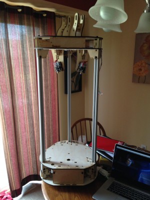

I thought I'd post some more pics since Ive gotten more done. Overview of what I've accomplished:
Most recent setup
Most recent setup

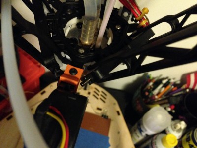

The kraken has been mounted on the effector since the day I got it, been anticipating this thing together for weeks :D
Top of the Kraken
Top of the Kraken
I only have 2 of the required 4 stepper motors for the extruders, so for right now I'll only have 2 running.
2 of the 4 are setup
I wanted the right EZstruder to face me, as to be able to see the gear turning/access to the gear to manually feed filament, so I have to route filament through the SeeMe eyes :D
Havent gotten to a print yet, still have to level the machine. First print will be in Bridge since the aforementioned bed break. Good thing garolite is so coolio.

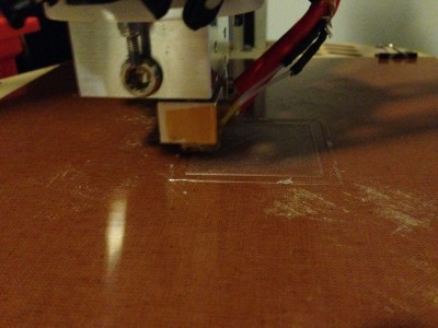

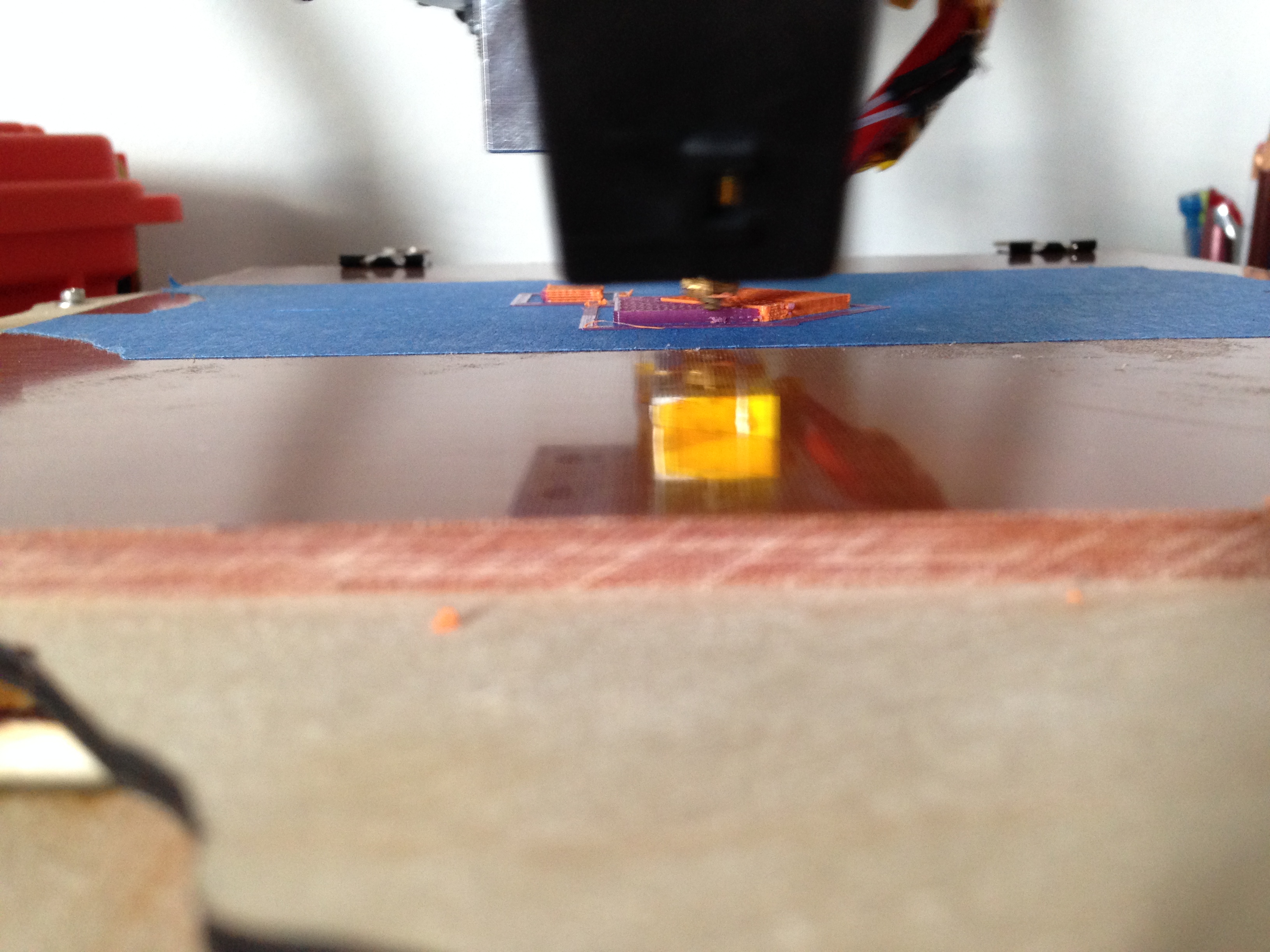

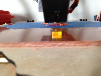

Got my first print done. Had to restart it once because it was a tiny bit too high off the bed. I'm going to get a dial indicator to accurately level the machine later, but for now I think it works fine. Bridge doest like sticking to Garolite as much as 618 and 645 it seems...
First layer
First layer
Finished Print!
Finished Print!
My bridge is a bit wet, so the pillars didn't form very well because of bubbling/warping. The top wasn't that great either, but considering it didn't slow down or cool head lift (new Cura profile, forgot to enable that, oops) it wasn't too bad.

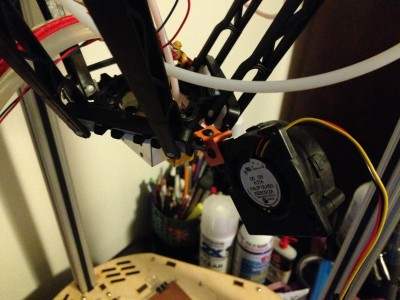

I finally bothered to learn OpenSCAD and I created this nice little mount for this Squirrel Fan mount.
Squirrel Fan Mount
Squirrel Fan Mount
Mounts the fan pretty securely, not a lot of flex (all things considering)
Alternate View
Alternate View
I plan to wire it up soon.
Re: Mike's Birch V2
Posted: Thu Oct 02, 2014 11:20 pm
by Nylocke

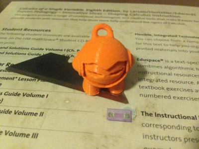

The fan works great! On layer 2 the temp drops a bit when the fan turns on, but only 5 degrees. I printed a Marvin keychain and it looks pretty great. A few minor (more noticeable at certain angles) misalignments, but that was because I was messing with the silicone tubing.
Marvin
Marvin
The picture doesn't quite do it justice. For .2mm its is beautiful. A few tiny tiny issues with it, but thats all material issues. I love this printer, and I'm very satisfied with SeeMe's design. Thank you John and Steve, and thank you Gene for making such a comprehensive build manual :D

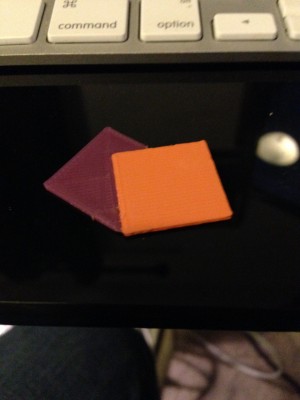

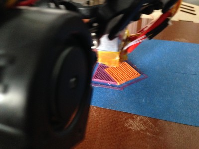

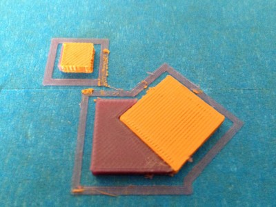

Doing my first dual extrusion tests today. I have Cura set up. Figuring out the correct retract settings as well as the proper offset values.
Dual Extrusion Print!
Based on whats printed so far, I think I have the offset values a bit off. I'm going to operate under the assumption that my primary (front right) nozzle is correct (probably isn't 100% but its what I wasn't to go on), so I must adjust the secondary (rear right) to the left a tiny bit, though I may be under extruding a tad, causing the gap.
Side View
Side View
Print+Wipe/Prime Tower
I'm going to try increasing the steps per mm on E1 and ill see what that does.
Re: Mike's Birch V2
Posted: Sun Oct 05, 2014 10:16 pm
by Nylocke
I increased the steps, and it helped, but it was still a bit off. I tried adjusting the X position of the second hotend in firmware in what I thought was the logical direction, negative, to what I thought would be the left. For some reason if I decrease the x offset, it seems to move the E1 part farther from the E0 part. This seems backwards to me, but after increasing the value, it seems to be right in the right spot. Confusing to me, but who am I to argue with results. Maybe when I add the other 2 nozzles to the mix things will make more sense...
One Continuos Part :D
Alright, I have a dual extrusion setup :D

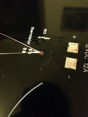

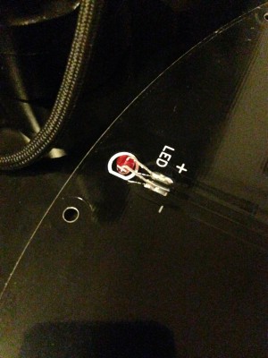

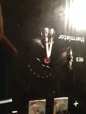

I ordered the Onyx Rev7 and it arrived today. Got it all soldered and everything and I mounted it on my machine.
Soldering the Thermistor
I had a spare EPCOS 100k thermistor laying around so I used it (its larger and the leads are thicker) instead of the included NTC 100k thermistor.
Thermistor in place
Thermistor in place
I miss the way they did R3(?)-R6, with the 2 LEDs. I liked the hotend status LED. Oh well.
LED in place
LED in place
All mounted up
All mounted up
Its all mounted up! I still have to plug everything into the X3 Pro, which I will do tomorrow night. Looks pretty nice, though now I am really nervous about breaking that glass... Garolite is nearly indestructible on a 3D printer, and slamming the hotend into it wasn't horrible (not that I've ever done that...)
