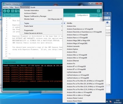

... Continuando con el problema de que no consigo modificar el firmware de la tarjeta RAMBO, esto son los errores que me devuelve cada vez que lo intento:
avrdude: stk500v2_ReceiveMessage(): timeout
avrdude: stk500v2_getsync(): timeout communicating with programmer
La comunicación se produce, puesto que veo que se efectúa el reset en la tarjeta RAMBO, y tambien lo puedo ver en el display. Por cierto la version que tengo de firmware es la 0.80

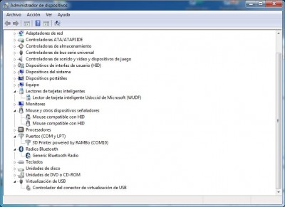

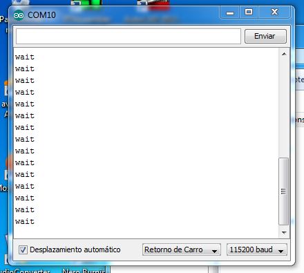

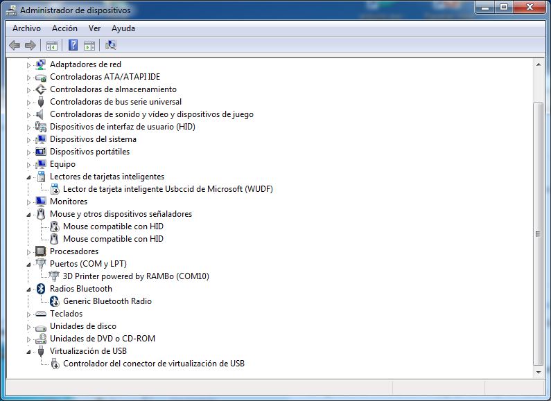

Only a update from my last communication...
I have attached a captures from my desktop. You Can see that Serial monitor is reading from Rambo board, also I have included the Rambo Board in the board selection menu, and last I have changed comm port to 10.
Without progress...
conclusions:
Arduino communicates with the Rambo board, but despite selecting the right kind of board, the protocol is not correct, or the board Rambo rejects any updates. Can this be a measure of protection?
Serial Monitor working
Board Selecction Updated
Device Manager Capture

Are you sure its set to 115200 baud rate? I thought the default config was 250000. I saw that in the serial monitor its set to 115200.
Oscar
Posts: 24
Joined: Sun Jun 30, 2013 7:23 am
Re: Primeras impresiones con Rostock Max 3D V1
Post by Oscar »
250000 bauds is the default speed, and yes I change with LCD to 115200. If not, we can't see anithing intelligible in the serial monitor.
