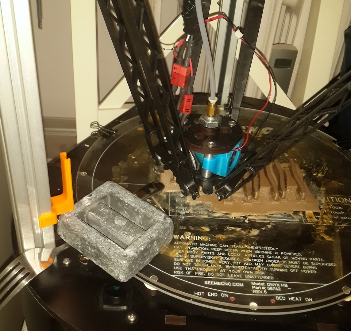

I am still waiting for my PEI bed to arrive and I have never had good adhesion to the bed.
Last night i was printing something and i noticed a corner star to lift (i have a 9mm raft) and i fixed it like this:
It is a fork and a diving lead weight. The fork has a nice curve so it has almost a point contact. Weight is 1 kg ~2lbs.

Nice! I have done similar, red neck style sorta.
I've also resorted to a quick duct tape hold down that works well too.

I use CA, the hobby grade thin stuff.

CA?
Posts: 1407
Re: My quic fix for a lifting corner
Post by Mac The Knife »
teoman wrote:CA?
Super Glue,,, http://en.wikipedia.org/wiki/Cyanoacrylate
