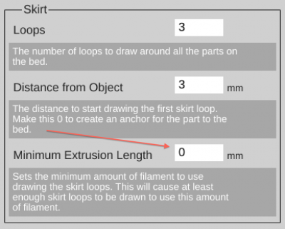

There is a setting in the mattercontrol where you can specify the minimym lentgth of the skirt.
You can manually extrude a bit from the extruder while the nozzle is warming up. Or as you have already found the number 4 inches, you can plug that in to the software.

Accordingly, I need to prime the nozzle before the print. Usually I do that from the host software: let everything come up to temperature, do all my settings fiddling, and right before I start the print I either manually push filament down or use the extrude button on the control panel to push filament until it starts squirting from the nozzle.
Most of the time it still takes a few centimetres of travel before filament appears on the print. So a 5cm minimum length or 3-4 loop skirt is handy.
