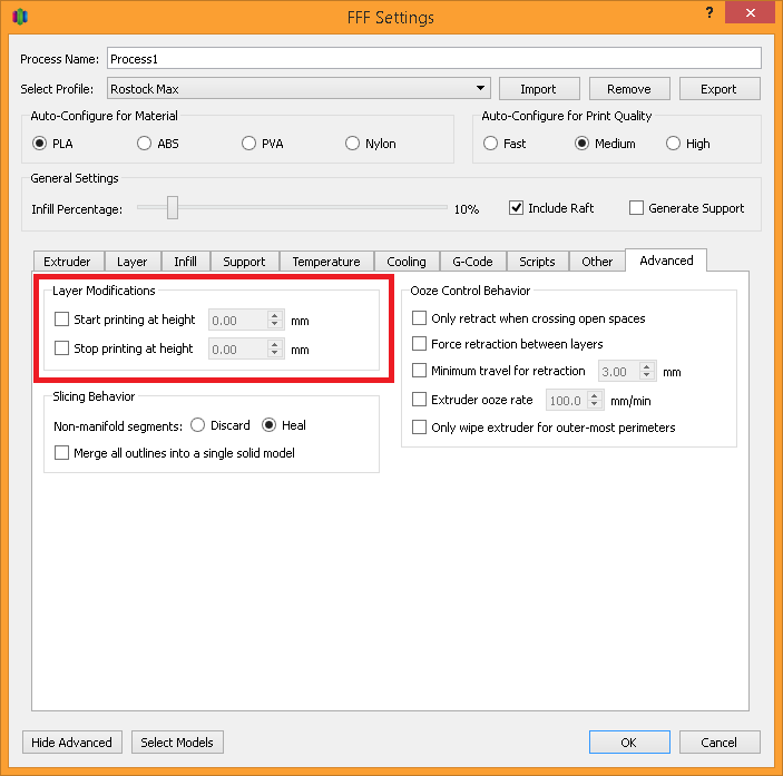

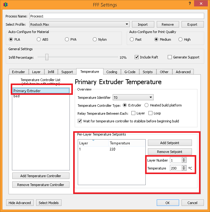

I am have a problem with setting the BED and Nozzle temperatures. I have set up to print PLA. No bed temp and nozzle temp @ 205. It starts out right but switches to ABS setting in just about 1 minute. 100 deg bed temp and nozzle @ 230. Can't figure out what I am doing wrong. Any suggestions would be appreciated.

The g-code for your print has some lines in it to alter the temperature. The slicer you are using probably has settings configured to use your 0/205 settings for the first layer (or maybe more than one) and then change to 100/230. If using Repetier Host, I think the adjustment is in slic3r's "print settings" configuration tab.

make sure this is all unchecked
make sure you only have these temps set and a single layer selected
