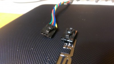

But what if I am planning on swapping out the hot end in the future? The e3d seems to be the most popular hot end to go to after everything is assembled. Are the connectors "LP" connectors that were provided used for anything, because the ones which I received are not appropriate for a quick disconnect as they are the exact same connector. attached is a picture of what i am talking about.
One the left is the NEMA motor connector, on the right is the connector that is supposed to mate with it?

vaderj wrote: One the left is the NEMA motor connector, on the right is the connector that is supposed to mate with it?
No. The connector on the left (attached to motor lead) gets plugged directly into the RAMBo, except for the motor on the EZstruder. For the EZstruder, the plug gets cut off and the wires are spliced to the #22 wires in a standard build. This is shown on pages 146 + 147 of the manual. Eventually, you'll take one of those connectors (like the one on the right) and attach it to the other end of the #22 wires (covered on pages 190 + 191).
The extra "LP" connectors can be put to use IF you choose to install quick disconnects. The mating connector is available from the source listed on page 9. Instructions for the QD options are in Appendix A, which begins at page 266.
