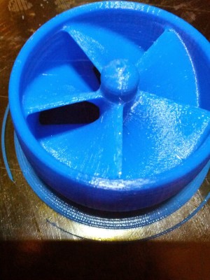

Uncleaned part still on th plate
So I read the entire "weed trimmer" line thread several times and gleaned a lot of useful info. I am making beautiful blue prints with it. I love the stuff. Cost per pound is very reasonable. Yes you have to dry it and keep it dry, but these forums gave me all the knowledge I needed for that.
Only problem is, did I mention it is blue. Unlike Cope413, I don't see me cncing out 30 pounds of the stuff all in blue.
For those unfamiliar with the topic, blue is the color code for .065 inch trimmer line.
My whole reason for this post is to get enough people exited about nylon that we can create enough of a market to make it viable for Desert Extrusion to extrude some more colors including natural.

Damn those are some good looking prints, would you mind divulging your settings and nozzle and such?

DavidF wrote:Damn those are some good looking prints, would you mind divulging your settings and nozzle and such?
I'm at work today but I promise settings and pictures of my dry box setup tomorrow.
Also, what are you printing on? Looks like a sheet of PEI based on the yellowish tinge, but wasn't sure.
Re: Desert Extrusions Nylon
Posted: Mon Oct 06, 2014 1:30 pm
by Nylocke
Probably a sheet of Garolite. Nylon sticks nicely to it.
TRIMMER NYLON
260C Extruder
80C Bed (I am currently using 75C for the bed per Cope413 settings.)
gluestick (UHU because I had some.)
E3D Hot end
.4 mm nozzle
.2 - .4 mm layers (rook was .2 wheels were done at .2 .3 and .4)
6mm retract eliminates just about all of the spiderwebbing. COPE413 uses 12mm if I remember right. He uses a larger nozzle so that makes sense.)
If you need anything out of my slic3r settings, let me know.
Let them hydrate. Nylon gets tougher after it absorbs water. One of our injection molding techs told me several stories about his experiences. At one of his former jobs they would "simmer" parts at 90C for an hour. Living in Florida I just leave them on the back porch if strength is a concern.

Mac The Knife wrote:Looks like Kapton to me.
Kapton tape is on the flip side of the glass. I have UHU gluestick on the top.
