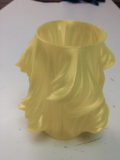

vase is pla at 190 and 60

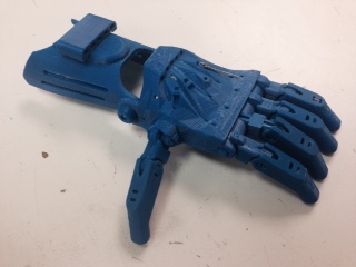

hand is abs at 225 and 90 .25mm layer

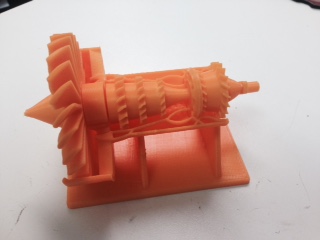

ge jet engine is abs at 225 and 90 .2mm layer
