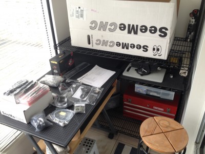

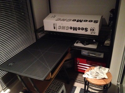

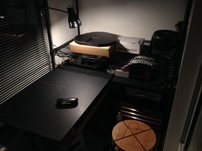

Rostock MAX V2 (circa Sept 25 2014, Rev7 heatbed)
So, here we go.
Oh, hi.
Oh, hi.
The next morning.
The next morning.

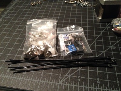

I like crimps and stuff.
Hot end powa!
Hot end powa!

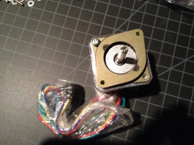

Extruder motor extension, fans and hot end thermistor.

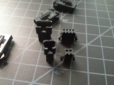

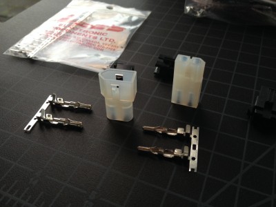

So I decided to go with a separate large two-pin connector for the resistor heaters and a smaller two-pin for the thermistor. Mostly for reasons of wire gauge. I decided to go with smaller 22g wire for the hot end thermistor instead of the supplied 18g.

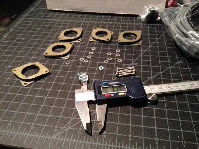

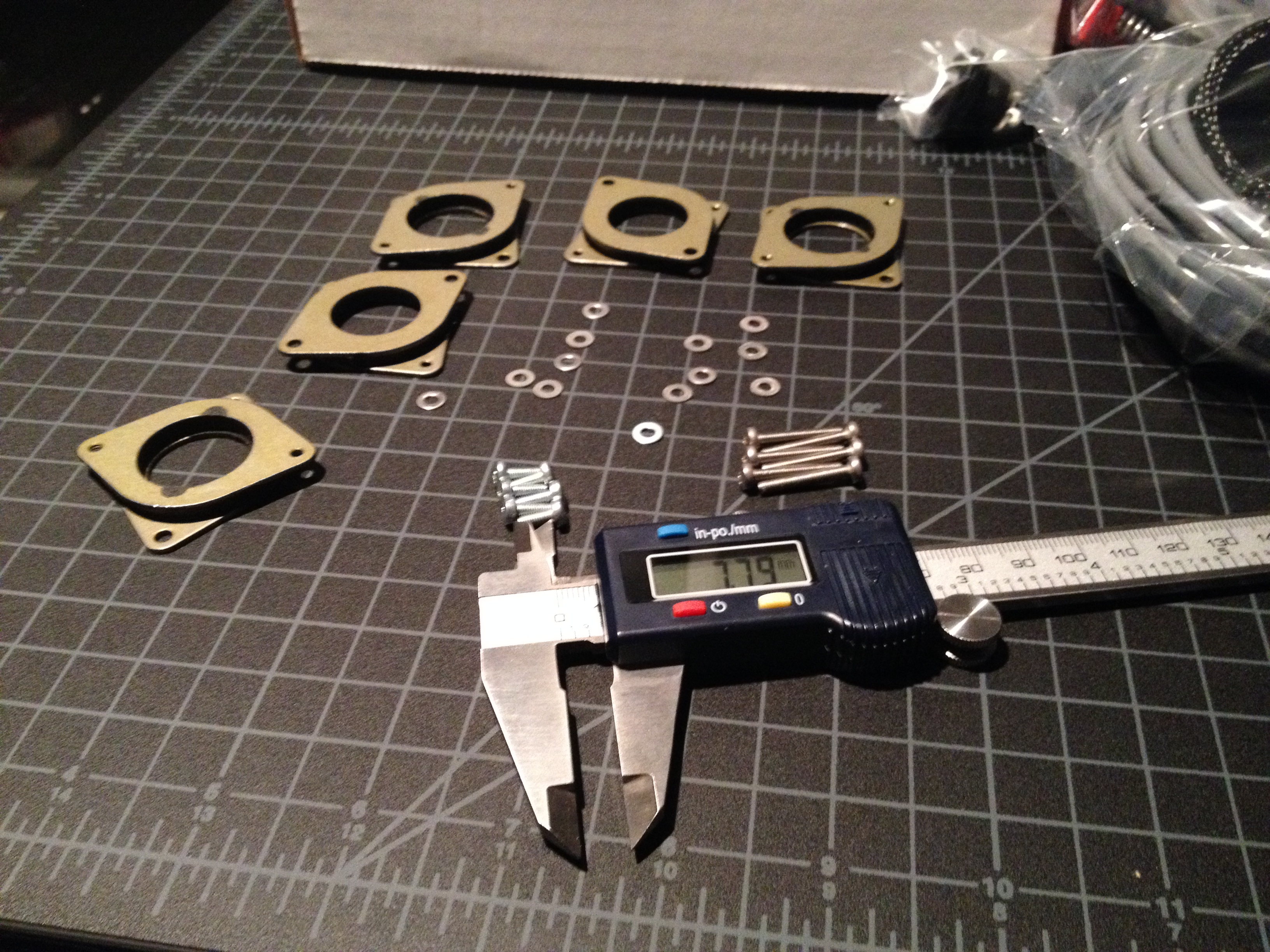

Some of you might have noticed these bad-boys in one of the previous photos:
Dampaaaaaaaaaaaaaaaaaazzzzzzzz!!!!11

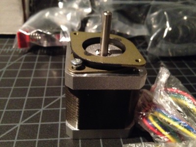

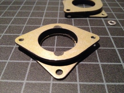

Astrosyn MY17RMDAMP Vibration Dampaaaaaaaaaa--ahem, sorry. Dampers.
Perfect fit!
Perfect fit!
Errrr... I said perfect fit, damnit.

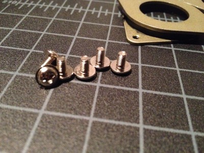

For some reason I thought these 8mm M3 screws would work. I was about to file them down, or cut some of the longer ones I had with a hacksaw... stainless steel hardware isn't exactly easy to file.
DOH!
DOH!
But just after taking the first two strokes of the file I remembered I had some M3 hardware in a little packet that came with my PC motherboard way back.
Thank you, MSI!
Thank you, MSI!
Thankfully I checked before I wasted several hours filing or sawing stainless steel hardware...

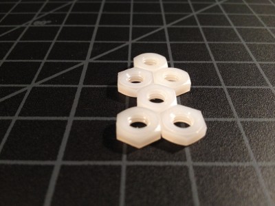

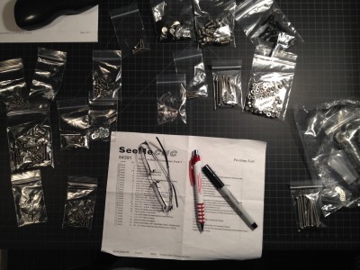

I actually had so many of the perfect size (or close enough) M3 screws to choose from. I even got these cool ones with a huge flange for a more, umm, flangeful grip. Yeah that's a word.
You magnificent little bastards.

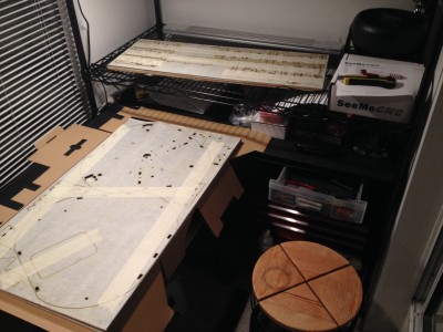

And now the task of removing all the laser cut pieces from the sheets and removing the masking material. I was absolutely dreading this step because I had been told how arduous, smelly, dirty, annoying, and finnicky it was.
Not a pain at all!
Not a pain at all!
I don't know what everyone was talking about! It was suuuuuuuper simple!
A cinch!
A cinch!
And just like that it was done. Yup... just like that. Absolutely fucking simple.

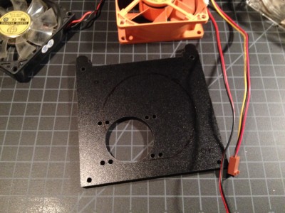

I'm gonna use these otherwise scrap pieces to make a fan mount/hole cover!

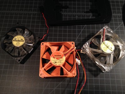

Salvaged from the computer junkyard (my closet).
A crazy idea...
A crazy idea...
So this is actually one of the most powerful PC fans I've ever used, and it's only 80mm. It's also variable speed: from silent to hurricane.
Yuuuuuuuuuuup. That's all for today.

I think the PS fan is "upside down" to assure that air is drawn from inside the base and pushed out through the rear grill. If the fan is facing the bottom opening it may be exhausting outside air from the bottom opening to the outside trrough the rear grill.
Could be wrong here, I also added two 80mm fans in the rear side panels to keep the heat down since the fan on my corsair 750 was rarely running more than an idle.

Nitewatchmen, you're right. The fan normally does transfer the hot air from the underside through the psu. This is what I'm trying to avoid. The fan on the psu is designed to bring ambient air in, cool the psu, then exhaust right out the back.
I guess it wasn't clear in my photos, but I'm adding two fans that exhaust out the back panels to replace the loss of airflow. As I sai din my previous post, I suspect the orientation of the psu is calling the premature failure people are having. The ambient operating temperature the unit is rated for is not very high.
Teoman, good thinking. I'll cover all the holes with tape that could transfer air from the underside and cool the heat bed.
