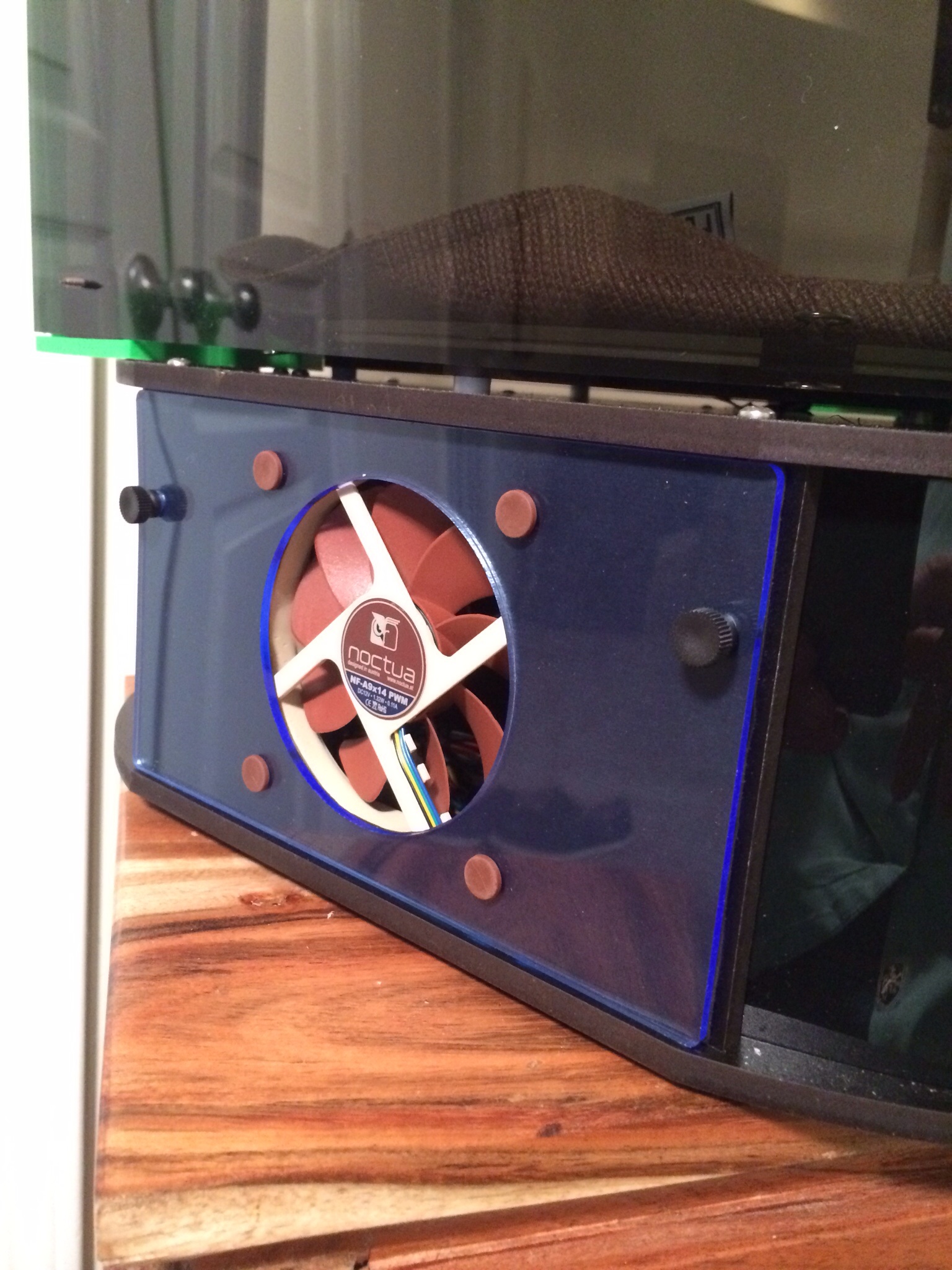

I went with a 92mm side fan. I had access to someone with a laser cnc that helped me do some customizing. The fan just fits in the normal side opening.
Re: Side panel w/ fan
I like that acrylic piece a lot. I think I'll have to do that!

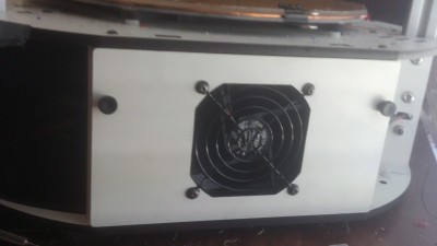

BONE wrote:Looks nice, but why not just drills needed for the fan opening and mounting in the original piece?
Because the plastic coating on melamine tends to chip and flake and looks crappy after you cut it.
[img]http://i.imgur.com/Z9k8f0k.png[/img]
[img]http://i.imgur.com/v1U4ik4.png[/img]

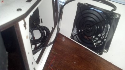

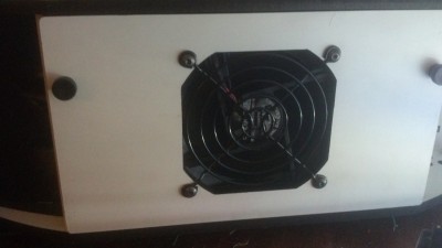

Cut and drilled mine using an end mill (think router cutter), chipping is not too much of an issue.
Mounted 2 90mm 5VDC Fans.
