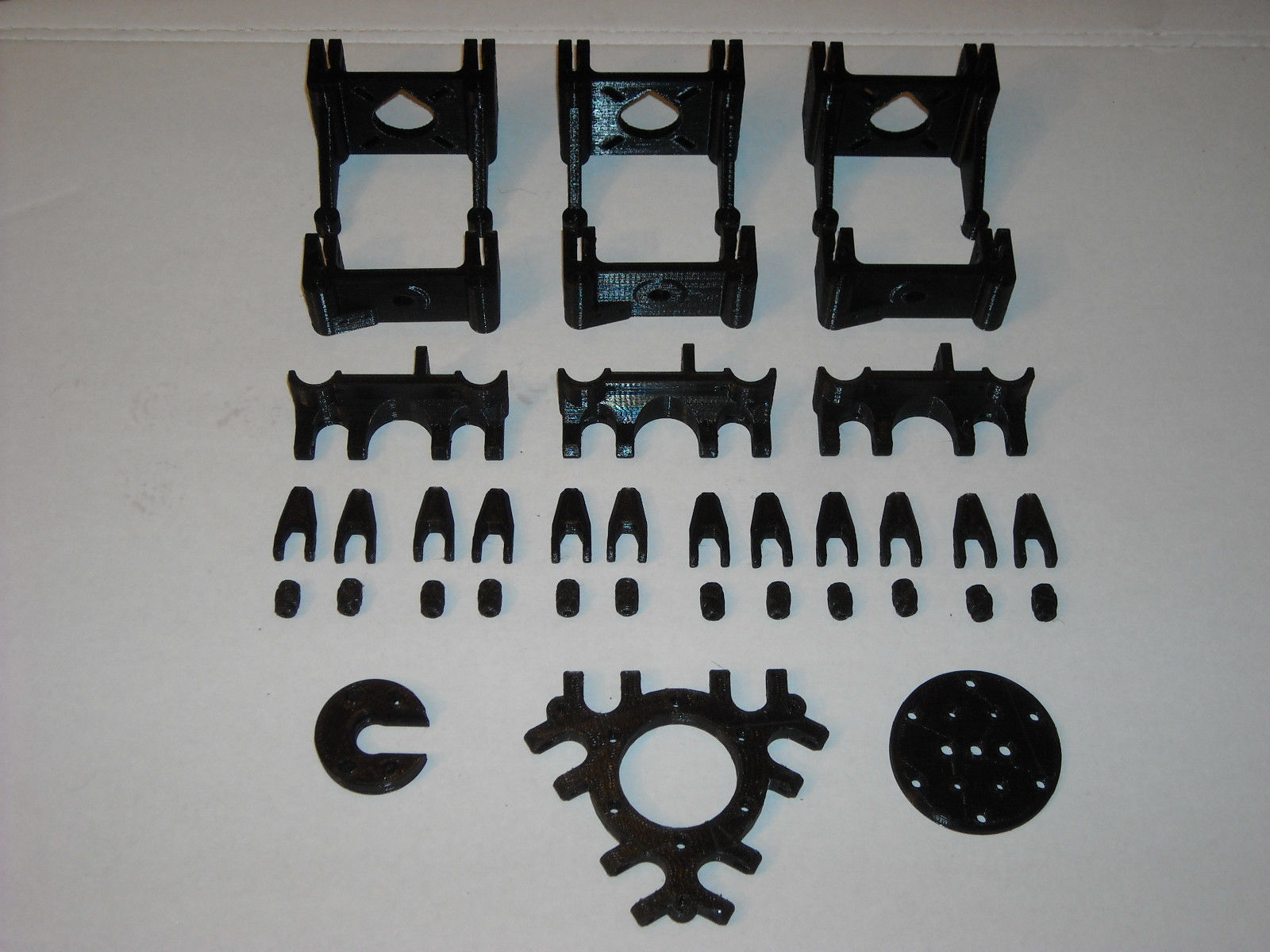

I started with some e-bay PLA rostock parts.

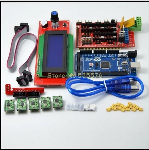

Then I purchased a ramps/lcd/mega combo.

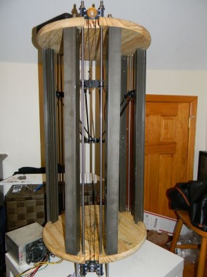

The result so far is a rather larger rostock derivative I named TUKI. The name is just a pet name. Which also happens to mean Parrot in Hebrew, I had no idea it meant that but I will take it.
During my build I have gone through a bunch of tweaks, like aluminum arms, which will soon be replaced by proper carbon fiber rods, and ball joints from traxxas. They will also be replaced in the future with high precision ball joints.
Here is what it looked like when I finished the frame. Its was all I could do to try to keep any sort of precision. So far it has worked out.
[img]http://engineerd3d.ddns.net/content/ima ... 1852-2.jpg[/img]
