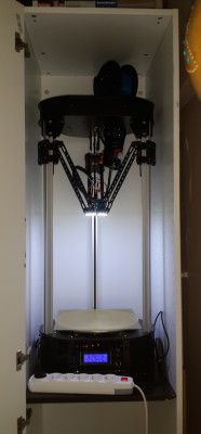

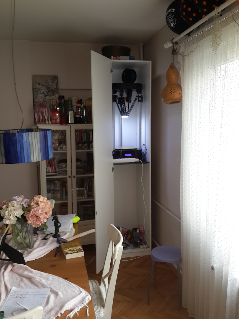

So this is what i did: i went to the IKEA junk section where they have the display items for sale. The cupboard was in pretty bad shape with chips everywhere. I got it for a little over 50 usd. I had to dismantle it by myself and while doing that i said to myself i should have paid the 150 usd they were asking for it to save the hassle. Plus the wife was not happy that the lid was so badly scratched. But i can deal with that later on.

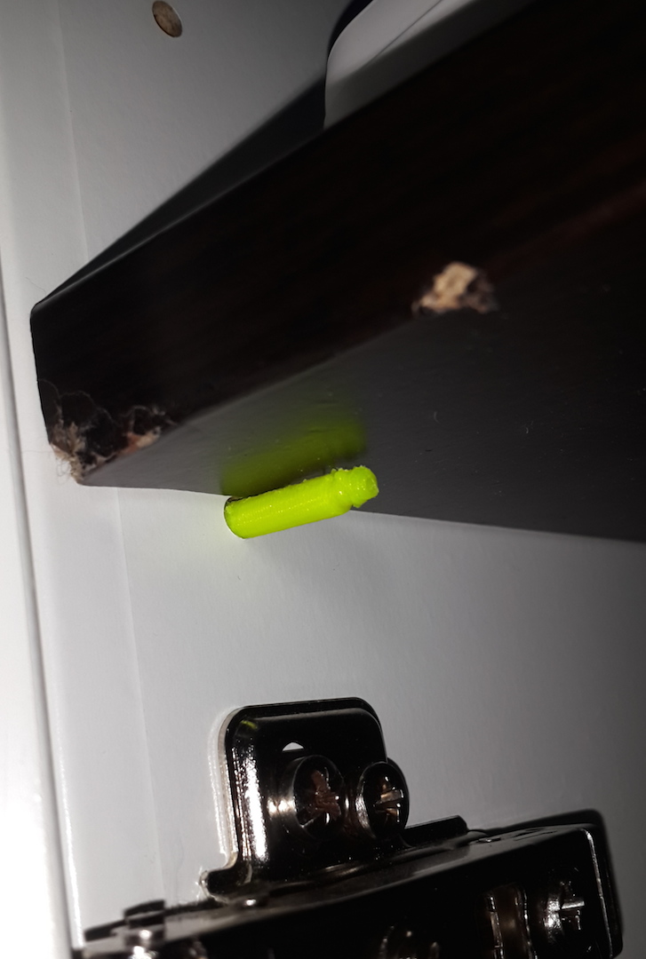

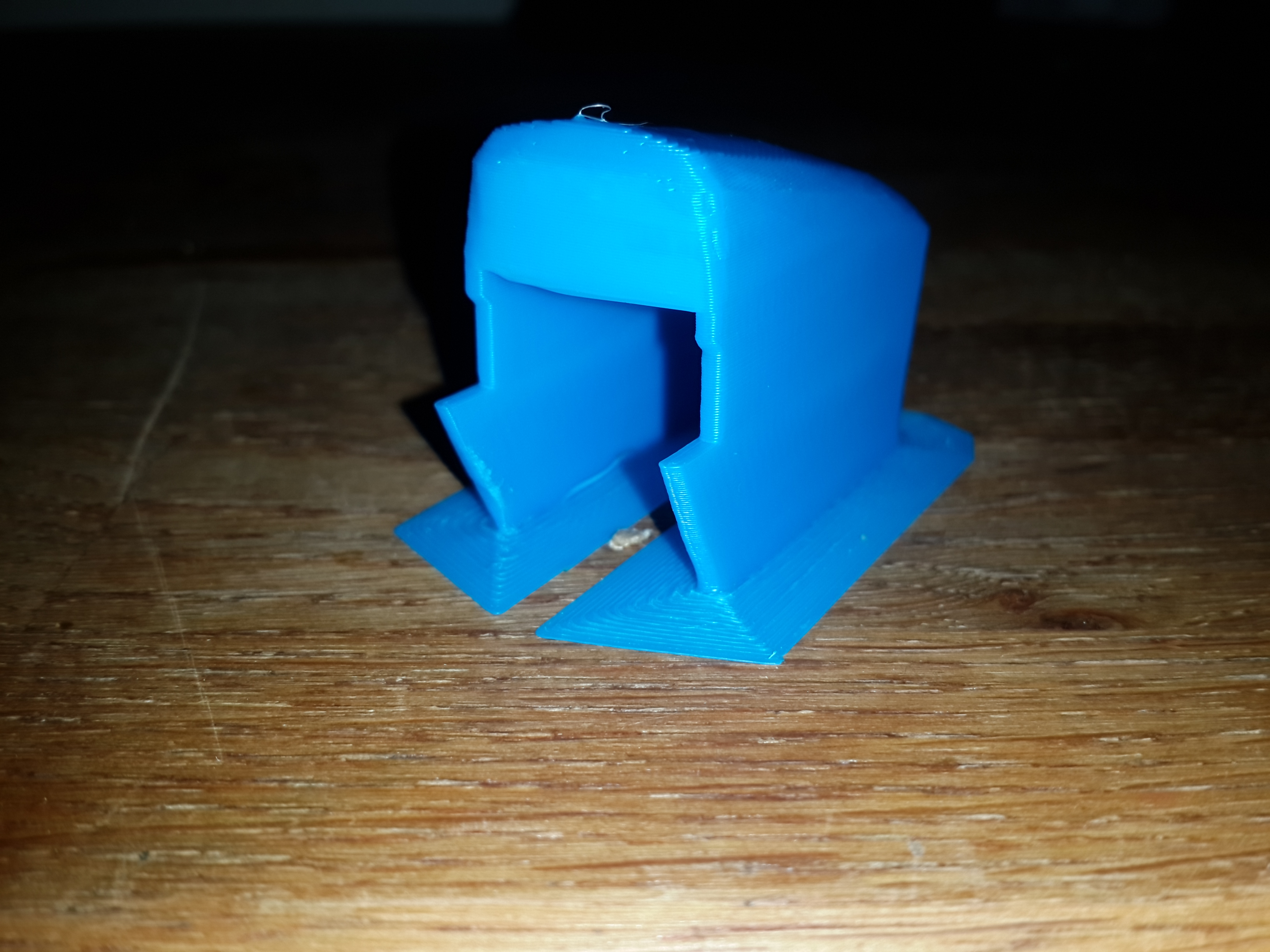

It had some parts missing, luckily i have a 3d printer so that was not a problem :)
The shelf was in pretty bad shape but it only cost 1.5 dollars.

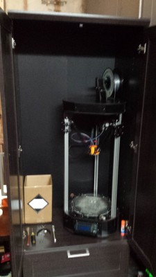

Closed
Closed

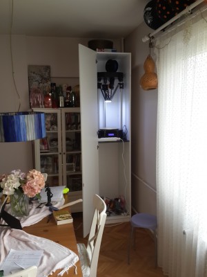

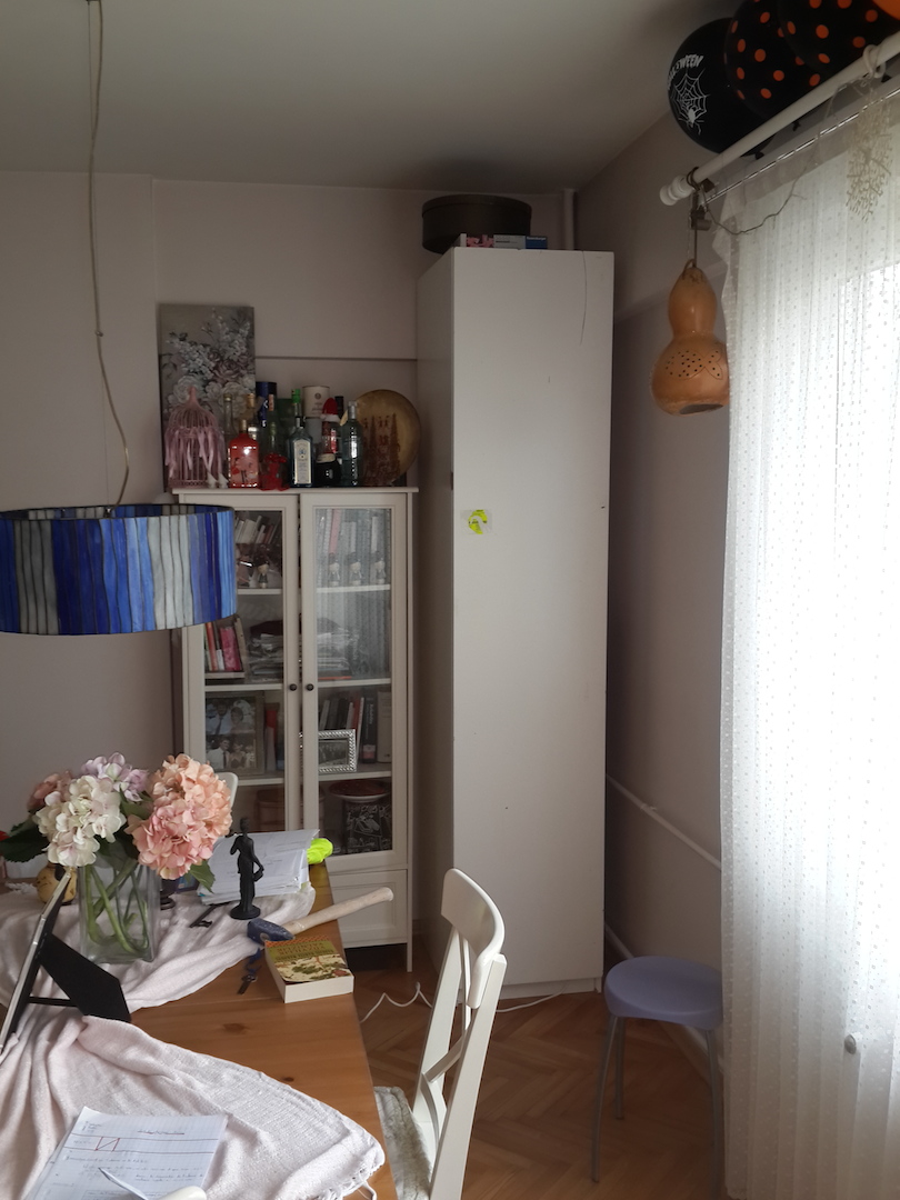

I assembled it when i got back home and found a corner to stuff it in the living room.
I moved the machine in to it
Opened
Opened
Fits nice so far.

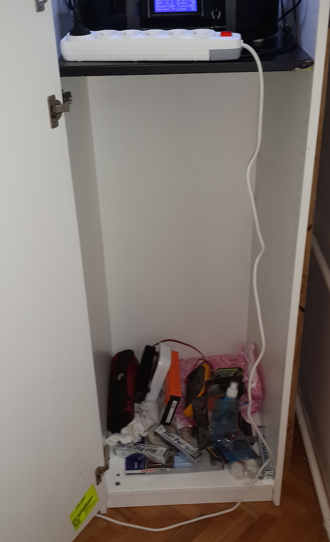

With space for junk below:
There is enough space to be able to fit thin insulation foam.

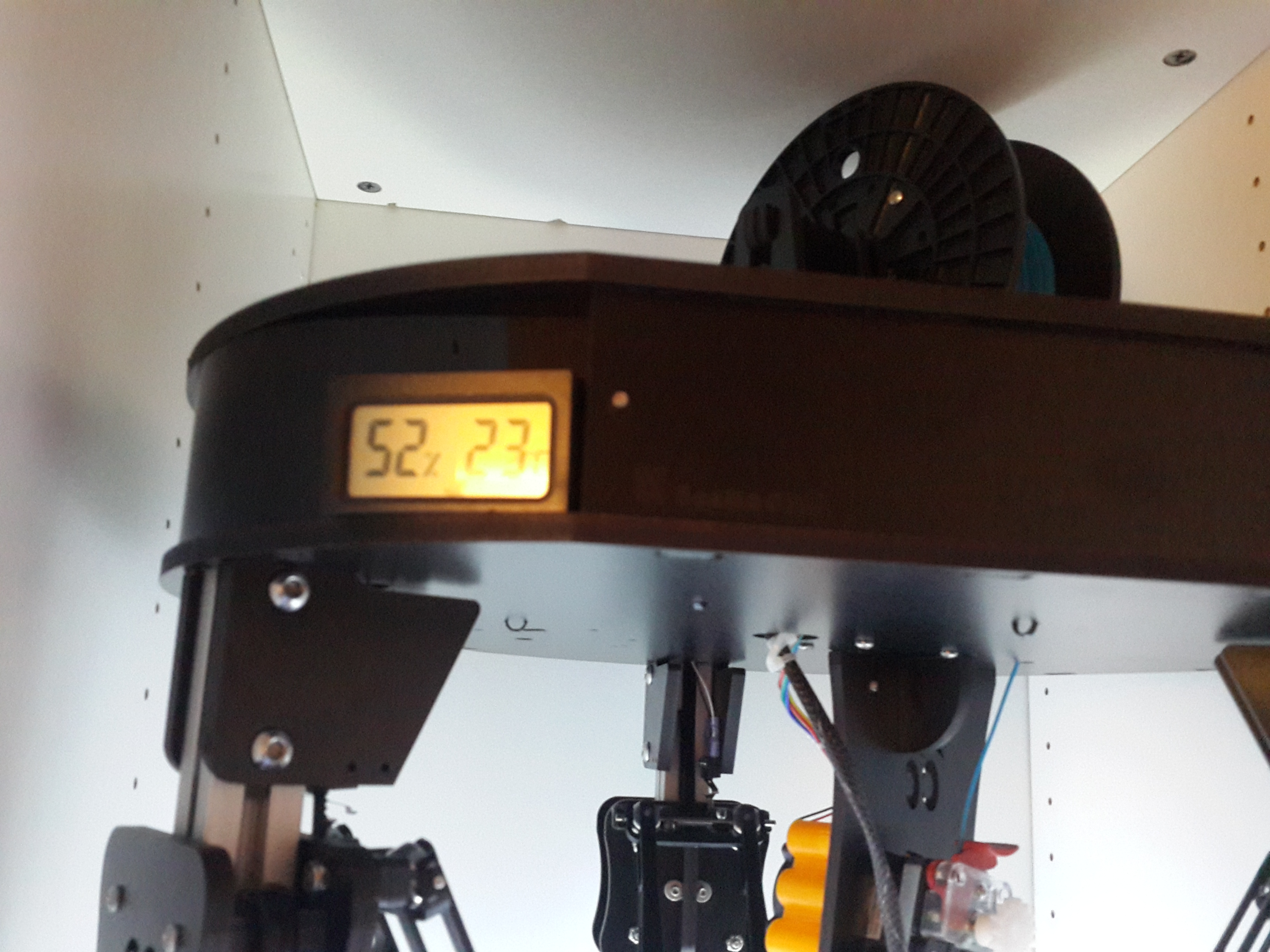

I'd suggest some way of monitoring air temperatures inside the closed cabinet, especially at the top. You don't want your spool of filament to be above the glass transition temperature, or it may soften enough to not feed properly. You may find you need some kind of circulation fan or venting.

Thank you. If it does indeed get too hot i have several ways of cooling it down, preferably without creating a draft inside the machine.
I have a thermometer and humidity meter inside to monitor the temperature. Microcontroller based versions that log the temperature and control it are in development.
I have acquired information from this forum that 50 degs is about as high as you should go for the cheapskates roller bearing covers.

And I am getting beautiful prints now! I am amazed how much of a difference it has made.

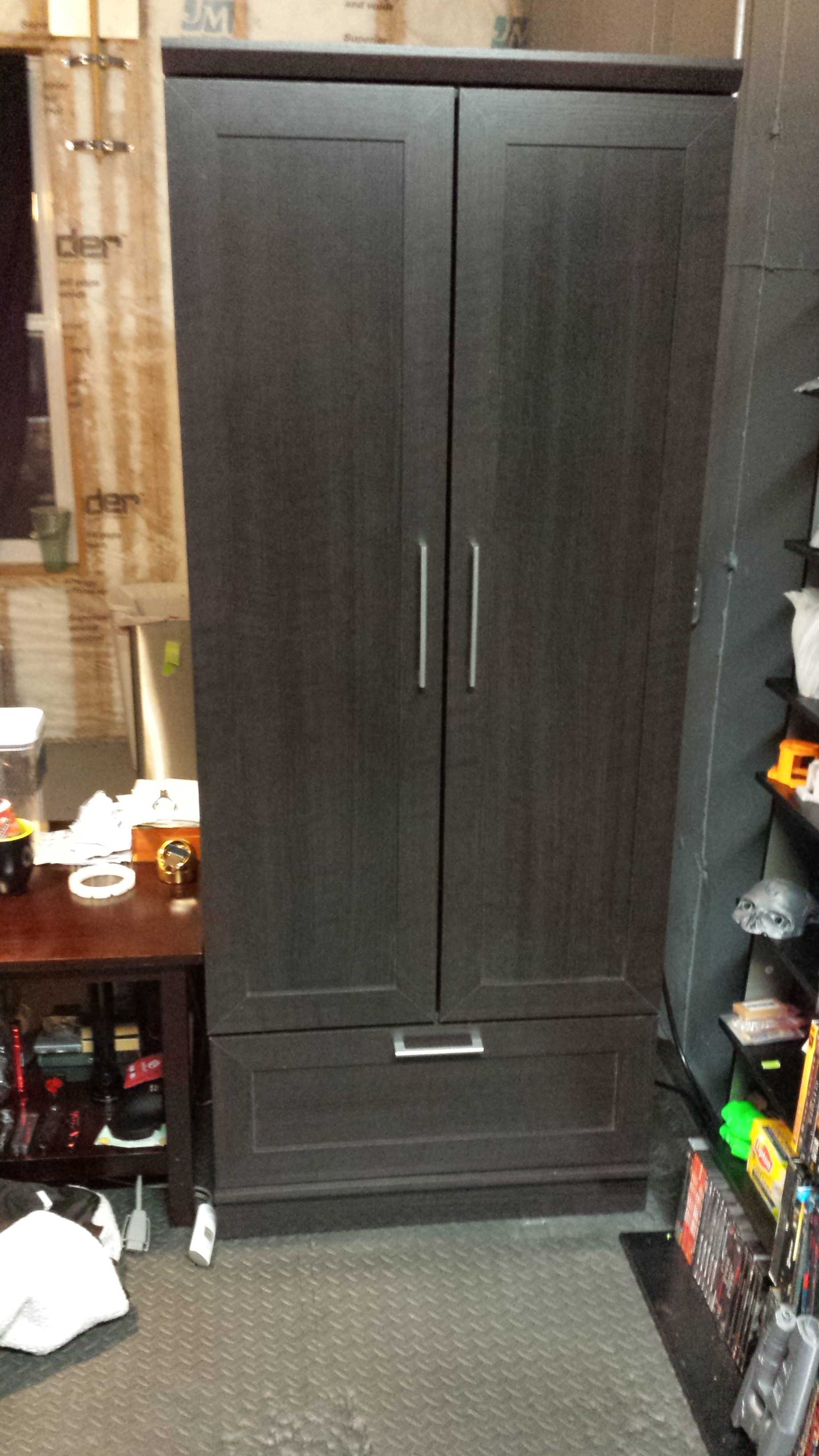

I'm fairly certain the max will fit inside one of these.
http://www.ikea.com/us/en/catalog/produ ... #/70240332
The bottom shelf is steel, so popping a couple holes for fan ducting for the electronics should be fairly easy. You could then pop a small hole in the top for filament.
