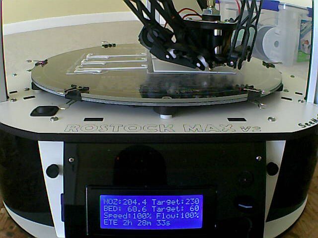

A few more details: the temperature graphs in Repetier-Host are showing a steady output of 100% so I don't think it's a PID issue - seems like the controller knows it's supposed to be hotter and is doing its best to make it happen.
Here's a screenshot of what I'm talking about in the middle of a print: temp set to 230, machine can only hold 205. But at the start of the print it did manage to hit 230.

Ok, I did some testing with a multimeter and I think I might be fighting with an underpowered power supply... but I'm not sure. Are these readings normal? There is some drop, but it's just on the edge of what I would call significant.
Measured at RAMBO input:
Printer on but idle: 11.8v
Extruder heating: 11.7
Bed heating: 11.3v
Bed and extruder together: 11.1v
Measured at RAMBo extruder output:
Extruder heating alone: 11.5v
Extruder heating with bed: 10.9v
Measured at RAMBo bed output:
Bed heating alone: 10.9v
Bed heating with extruder: 10.8v

I'm thinking now that the thermistor is getting cooled by airflow.BenTheRighteous wrote:A few more details: the temperature graphs in Repetier-Host are showing a steady output of 100% so I don't think it's a PID issue - seems like the controller knows it's supposed to be hotter and is doing its best to make it happen.
[img]http://i1188.photobucket.com/albums/z40 ... 155510.jpg[/img]
1. In picture, you're printing ABS. I would not expect it to extrude well if the nozzle was actually only at 205. So thermistor is showing a lower value than nozzle is reaching.
2. In picture, the layer fan looks to be on. Leave it off for ABS! Thermistor may be cooled by the layer fan.
3. In picture, if Z tower is 12 o'clock, PEEK fan appears to be at 8 o'clock position, correct? Where is thermistor on the clock face? Ideally it is on same side as PEEK fan, so that PEEK "exhaust" air doesn't reach it.

Based on his bed temp I'd assume that was a PLA print.

Maybe. I print PLA on a 40C bed. Over 50C the bottom layers don't stay flat. I've not had any PLA that got friendlier above 215C so a hot end target of 230C seems odd for it.bot wrote:Based on his bed temp I'd assume that was a PLA print.

Actually yes, it's PLA! I know 230 is pretty dang hot for PLA, but I did some temperature testing and with the filament I have, 230 produces the best prints. Printing at the 190 range produced parts that easily broke apart by hand, 210 range produced parts that were difficult to break by hand, and at 230 I had to use tools to break them apart. It's from MatterHackers if anyone is curious.
Earthbound, my thermistor would be at 5 o'clock in that picture. It's possible that it is being hit by the air from the layer fan after it bounces off the print surface - that makes a lot of sense actually - it explains a lot of what I've been seeing.
- Before the print starts and the extruder is heating, the layer fan is not on, so the extruder can reach temperature (albeit slowly)
- Once the print starts and passes the first few layers, the layer fan turns on. Explains why after awhile I see the temp drop to around 205.
- I noticed this morning that doing a print with tall columns, the issue is much less pronounced. Extruder is at 225/230. My theory is that with the extruder being so high in the air, there's nothing for the layer fan air stream to bounce off of and it misses the thermistor.

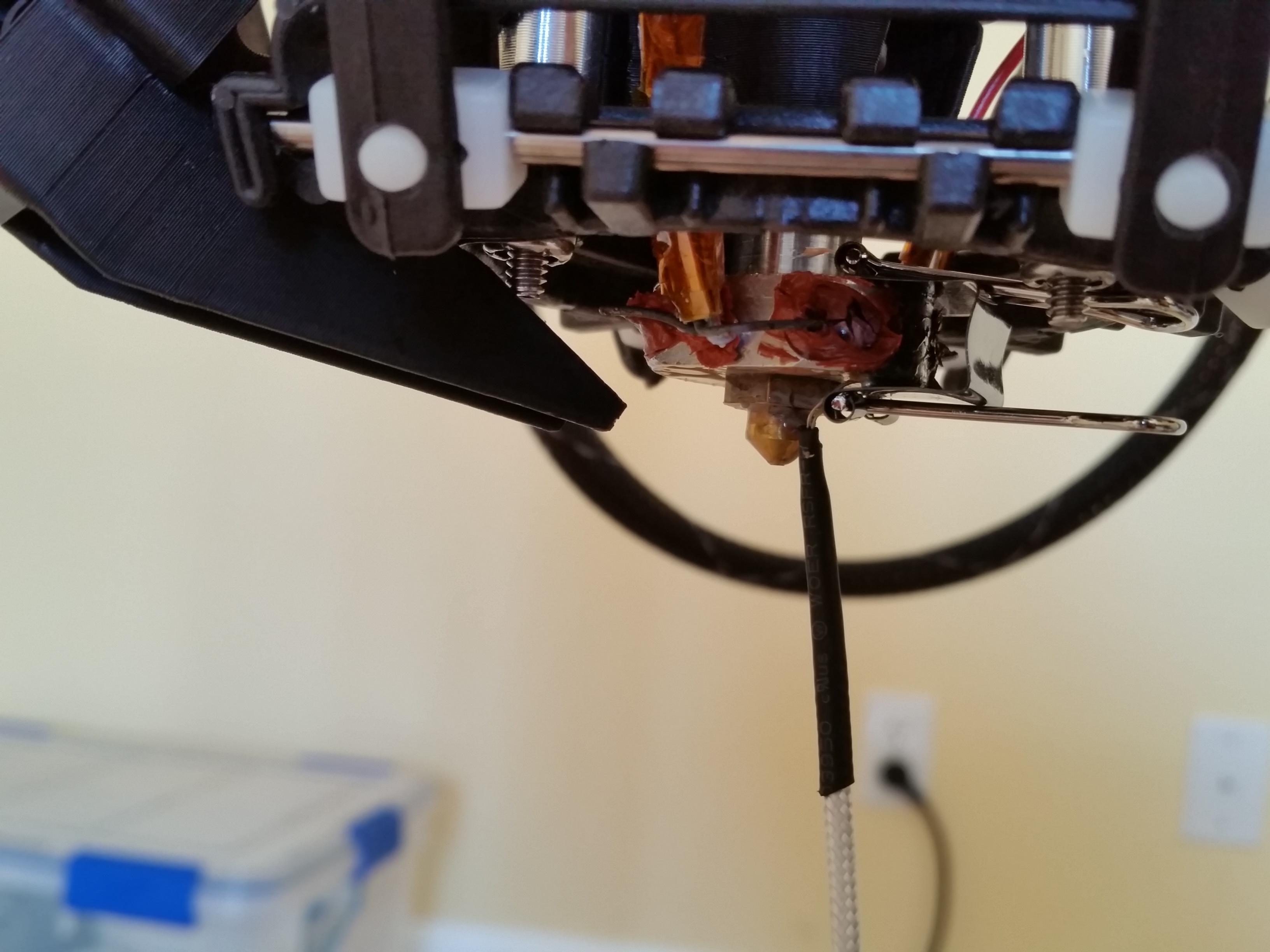

Could you try wrapping the hotend with kapton tape?
That remedied my problem.
And if you notice an immediate positive outcome we can say that your problem was heat loss. If not, you may have some more serious issues.

I repositioned my layer fan so that the airflow wouldn't bounce back toward the thermistor, rerouted some wires, and recalibrated the PID settings. I'm hoping that was sufficient; I'll report back here when I have some results!

I rerouted some hotend wiring, checked for accidental heat sinks, made sure the thermistor was seated well, and adjusted my fans' airflow. The problem is improved somewhat: the printer seems to be able to maintain a temperature of 220 now. I haven't wrapped the hotend in kapton tape as teoman suggested, which I still may yet try, but my suspicion is that the power supply is the culprit. I do have a spare laying around but I'm not sure how the wattage compares.

Teoman's suggestion of wrapping the hot end in kapton is good. It helped my hot end.
