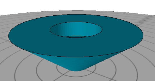

I replaced my SeeMe bar with a threaded rod and bearing loaded hubs ages ago, worked great.
Now, though, as I start to play with Nylon, I'm going to need something that fits in a bucket with room for the desiccant sachets.
And here it is. The base (upside down), bit of threaded rod (8mm or 5/16) goes through the guts with a lock nut after tapping the appropriate thread. The cones hold the spool, with a rollerskate bearing in the cup you can see. Don't print it this way around, I just flipped it to show the bearing pocket. And because I never trust a 3d render on the parts databases, a photo of the real thing. Yes, it looks rough. 0.5mm layers on a 0.6mm nozzle of ABS at 260º ain't pretty. But it holds the wait and it printed a large part quickly. This was designed to go with the SeeMe, Amazon and DoodadDoes spools. The spool in the photo is just a reel of local hardware sourced weed whacker line.
So far, working well - we're in the midst of kitchen renovations at the moment so I have no oven to use to dry the Amazon Blue out. I have noticed that running the spools flat like this makes them a little more likely to jam, something to keep an eye on.
