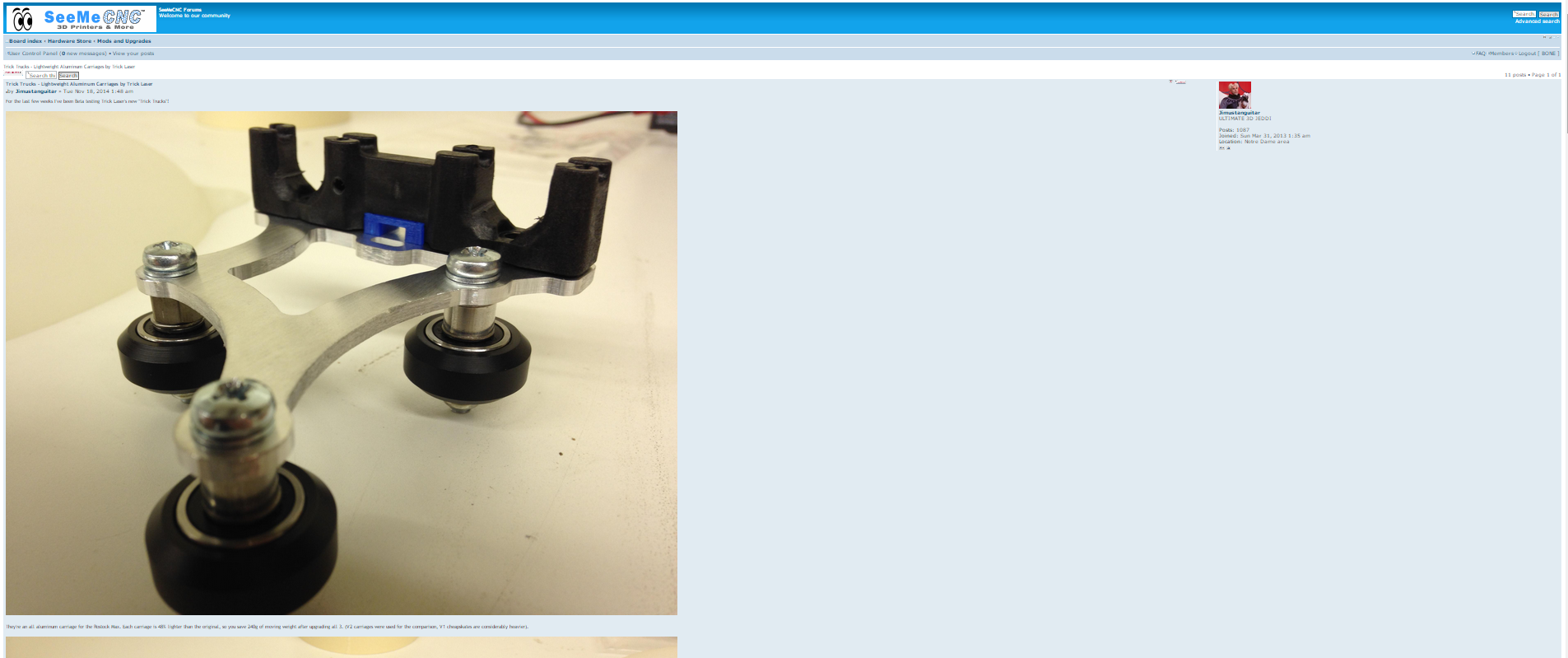

For the last few weeks I've been Beta testing Trick Laser's new "Trick Trucks"!
[img]http://i.imgur.com/9t5gNND.jpg[/img]
They're an all aluminum carriage for the Rostock Max. Each carriage is 48% lighter than the original, so you save 240g of moving weight after upgrading all 3. (V2 carriages were used for the comparison, V1 cheapskates are considerably heavier).
[img]http://i.imgur.com/HwzywPx.jpg[/img]
They use the dual-bearing Open Builds V Wheels ( http://openbuildspartstore.com/openbuil ... wheel-kit/ ) with 30mm axles, Open Builds eccentric adjusters, they reuse your existing arm mount and hardware, and use a new style belt clamp that I designed specifically for this application ( http://repables.com/r/424/ ).
[img]http://i.imgur.com/Wr2Qn30.jpg[/img][img]http://i.imgur.com/6xqpyWH.jpg[/img]
They're as smooth as glass, I like the weight savings, and I really like having a single eccentric nut to adjust the rolling tension. I'm quite happy with them. Here is the full album of my pictures ( http://imgur.com/a/1CroL )

They look sweet and I like the design. But how do you adjust the fit of the wheels to the extrusion? Or is it being done with tolerances?
							The BONE ZONE build thread.
Re: Trick Trucks - Lightweight Aluminum Carriages by Trick L
The eccentrics that I mentioned. Here's the link:BONE wrote:They look sweet and I like the design. But how do you adjust the fit of the wheels to the extrusion? Or is it being done with tolerances?
http://openbuildspartstore.com/eccentric-spacers/

Do these change the delta geometry at all? They look like they would make the carriage axles loser to the extrusions?
My horizontal radius needed to be increased by 4.05mm.

That is way cool! How do you attach those carriages to the belt?
BTW anyone on Firefox can right-click and "View Image" if the pics are cut off like mine were.
Bone, it looks like you're navigating the mobile web page... Weird.
Ben, the little blue tabs are the belt clamps. They friction fit on the bottom of the arm mount and squeeze the belt between it and the aluminum when you tighten the arm mount screws.

Would you mind elaborating a bit on the blue elastic band with hooks?
Is that a permanent installation in place as some sort of counterweight or a temporary installation?
its for the hanging ezstruder, shorter bowden tubeteoman wrote:Would you mind elaborating a bit on the blue elastic band with hooks?

Hey all,
Thanks for your interest in the "Trick Trucks" the design is similar to the 3 wheel dual bearing trucks I designed for the NEMESIS Air Delta printer project. ( http://forum.seemecnc.com/viewtopic.php ... it=NEMESIS ) They work so incredibly well I wanted some for my MAX & Orion and thought others may also.
I am planning on having them available to ship the 2nd week of November.
I just put them up on our website http://www.tricklaser.com/Trick-Trucks- ... TRUCKS.htm
If you Pre-order you will save $10.00
