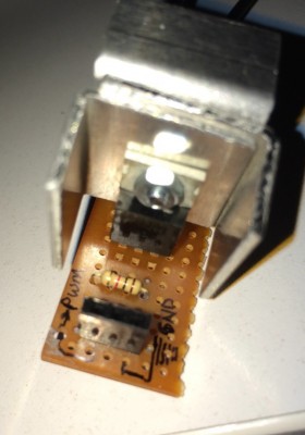

From now on i shall be using the heated bed with 24V exclusively. So i did not remove the whole connector assembly, or make any preparations to install high amperage wire. Instead I installed a JST connector on to it. I will be using the PWM output only as a signal for my SSR (or poor man's SSR).
As recommended by other people on the forum, i had ordered some FOTEK 40A SSR's. However I was in a hurry to finish some parts for my good friend Mokk. When he heard of my misfortune he conjured up the poor man's SSR. He built it and sent it, the next day it was in my possession.

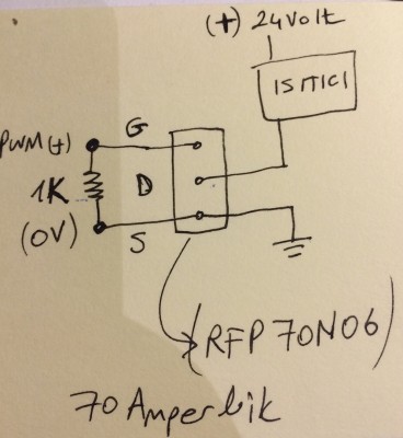

Isitici = heater
Isitici = heater
It is based on a mosfet rated for 70A.
Mosfet
Mosfet
Mosfet complete
Mosfet complete

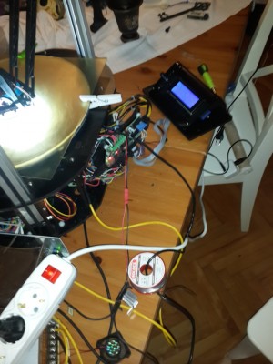

Today i had time, and I installed the 24V power supply and the Mosfet circuit on my printer. I soldered some extension wires to the existing ones coming from the heated bed. I will upgrade those to 8AWG silicone wires when they arrive.
Printer with guts out.
It seems to be working fine so far. Very happy with the result.
Constructive criticism welcome.

That heat sink must get super hot. At about 20C/W and 25A it will be almost 200C, well beyond the rating of the MOSFET. I don't know what kind of connector that is but it probably can't do those currents either. With those dinky wires it's probably not 25A yet but if your supply can do it, it will be when you put in the 8AWG.

The mosfet does get hot, but i have a fan blowing on it. While in operation it is cold to the touch. While heating the bed, it does get warm but nothing you could not hold on your had for extended periods of time. (Without the fan it is impossible to hold).

Ok, with a fan the heat sink C/W will be much less (forced convection). But if the fan fails then it could start on fire, something to consider. Still I would do something about that connector. Also make sure the RAMBo is using 12V for that output, otherwise you'll be violating the 20V Vgs of the MOSFET.

The red and black wires soldered on to the rambo go to trigger the mosfet so no real current there and they are still powered by the Rambo's internal mosfet so 12V.

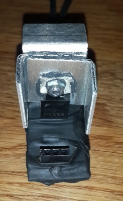

I got some fake SSR's and they did not last at all.
This module also failed in the end (and it failed in the closed circuit position). But while it worked it did perform better than the fake SSRs.
I will be rebuilding this again with 3 mosfets in parallel attached to a proper heatsink and good wiring.

I have acquired a big heatsink and 2 mossfets in parallel, if all goes well i should build v2 tonight.
I will be designing it so it is ventilated by the 24v psu fan exhaust and it will reside on a glass shelf.

I just completed V2 and i must say it is a massive improvement. The previous one was always intended to be temporary to be replaced once i got my ssrs which turned out to be crap.
The old one would heat up to the point of being untouchable. V2 only gets slightly warm. I should still tidy up the wires going to the bed at some point.
The heatsink was intended for a fotek SSR. And the screws to hold down the mossfets were salvaged off the crap ssrs.
The heatsink:
