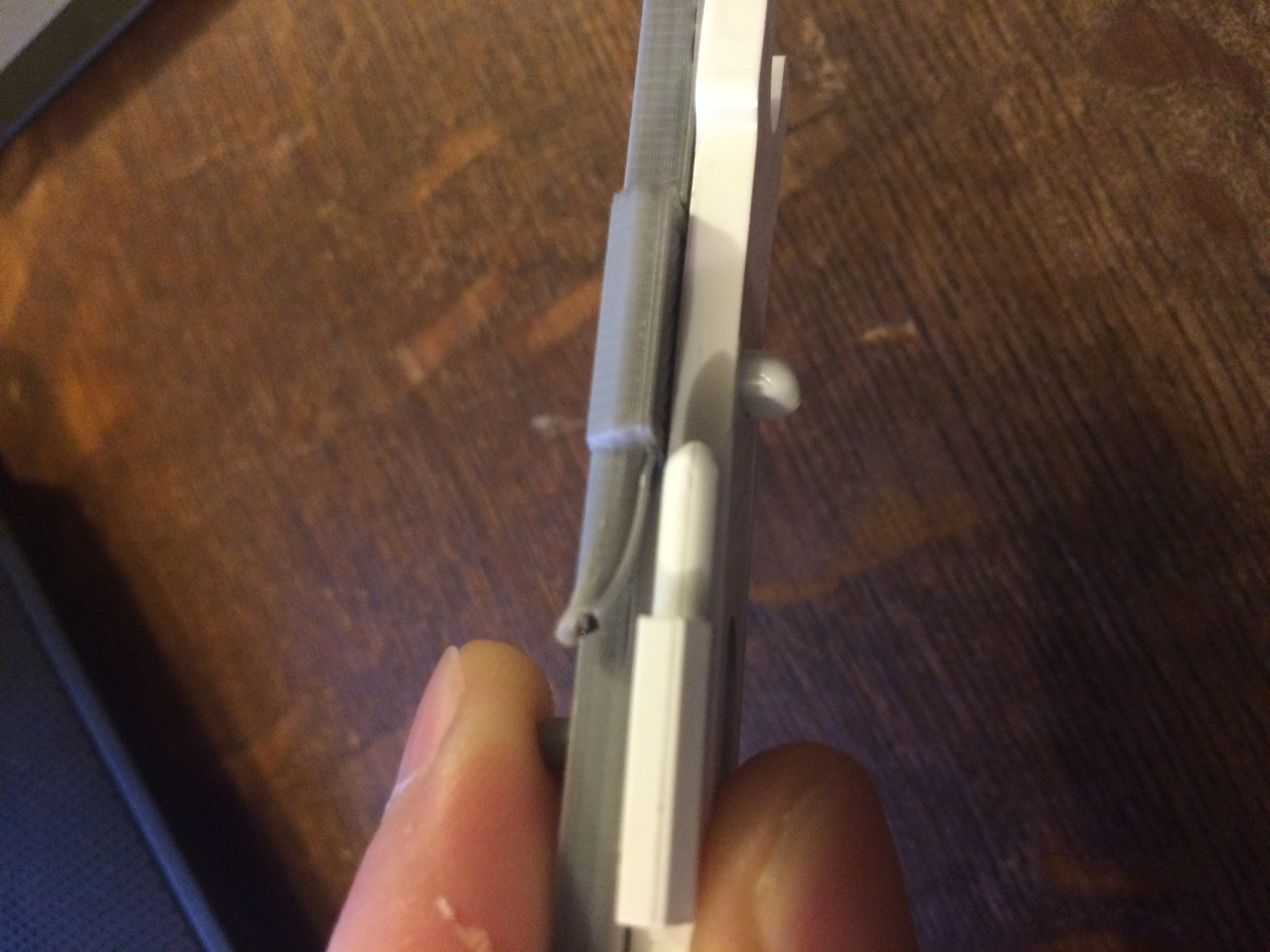

Good News, everyone! My 3D printer has already saved me at least $100. All of the tilt tabs on our windows have been broken for years and we haven't bothered to replace them, but I have modeled them, even made them better, and now I can print them all out for orders of magnitude less! The pin doesn't come out perfect, but it still works for the most part. It's just a spring guide anyways. Probably needs to be printed with support material. I have it set to print overhangs at 10mm/s and I print these at 30% speed so I know it is printing it slow enough, ~3mm/s!
Here are the tops of them.
Here are the bottoms of them.
The not so good-looking pin.
Still works though!
Still works though!
I still don't understand why that top layer can look solid, but the bottom layer has to look like stroodley. I know you guys said that was the result of the Slicer, but if it can do it on top why not the bottom?

I don't really understand what those window things do that you printed, but they look frickin' cool!

They are tilt tabs. The windows tilt inwards to be cleaned and these keep the windows from falling into the house when they are not pulled back. We've been shoving things between the window and the jam to keep them from falling in lol. Not only is it awesome I can fix them for a fraction of the cost, but I noticed the originals weren't exactly long enough, so a quick tweak in Inventor and I have cheap, superior replacements!
