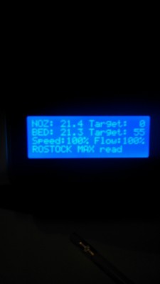

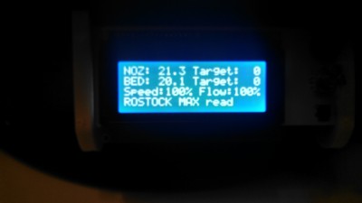

Okay,
Sorry for the gap in communications, but I am just now able to spend some time with the printer again. I am going to attach 3 pictures showing:
1.) What the Printer LCD indicates at start up
Rostock at startup
Rostock at startup
2.) The bed with a command to heat up to 55 degree's. (LCD)
Bed heat command of 55 Degree's

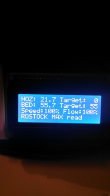

3.) The bed reaching and maintaining the 55 degree set-point. (LCD)
Bed reached/maintaining 55 degree's
I had a thought today. I am going to try and swap the hot end leads from the Extruder 1 terminals to the Extruder 0 terminals and see what that does. I was poking through the manual controls mounted on the printer and saw that Extruder 0 is the only one that is displayed under the "Adjust Temps" section. I am wondering if this may be the problem? Possibly being caused by a conflict between Firmware settings and real-world configurations? (I know CNC machines do not like these differences). However this raises another question of why would Extruder 1 be outputting power if Extruder 0 is selected in the firmware? Do they both output power at the same time?
I know, I have a lot more questions then I do answers and I apologize for that.
Thank you all again for your help.
Re: Ok need some serious help
Posted: Mon Dec 15, 2014 9:29 am
by ThatOneGuy
:D :D !!!!!EUREKA!!!!! :D :D
Okay, here is what I did. I swapped the Hot End/Extruder leads from the Extruder 1 Heat terminals to the Extruder 0 Heat terminals and via the Printer controls, (The LCD and knob) went to the Adjust Temp section. Set it to heat at 150 Degree's and the extruder began to heat up. I was rather apprehensive as I watched it climb because it was doing so very quickly. When it hit approx 145-150 degree's the climb began to slow and eventually came to a stop at approx 165.7 degree's. At this point the temp began to lower until reaching the 149.5-150.5 degree's and then stabilized and has been maintaining this temp for about 10 minutes without issue.
Wow, what a relief! It definitely was a wiring issue, but all i had to go on was the Instructor's advice/input so I could not have known this prior to now. Again, thank you all so much for everything! Now I am going to change the configuration.h file to correct the direction of one of my servo's and then begin the process of tuning and printing! Wish me luck! :lol:
