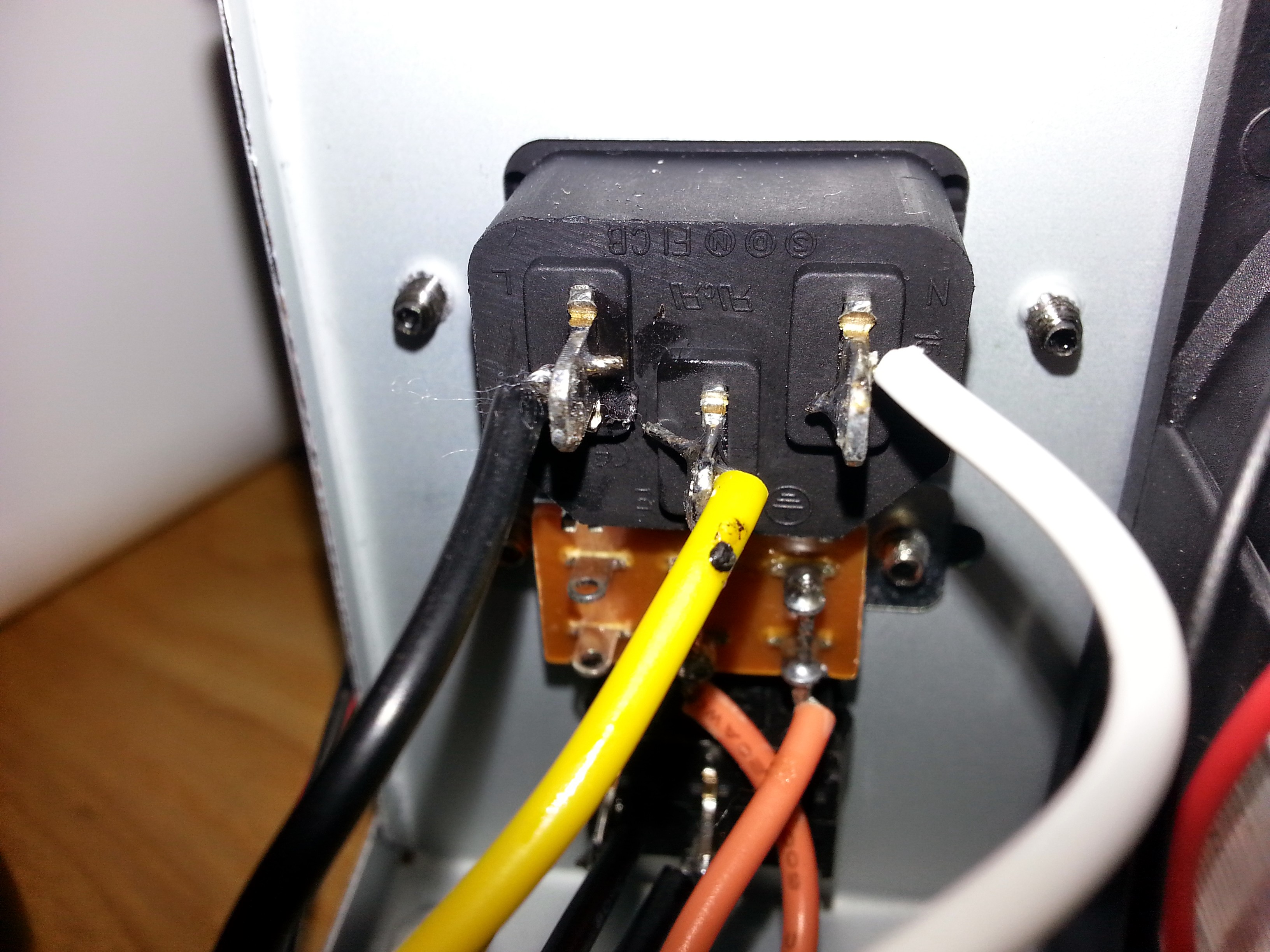

My Max 2 new build was shutting down when I turned on either of the heats. SeeMeCnc said it was a power supply issue and shipped me a new one. I installed it tonight, but now the LCD display comes on for a second then goes dark. The rambo fan and status light are on in that split second.
Any ideas?

Did you create a short circuit when you installed the new psu?

Checked everything & was very careful when installing psu #1 and #2

I opened up the power supply and found some bridging across the ac input contacts. I cleaned this up and separated all the component leads that seemed to be touching. The p/s still will not stay on.
bridging / sloppy soldering

If you cut your main atx connector off be sure that you connect the brown wire to any orange wire. It is needed to prevent the issue I noticed in the 1st line above. JJ at SeeMeCNC alerted me to this and now all is well.
