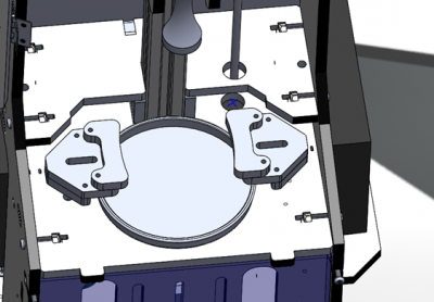

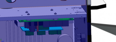

Received this from tech-support;
George,
The picture in the manual needs an update. The Uno is actually set back about almost to the middle of the plate that it mounts onto. You will be able to move the uno around and find the hole pattern that matches on the melamine.
If you do want it closer to the edge, you can certainly drill your own holes.
As per the dish base, when standing in front of the machine looking at it, the hole should be on the right side of the machine. (See attached image)

Here are a couple of pics I received from Tech Support.
Also - the manual references putting 3 cheapskates and 6 R4 bearing bushings - - what you will have in the build kit is 2 solid strips of 4 R4 bearing bushings - these do not come apart - you will have 4 cheapskate bearings on the front side of the carriage plate - and everything lines up perfectly.
- Dish base orientation - Large hole on right.
- New location for Arduino Uno.
