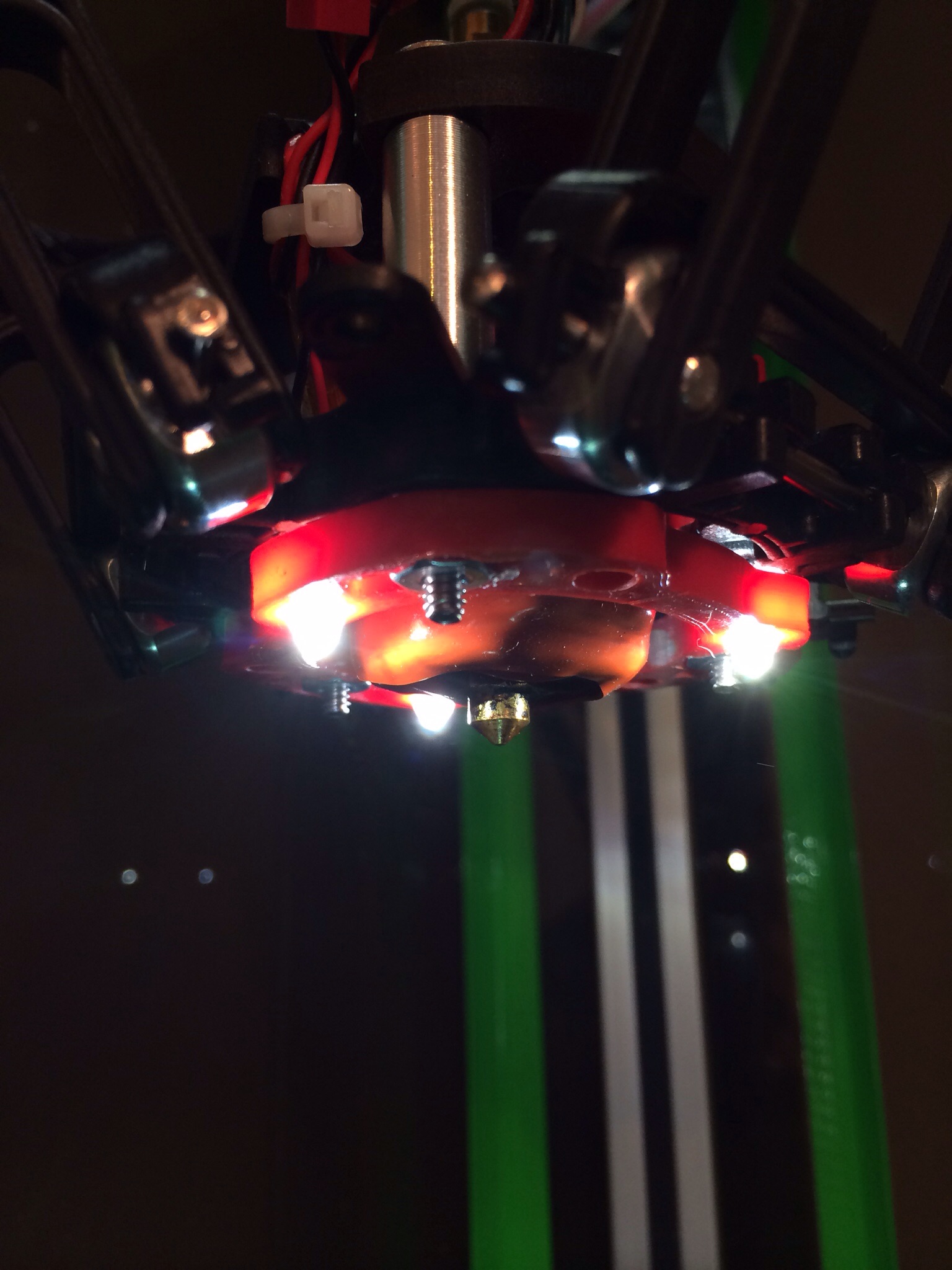

Hello All, I've had nothing but questions lately.. Hoping to be able to contribute soon. If my target temp is 230 the hotend will hover between 224-226 and maybe 227.1 at times. If I set a target temp for 240 the temp will then actually go to 227-229 but not higher. Has anyone had this happen and have recommendations for what I should do to remedy this? It's fine when printing PLA as I only set temp to 200 and no problems at all.. Bed is maintaining consistent temp at 90c. I have a new EVGA 650w power supply.

Easiest fix would be to wrap it in Kapton, if you don't think the power supply is your issue. Or replace your resistors with a ceramic heater insert.

Thanks Eaglezsoar and Bentherighteous, I re wrapped the hot end with about 6 more layers of 1/2 inch Kapton tape and the difference is night and day! I really can't believe that it made that much of a difference. The first time I re wrapped, the Kapton fell off due to an insufficient wrapping job, the temp then went down again and wouldn't stay at target. I re wrapped again and all is good so far...

I had this same issue. The version of the manual I built from didn't mention the tape. Wrapping the hot end with tape fixed things.

I used some high temp silicone tape, in the Air Force we called it F4 tape. It also keeps the heat away from the led ring.
Remember to re cal your hot end after adding any tape to it.
