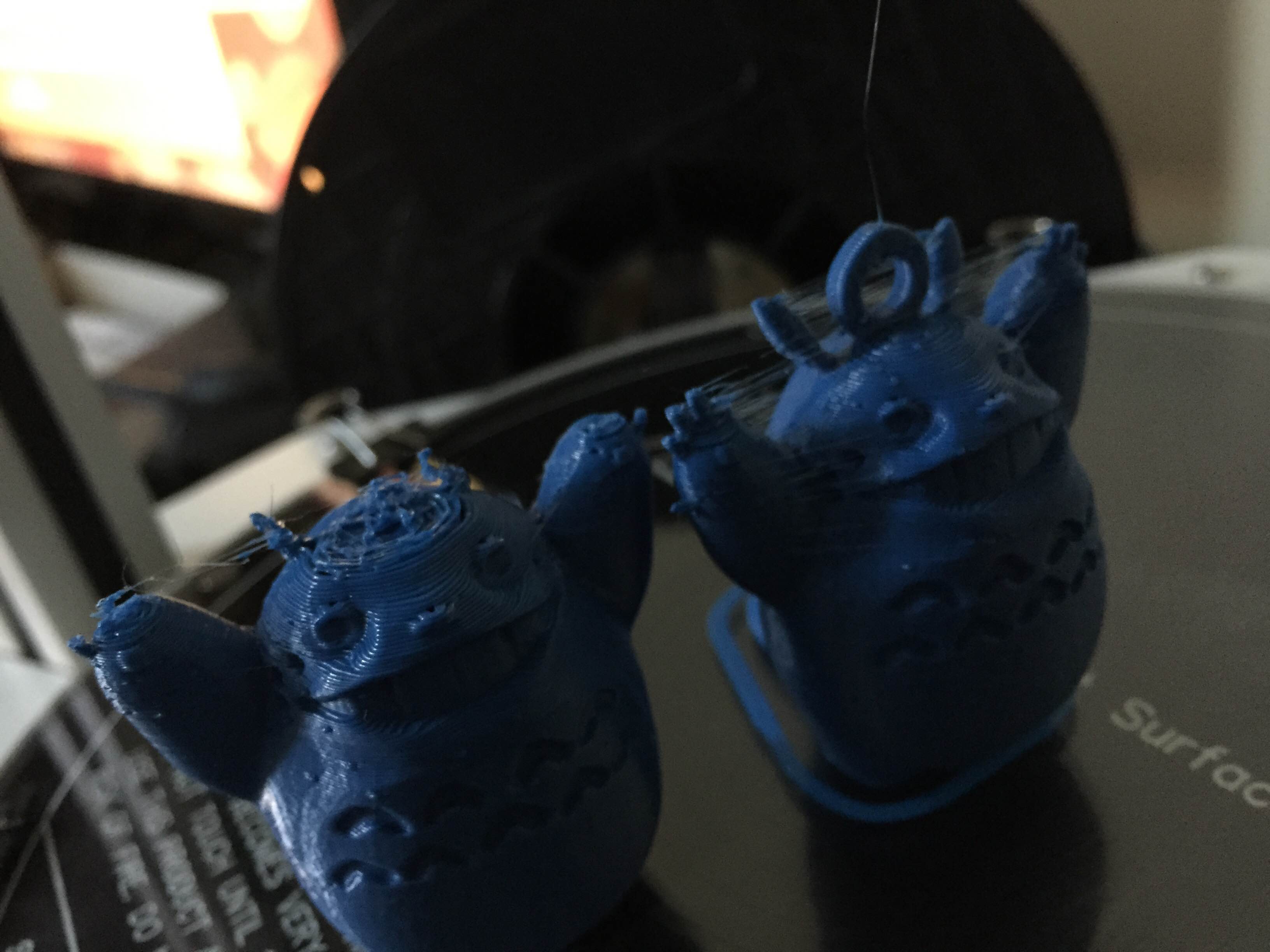

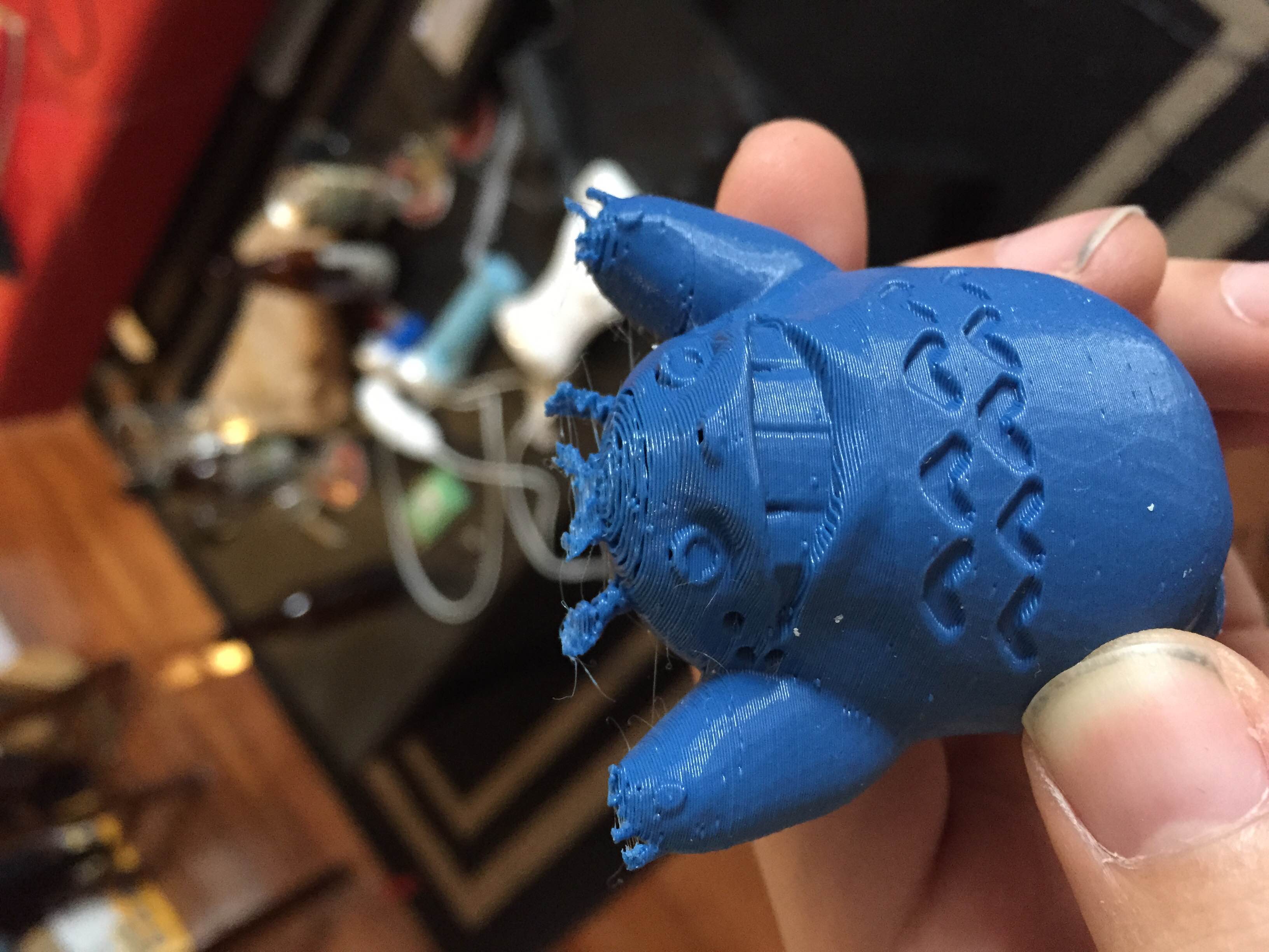

So I may have been wrong about my issues. It's not about print time but more about WHAT I'm printing. At any stage where it has to extrude for a fine detail, retract, move, then extrude again that is where the filament stops moving forward and the gears just appear to turn. Here's an image of what I mean. The print moves fine until the printer is working on the top of the head and the top of the hands then it just gets worse until it is air printing. If I let it run for too long after this I can expect to find the filament snapped so maybe it is just grinding it in place or maybe it is retracting too much and just going over the same part of the filament with the gears? I'm not quite sure what to do any any help would be appreciated.
For what it's worth my stepper motor feels almost too hot to touch but the filament inside seems ground not melted.

What you're probably getting is filament grinding. That amount of retraction doesn't help either. The large amounts of quick retracts repeatedly over the same length of filament can grind it down.

lower your retraction length to 3mm for starters.

The retraction seems to have worked like a charm! I have more spiderwebbing but that is an acceptable outcome compared to full failure.

Also try increasing the minimum extrusion before retract. (In cura, I forget if slic3r has it). The default .01mm can allow a lot of retracts in a short time, even with minimum 3mm travel distance.
