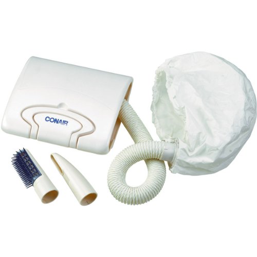

One idea to try for heating the air inside is a bonnet dryer instead of a space heater. It provides warm forced air through a hose that should be easily attached. Add a thermostat to turn it on and off.

That is a very interesting idea. I wonder what kind of air volume it pushes. lots of bad reviews on that particular one!
