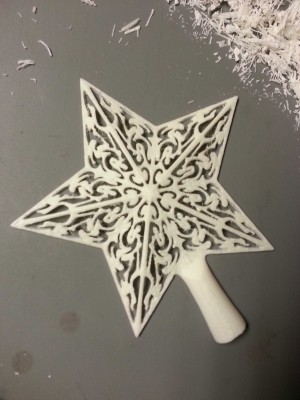

This is one half after support removal.
Here is the link to the star: http://www.thingiverse.com/thing:583200/#files
I cut it in two in NetFabb and printed two halves with support.
Octave White ABS, 235/80 temps, KISSlicer

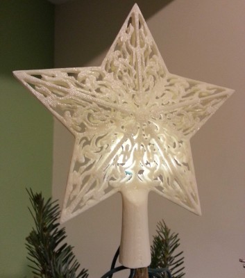

Beautiful! I unfortunately haven't had time to get my Rostock build completed before Christmas, but next year...
