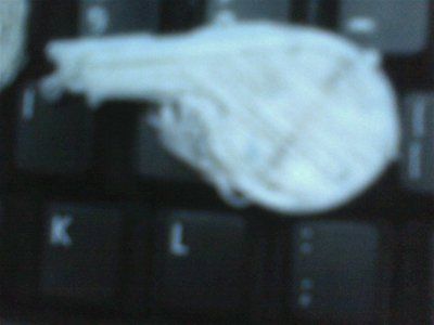

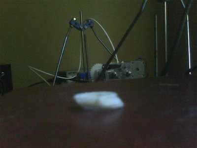

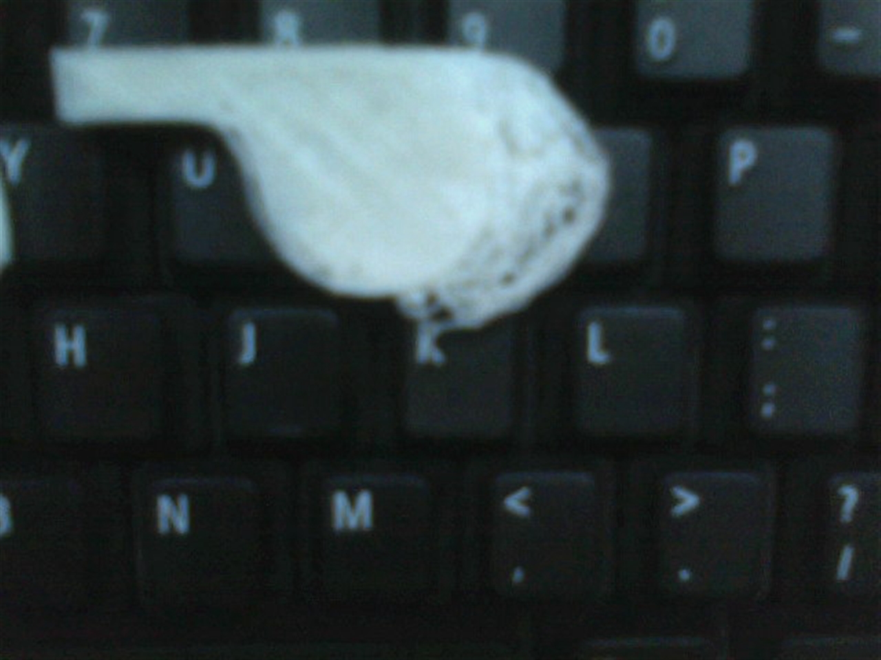

Idk whats going on but with the optos jumped the skew goes one way, with out them jumped they go the other way .I didn;t print the one with the jumped optos for long after i started to see it skewed. ANy ideas ? I've run out. My belts are all tightend that it was hard to get the belts back on. so its not that, i noticed that there is some wiggle on the extruder carriage, the screws to tighten the bearings are tightend as much as possible.

It looks like jumping the optos did something positive. Before worrying about the electrical stuff more, I'd double check the mechanical movement. If you disconnect the belts, everything should glide smoothly (without any vibration) when nudged by hand. Also, belts should not be so tight that they load the frame.

I had alot of issue with printer skew when I first built my printer, and the whole issue turned out to be the old computer I was using. Just to rule that being a possibility I would try running the printer from another computer. From your pictures thou it doesn't look like the issue is skew. Try printing a calibration cube. They have several of them over at thingiverse. If its skew , each layer will slightly be offset and the whole thing will be tilted. Pictures arent very clear thou

Also as kilroyo said, your pics are not too good. Post clearer pictures and we can better help determine what maybe wrong.

Some better pics would be helpful.

Dude, I can't tell what that is. Try focusing on the object, the background is clear but the object itself is blurry.

sorry, used a webcam, ill try again on the picture, the extruder kinda jiggles when it moves

When I had skew like that it was because my travel speed was too high and the motors were skipping when travelling.
