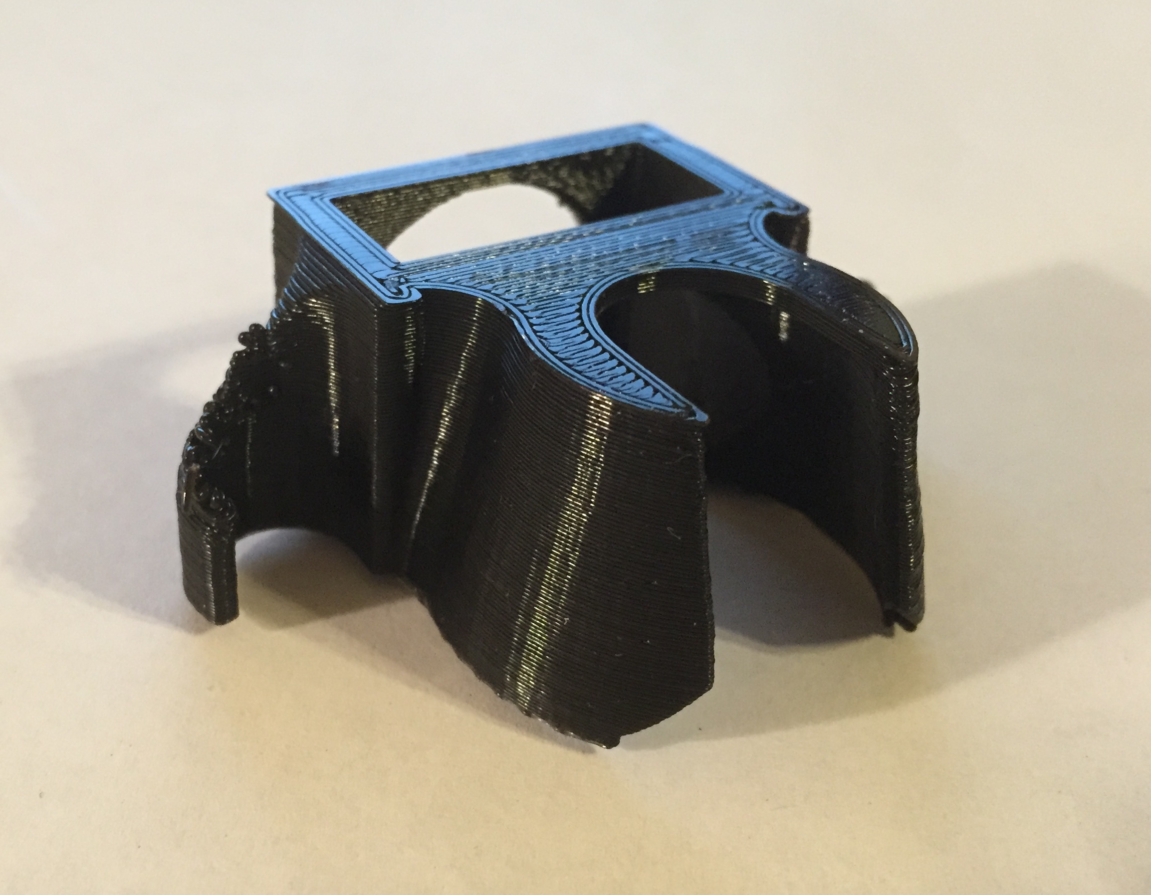

I tried printing the fan shroud in PLA since that's all I have. turned out pretty well except there was a kink in the filament that I didn't see till there were already a few layers of air. I think it was pretty close to being done though. The part looks very usable and is 20mm tall. Just some slop on the overhangs.
