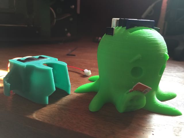

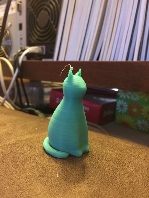

I've done a few prints so far and I feel like they came out really well first my first two days of printing. I've noticed little bumps in the layers which i've seen before. What's common cause of these? Is there a page with common print issues for the rostock? ie: printer issue/filament issue/computer issue etc.
Here are my last few prints:
It's kinda hard to tell but on the octopus there are some little bumps. The cat has some little indents. It's hard to tell if there is a patten to them though like one of my arms ejector pins is rubbing at specific point. Would that cause this? or is it more hot end filament related?

Your posted prints do not look that bad. The little bumps usually occur because of some retractions.
Try setting you retraction speed and length.
