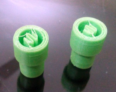

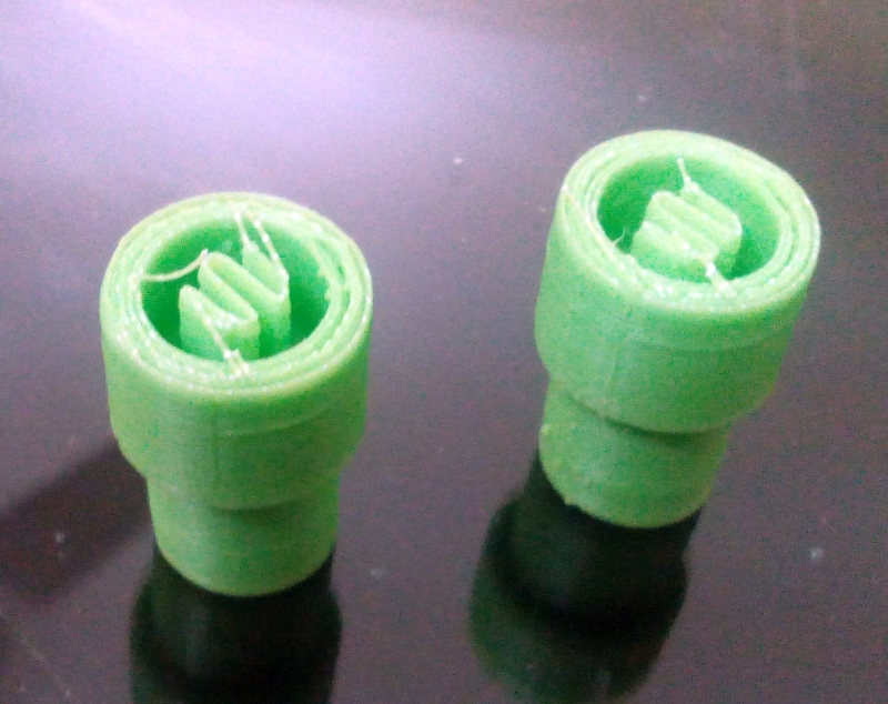

Oh my God..i always touch the filaments with bare hands.... Now your good write up helped me to avoid this habit..i shall try to get acetone cleaning of the bed prior to print..Thanks for taking the time and guidance... :)... I will be much happy if you can share your knowledge about blobs on the print...i am going to resolve this but it will take a longer time..if you have any tips?...

Careful with acetone, it is very flammable and is toxic so handle it carefully. I prefer isopropyl alcohol for the convenience of the wipes and maybe a bit better safety.
For blobs, see the previous tips. Profile your filament to use the lowest temp, go SLOW. There are some other more specific anti-blob strategies but I don't want to get on my "nozzle length" soap box - yet!

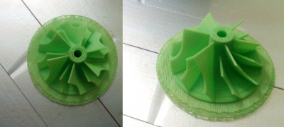

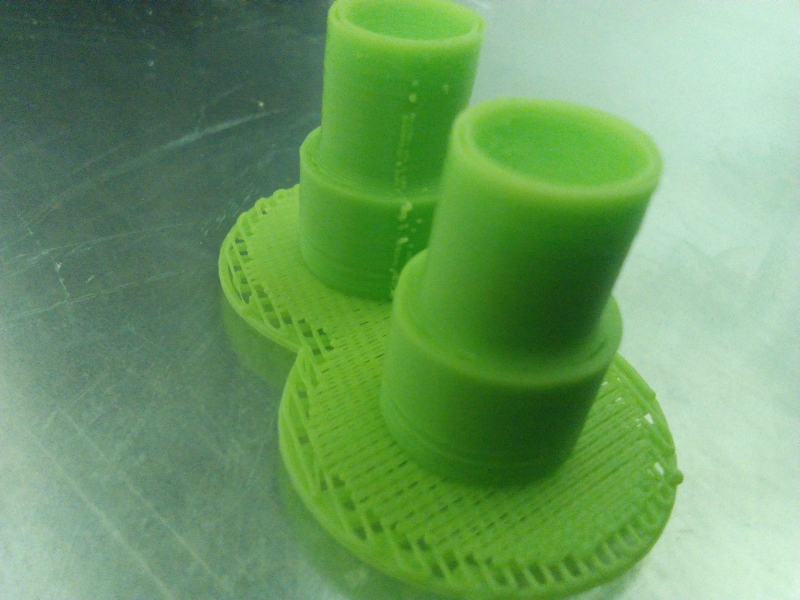

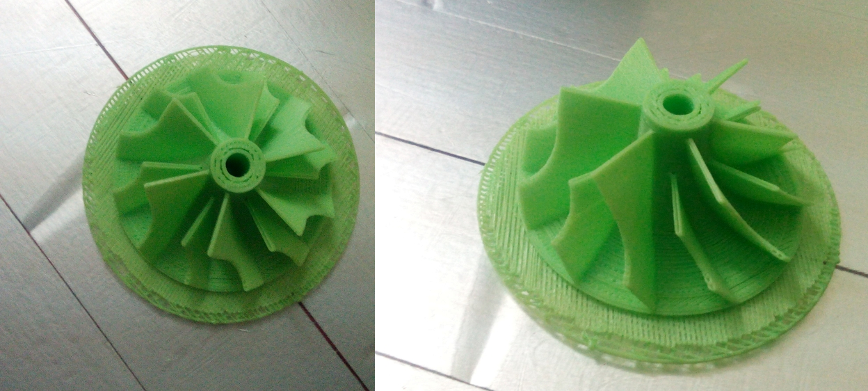

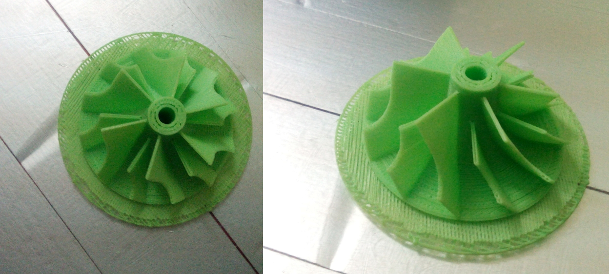

I got the blobs then i reduced the Extrusion multiplier from 1.2 to 0.85..all blob gone...i am not using Fan for cooling PLA...here is my latest print...just followed the tips by mhackney...
